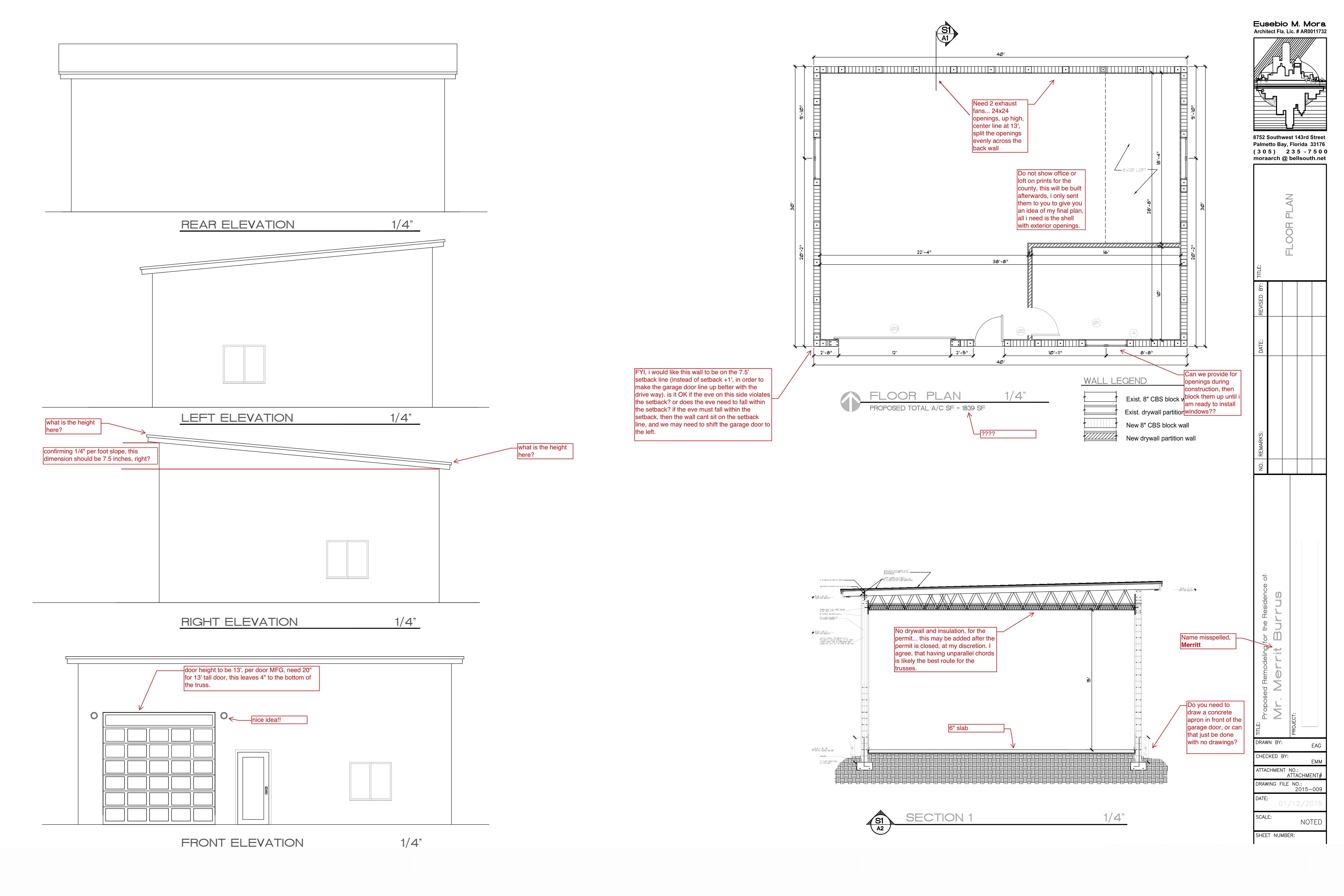

OK! got some prelim drawings from my architect... i made comments back to him in red...
what do you all think? comments on layout, windows, doors etc?
also got a quote for the rolling door...
FURNISH AND INSTALL:ROLL UP DOOR: MODEL HV-1665 • GALVANIZED SLATS (WHITE OR GALVANIZEDFINISH: GAUGE 22) • GALVANIZED HOOD • STEEL ANGLE TRACKS • TORSION SPRING• +/-65 P.S.F.(150 MPH) • STATE OF FLORIDA PRODUCT APPROVED FOR HIGHVELOCITY HURRICANE ZONE: APPROVAL NO.: FL 14444.2 • MOTOR OPERATION
DIMENSIONS AS FOLLOW:12' WIDE X 13' HIGH,
1/2 HP MOTOR OPERATOR (OMH): 115 V • 60 HZ • 1 PH- INCLUDES (1) PUSH BUTTONN STATION- INCLUDES PHOTOCELLS
total price for door, motor operator and installation is $3,358.09... sound reasonable? this is from rolling-door.com, they are a local company. this is a roll up style door, not a standard residential style door...

I like the layout.
You mentioned a crane, you may want to consider more solid poured cells in the block for anchoring points, or if you are doing a fixed crane on a post, a large footer for future install. Depending on the size of a swing crane, at least a 4'X4'X 4' footer is needed.
I think you should go with the windows while building,as going back and breaking the blocked up areas would be more work than it's worth later. You could put the the windows up higher in the shop area for security.
On the future office window you could incorporate security bars inside.
I also like the fans, I live in Ft. Myers and know how much a fan helps.
How hard would it be to add plumbing for a bathroom? They are handy out there. I know Miami- Dade can be tough to permit in, but I will always include a bath room in any shop I build again.
I put windows in my shop and glad I did, the natural light is great.
What kind of roof finish will it be?
I would think there is enough slope for a galvalume PBR sheet metal roof.

I would make the office a bit smaller and the loft a bit larger, ideally align them..
say 12 X 20 for the loft and 12X10 for the office. or 10x20 & 10X10
You could also leave the loft size "as is" but the office is way too big for just one person. and waste floor space for the shop. you could make the office 8x10 and still have room for a desk chair & bookshelf.
This gives you a bit more floor space for the main shop about 30x30. versus the cut up shape you have now.
A window for the office would be nice, for the main shop a few skylights would let in more than enough natural light too.. ideally on a residential lot like this you want the building to match the pallete of the house.. (colors. design elements, etc) otherwise it will look out of place. add some lites to the garage door too.

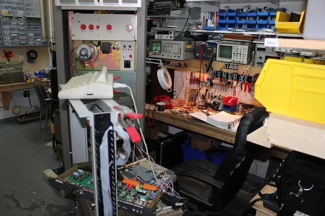

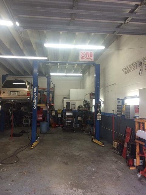

alright i have a few minutes now...
i have a 10x10 and a 10x16 at my current rental shop, and its shared with another person... the 10x10 is mostly storage (clean storage), and the 10x16 is the shop... there is a full length work bench in there and we each have half, but it is very cramped in there, so i want to make sure i have more than enough room for my self... the office may also have a couch/tv, as well as storage and book shelfs...
the shop is likely going to be a very dusty place due to welding and grinding... and my current shop experience shows that everything in the main shop gets covered in dust. my plan is to put machine tools (mill, lathe, drill press, grinders) under the loft... just in front of the loft will likely be a welding/fab table and some work benches... the roof of the office and loft will serve as my storage area... ideally the area in front of the garage would be kept as a vehicle bay...
i will post pics of my current shop setup a bit later on when i get home.
mburrus
Nov 15, 2014
235
Miami, Fl

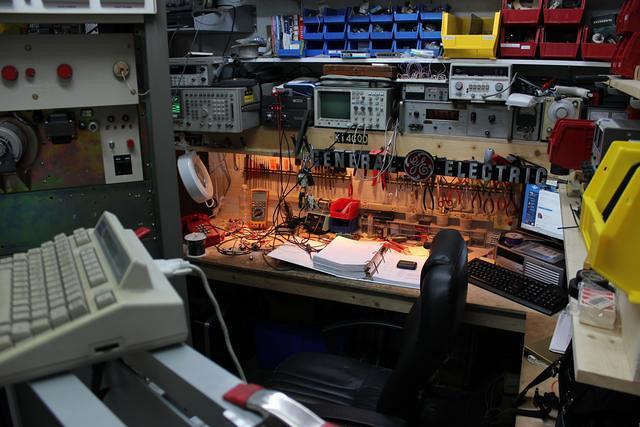

as promised... these are some pictures of my 10x16 "electronics shop" at present... this is when i was working on a large paging transmitter, but its the ony pictures i have for now...
so as you can see, i need the size/room for my electronic work as well...

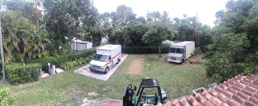

ok update! got my permits!! $878 for building and electrical, and i was allowed to pull my own electrical permit, which is fairly uncommon around here... i had to pass an oral test with a plan reviewer.
see below for a pano of the backyard... the mango tree in the middle will be getting removed... the existing slab to the left will also be removed. thats my forklift in the bottom of the pic...
and lastly, the shop next to my rental shop is closing, and i am getting one of the challenger e10 lifts for $1500. will be in storage until my garage is complete.

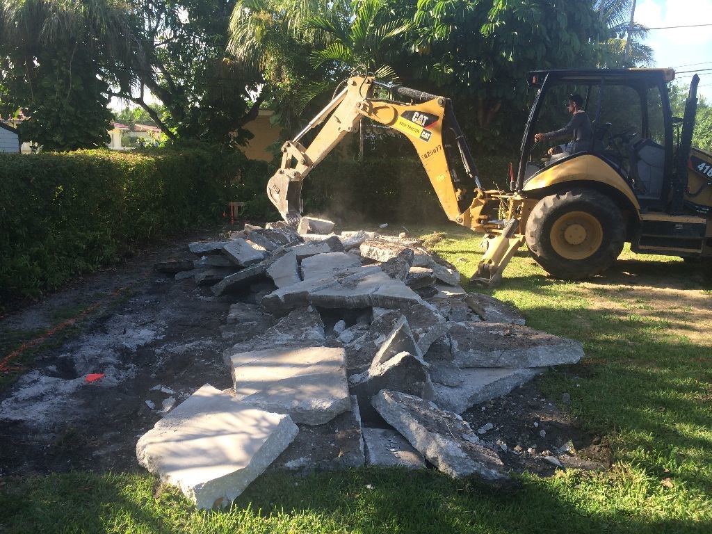

small update: magno tree is gone. got a quote of $1000 to remove existing 36'x14'x6" slab and tree stump, including removal and disposal, same guy will do footer excavation for $300. got quotes of $52500 for the shell including trusses and roof sheathing, no windows, doors, stucco, or paint. got another quote of $36700 for a shell with no roof or trusses... needless to say, high on both fronts. found a block layer that will do $1.25 per block for labor, with an increase of $.25 per unit for every section of scaffold he needs to use. i thought he was extremely fair... got a quote of $1.05 per CBS block delivered for the quantity of block that i need... looks like i may be piecemealing this thing out instead of using one shell contractor. my carpenter advised me that he can/will do all steel work and form work, which leaves me in need of a concrete guy, but so far we are looking pretty good with the independent guys.
mburrus
Nov 15, 2014
235
Miami, Fl

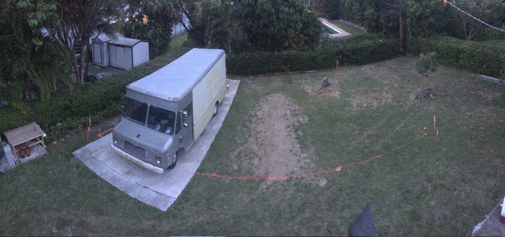

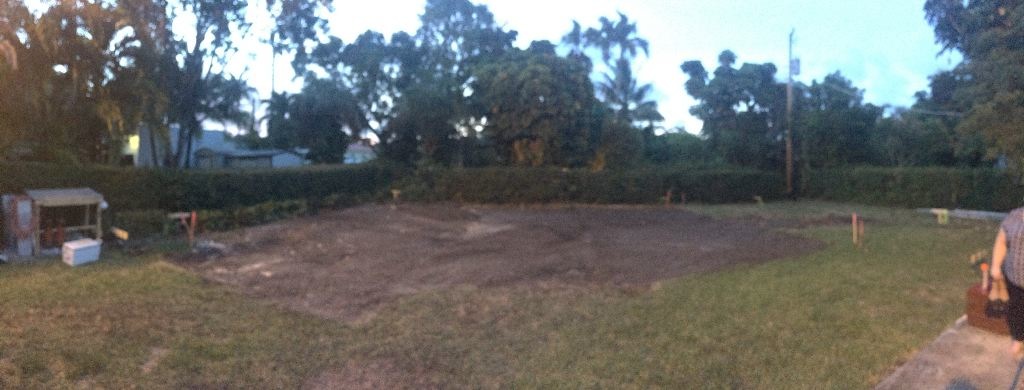

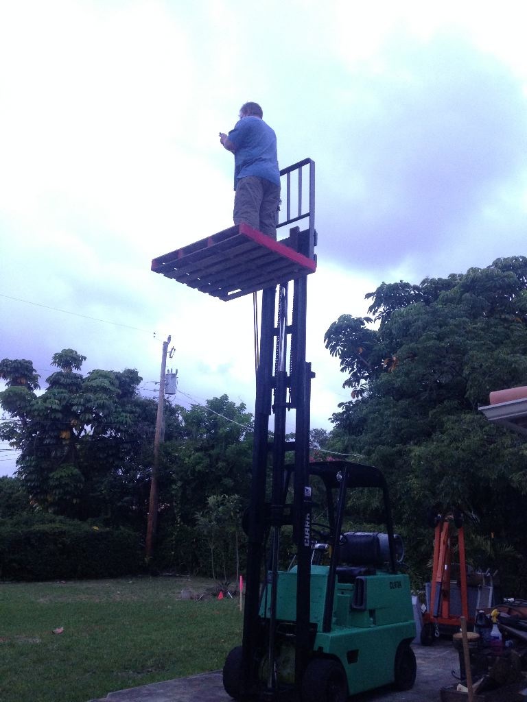

survey/layout is done! orange spray painted line shows the outline of the garage walls. footers get dug next saturday! i do have an issue i didnt realize until the survey was done... architect put the finished floor at 11.67, surrounding grade is between 10.21 and 10.47... thats about a foot and a half difference! i need to see if we can get that reduced somehow so i dont need to build a ramp to get in to the garage!
(photo from the top of my forklift)
mburrus
Nov 15, 2014
235
Miami, Fl

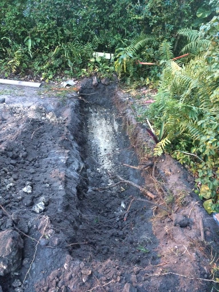

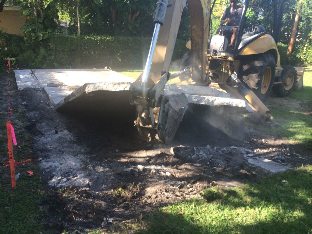

THE GROUND HAS BEEN BROKEN! backhoe came yesterday, removed the existing slab, tree stumps, and top layer of grass. dug a short section of the footer as a test, there is solid coral rock about a foot below the surface. GOOD TIMES!!! excellent conditions for the footer. he comes back today to finish digging the footer.
test footer section
sorry for the bad quality, it was late and my phone was covered in sweat. ITS HOT OUT!

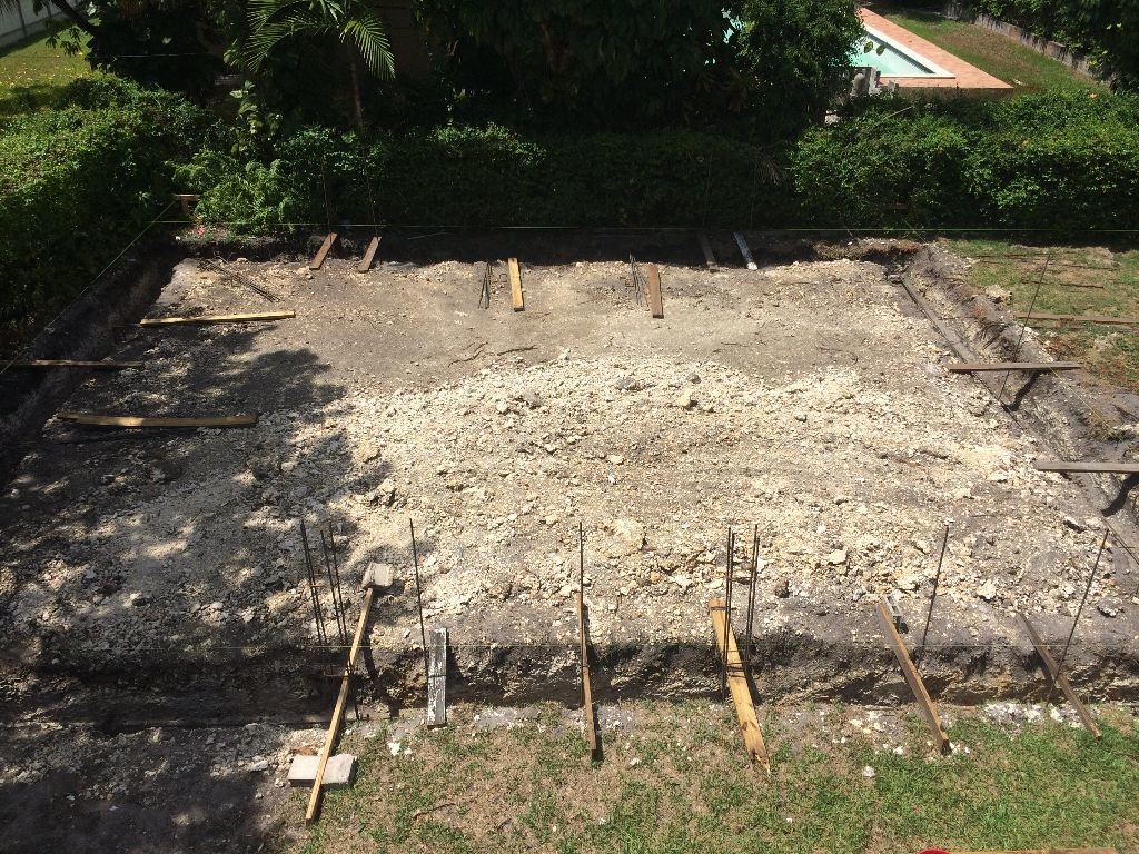

photos to follow when i have time to upload, but footers were dug, steel installed, and footers poured last night. i have 8 cubes of block, mortar and wire coming tomorrow early. got an excellent price on block from a new block company, $0.98 per block. things are progressing well... next step is to have the mason lay 3 courses of block, then prep to pour the slab...

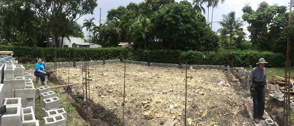

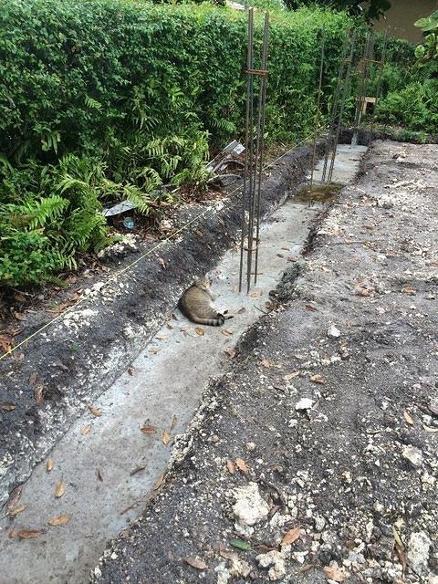

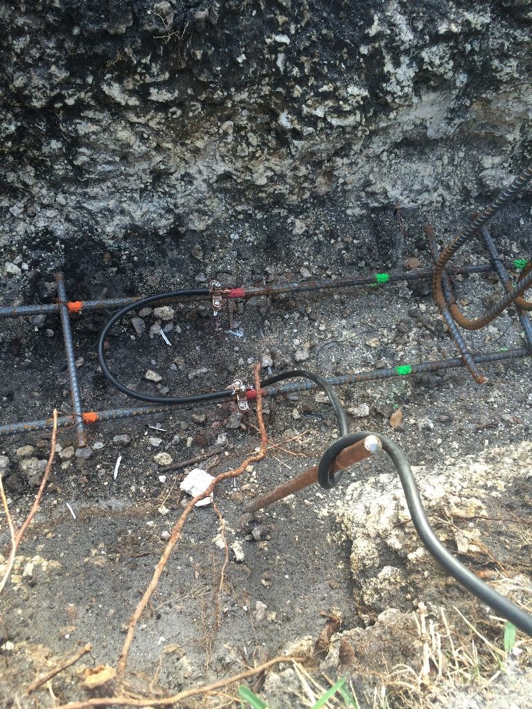

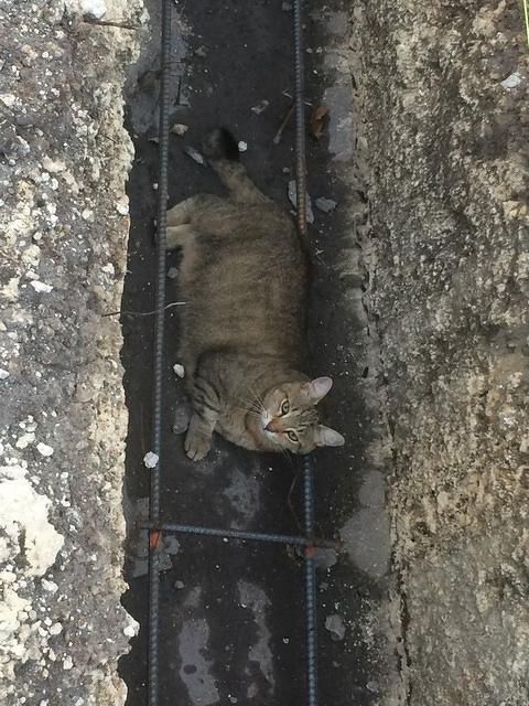

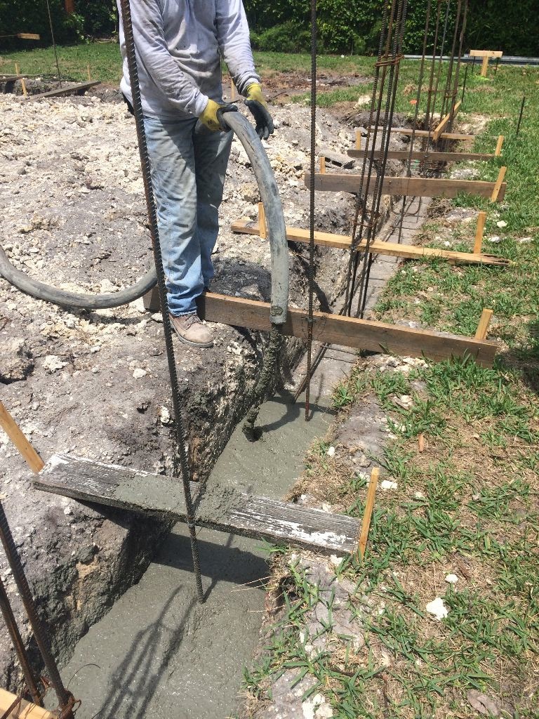

OK!! picture time! the shop is finally "out of the ground", so to speak.
this is the footer, dug, with steel...
#4 copper rebar bond (yes this is a requirement and was inspected!)
footer was approved for the pour by my cat... lol
pouring the footer!
poured footer, approved by miss cleo...
and 3 courses of block went up today! this guy was seriously fast... arrived at 830am, left before 2, all for the price of $325... i staged the blocks for him, but the rest he worked by him self.. it was prety amazing to watch.
next step is to pour the columns to the top of the 3 courses, and begin to prep for the slab...
