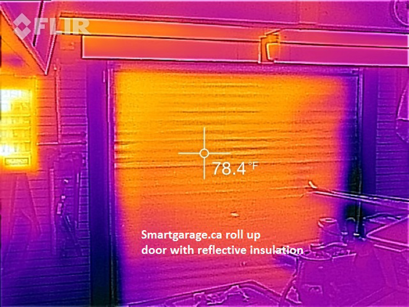

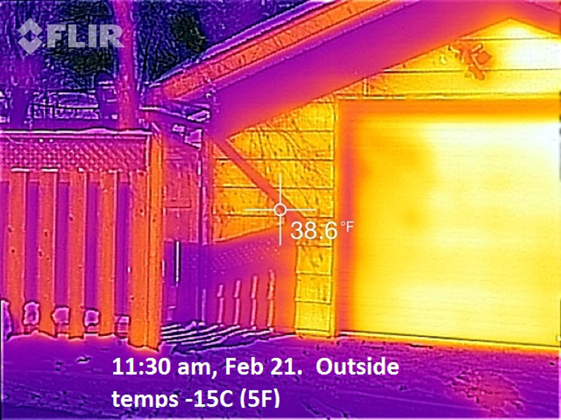

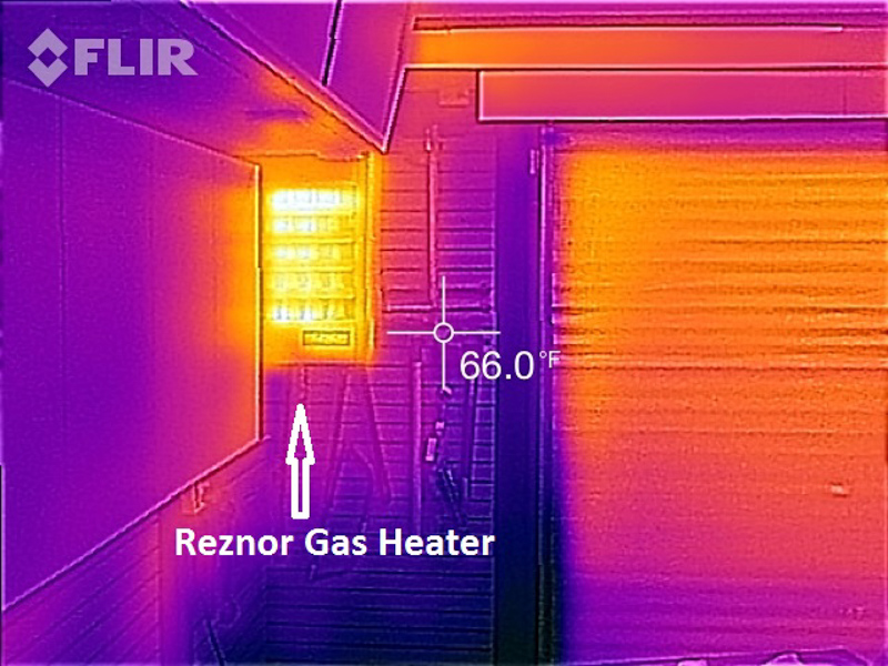

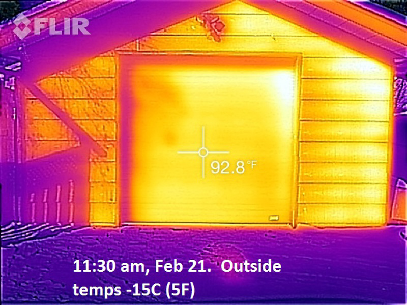

I was doing preparation work for my garage floor seal project today, with heat on higher than usual in the shop, set to 22C. When nearing the roll up door, I noticed a fair bit of radiant heat and wondered how the reflective insulation on the door could be so efficient. Turns out the radiant heat was coming from somewhere else.

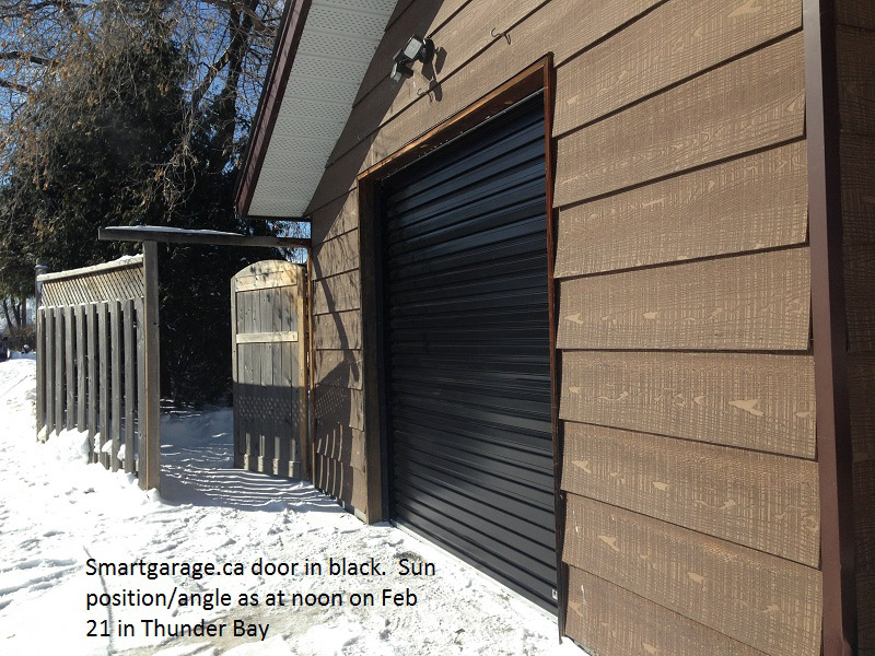

We're a pretty cold climate here, so I ordered the roll up door from smartgarage.ca in black (with self adhesive foam/reflective insulation kit) thinking that maybe I'd see some benefit on cool days from solar gain. The door faces south-east, so for part of the day it sees direct sunlight. I was so impressed with what I observed, I had to pull out the FLIR one and take a few images.
Outside temps right now are -15C, or 5F!
We're right on the 49th parallel:
Temps outside when these images were taken:

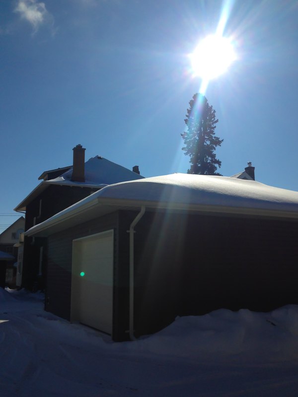

Sun is not so high in the sky here at this time of year:
This gives a good idea of sun angle and azimuth:
FLIR ONE from inside:
FLIR ONE from outside:

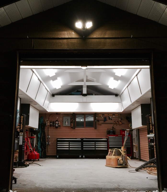

Looking into the shop at night:

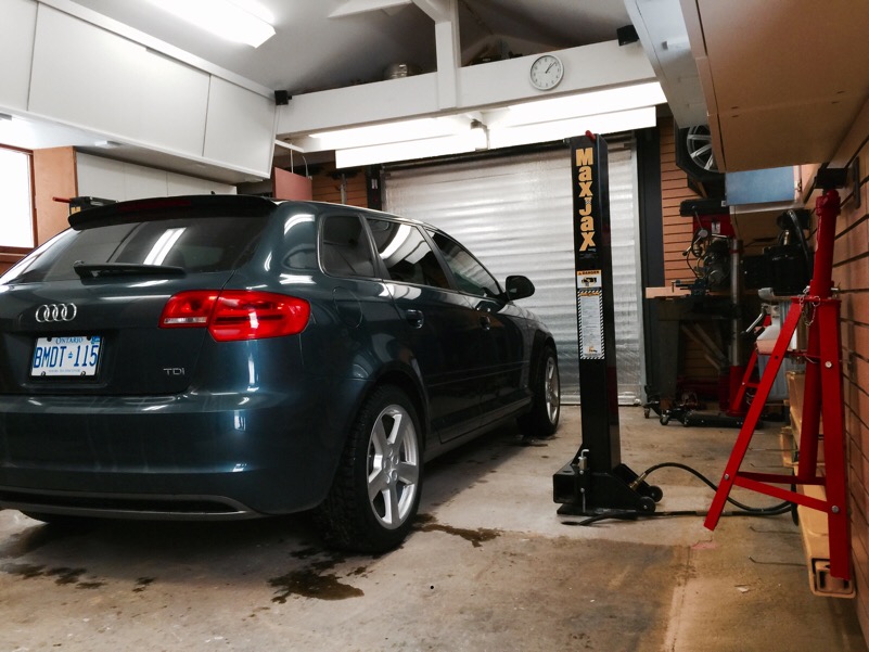

Looking out with door closed:

If your outside FLIR reading was 12* higher than your inside reading, the insulation is keeping heat from coming in. It's not heating your garage as much as it would without the insulation. It probably does keep more heat in without the sun than you would gain from the sun without it.

Yes, there would be a significant net heat loss removing the roll up door insulation as it only sees about 5 hrs of sunshine. The roll up door for at night (it's been -30 here last few nights) represents significant heat loss. I have quite a few FLIR images of the door in my build thread. Overall, a well insulated sectional door (not a roll up like mine) is going to be more efficient.
