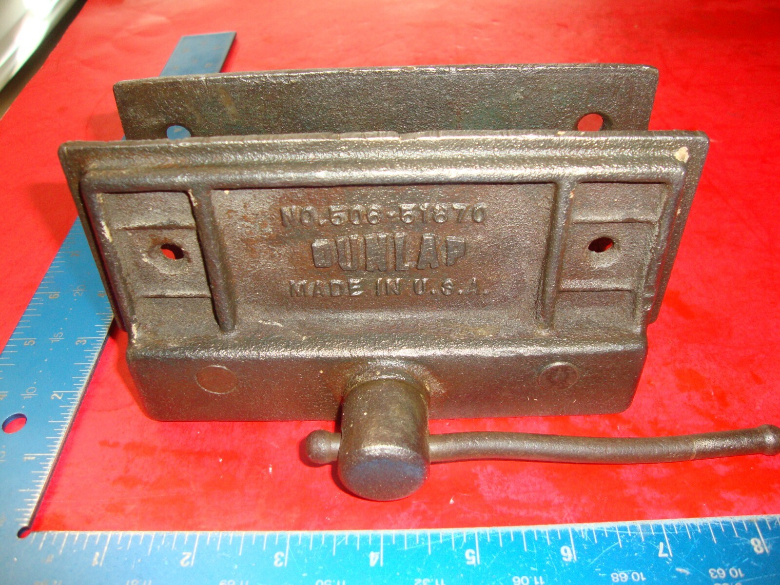

MPOWERD
Jun 7, 2011
578
I don't know much about the history or Columbian Vises but isn't 506 series Craftsman always Columbian? Did they buy out Dunlap or vis-a-versa? Because I keep seeing Craftsman Vises like this 506-51870 with the Dunlap name on it...
txlonghorn1989
Feb 27, 2017
2,786
Dunlap was just a lower tier brand offered by Sears.
13,323
Could be Columbian made for Sears as a Dunlap (2nd brand).
107 when made for Craftsman was supposedly Millers Falls, but could be labeled Dunlap for electric drills and hand planes.
All per the OEM list at Vintagemachinery.org
