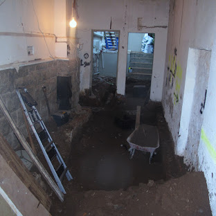

Hey Folks!
been lurking and sniping for a couple years after following the Jack's stupendous efforts in the 12 gauge garage thread, which I found via RennList. Lots more of that level of execution to see here which has kept me busy and scheming.
Nothing like a well executed plan to get you thinking, eh!?
So I've been living here in this 120 year old double storey vic for 20 years and finally got tired of wishing I had a great space to work on my young classics - a 964 and a GTV Alfa - and in part thanks to all your threads and ideas, I'm finally beginning. I thought I'd document the process here partially for me as a journal and for whatever help it may be to others in similar (creaky old) houses. Of course I'm also keen to get some specific input as issues arise so feel free to air your thoughts!
For the most part I'm just remodeling the old carriage house - literally not wide enough for a car if you want to get out of it once you're parked - and putting up a double garage on the front driveway upto the road. The whole erf is 450 sqm as we're in 'downtown' on the side of a 1000m high mountain - pretty but between mountain and sea there's precious little space.
The basic idea:
1. sketch the concept
2. get approval from very sticky Heritage & Residents association
3. draw formal concepts
4. repeat step 2
5. draw architectural plans and submit to Town Council
6. adjust per 'instruction'
7. put out tenders for various bits of the job and find a builder - I'll be project managing
8. break ground and start getting the old stuff out the way ... without damaging foundations etc...
So I'm now at step 8 and over the next couple days I'll post the pics and sketches and plan that go me to this point.
Here are my first pic of today's breaking ground and the basic idea.

theoldwizard1
Feb 22, 2011
43,351
SE MI
Big drop on the floor ! I assume you already checked the depth of the foundation and there won't be any issues ?

good question Wizard - one I'm pondering with the engineer in the morning ...
the roof is going up 60cm and floor is dropping 40cm to give me the extra 1m (didnt explain that before!)
That's what you can see in the first pic & 3rd pic ie the first 20cm down.
The interesting thing about these old places in the colonies is that there wasn't really much concrete available - it was super expensive then and only used in the stone foundations and a little below - the walls are all clay (unbaked) brick with clay cement between them!
The plaster was strong and thick and helped retain the walls but there is very little concrete in them.
I'm looking for the main sewage line below the carriage house floor .. it shd be about 1.2m down and made of porcelain - while we're in there I'm replacing that with duro-pipe (plastic) and the cast iron (likely all very rusty by now) can be replaced too. That's why there is a 1m wide section where I've taken the screed and underlying brick out completely so I can have a wide enough space to locate the pipe. Not sure what we do then but likely will replace the 3cm screed and 15cm brick with 25cm of concrete as a 'retainer' of sorts.
Sound reasonable? Will get pro input tomorrow am.

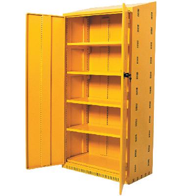

good news is I found 4 of these on an auction yesterday
will think about color as I can get them re-powder coated cheaply
but these definitely pop as is!
1.8m high by 90c wide and 50cm deep - so 4 of them are 3.6m wide
and will make a great wall filler in the flat garage ie in front of the car on that side.
The SUV is 4.4m and the garage is 6.6m deep so enough space to park and open the cupboard doors or walk in front of the car ... a bit tight but workable.
the roof is going up 60cm and floor is dropping 40cm to give me the extra 1m.
Some houses around here, had basements dug after the house was built. I don't know if this was "engineered", but the "classic" solution was to step in about 1m and dig down. Obviously, this would not work for sandy/loose soil. A new foundation and reinforced concrete wall was poured. Admittedly they were going down about 1.5-2.0 meter.
H
HiWind
Mar 23, 2013
188
South Africa

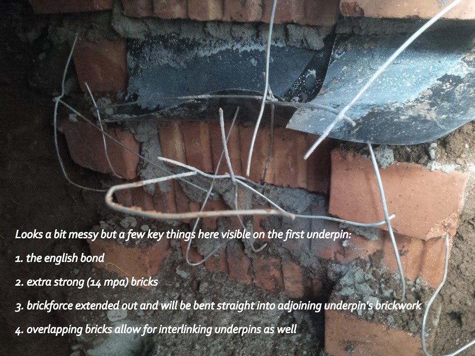

Yes T.O.W.1 ... that is spot on what the Eng suggested - thanks again for chiming in!
So he said dig down the 80cm we need to lower the floor level (and reach the old cast iron pipe) and provide a floor at 60cm below current but do that in 1.2m slots along the house wall.
Then dig a 25cm gap directly below the wall and fill with high grade cement with reinforcing bars
laid parrallel to the wall and 'try' and have some of these rebars extend out each side
so they can be included/lockedin to the slot on either side of that slot.
That will help prevent the typical hairline cracks etc.. (something we already live with quite happily as we solve those every 6 years when we paint the inside and outside of the house).
The soil is clay heavy and not loose or sandy, which helps alot.
The only issue is the 5 days between each slot ie waiting time.
(not max hardening time but with high grade cement it shd be hard enough to do the next slot)
So it seems we'll need 5 slots so 5 weeks but I can do other work during that time (I hope)
Any additional ideas or suggestions?

yes I was surprised by that but the Eng says if the gap below is 1.2m the wall wont collapse downwards thanks to the interlaced bricks and size of the stones etc... obviously not something you'd leave open for long, just remove the slots of ground and insert the concrete and rebar immediately.
The reason the concrete mix is spec'd to '30' is that even after just 12 hrs dry it'll be close to '20' ie the actual required strength for the weight of that wall.

Yes some progress on the rear part of the build ie the refurb of the existing carriage house - hitting it running after a month away for business&family (sunny places)
1. lots of earth moved - 12 cubes and likely 3 to go tomorrow
2. got the spray cans out and did some graffitti ie where the plugs, water fitting etc... need to go - plumber arrives tomorrow (yellow is water, black electric)
3. found the old clay storm water and sewage pipes - storm above the sewage, so that will be replaced with plastic 110mm and the sewage will get a coat of something to help preserve ie (ideas?)
4. props arrive tomorrow so we can break down the old door ways and put the new single skin wall for the bathroom on top of the new damp proofed and insulated floor. (see new improved plans below)
5. found a way to bump the roof up towards the rear 50-60cm so the rear half of the space's Mezzanine will be 2.2m instead of 1.7m - mez shown on the left side of the plans and will be great for all my rims and tires (but queen sized bed drawn for scale)

back courtyard behind carriage house - need to find a way to get those stairs down another 80cm! (walled box next to stairs is the pool pump); sewage pipe just visible

So a tough day and when you're doing things under the surface it can feel like nothing's really been achieved as the room is no more organised if not more messy when I got done ... but knowing that the 3 storey house's 120mm thick concrete foundation is no longer suspended in mid-air is a good feeling!
It took all day to plaster the new walls - bit cold and not enough sun to make it easy drying tho - and then to take the concrete slab footing we poured 2 days ago and add the bricks (14 MPA, NFX) between the foot and the old existing foundation.
The english bond was the chosen approach per the Eng with brickforce (metal wires in a ladder format laid between courses to help strengthen and tie this foot with the two coming on either side ... sorta like brick rebar).
The last course is obviously key as it must be solid up against the top concrete layer ... so I built up the last 2 courses at the back first, packed above them solid with the bricking cement (packing it in with a wooden prod) and then wedged in some 5mm slate tiles into the gap so the 'corking' was solid. That caused some of the cement to bulge out but meant the last layer was knocked in tight, so I was happy and called it a day. Here some pics to explain the process.
the slab laid and 2 days dry (20 deg c)
CYB23yLMP1EAaJflZnEL6paGBM89zsUWQtWHiBxHc0Y=w338-h252-p-no
the first course showing the english bond and the brickforce
1dIUIk9l5isHZe0iWzOxipTDtYFUIZBJ1_N0URUN_mk=w338-h252-p-no
getting there ... quarters left extending on sides to tie into subsequent columns
6pTNjhyKqYxAfOfscyCH6hREzDqx_07wsH6oL7hF8jI=w338-h252-p-no
damp proof course in with enough over the join into the sub floor slab plastic later ... brickforce also extended for later and corking in right to the top (wish I could have used some kind of expanding concrete filler but this wedged/knocked-in corking layer worked well enough I think.
Next week should be a bit less 'hidden' .. but 2 or 3 more of these to do too. But its the weekend now!
mE9fJ-kcyBV_Ri-lnAXBU_EYnfHDNnaV1do8BNtW7b8=w414-h311-p-no
Any ideas or tips I could use? Feel free to post them as I have to do this a few more times! TIA
