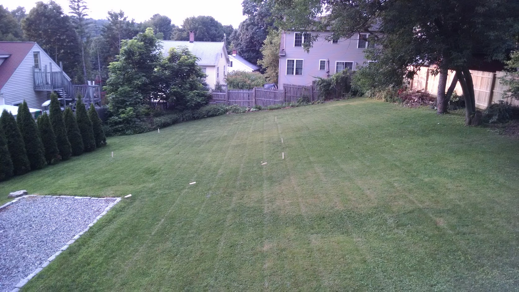

As for the future garage, this is what I have to work with.
aHfa0ED9oopn92Kk3lPMXstitc_TVPNQMoMRdNyWBQ=w1672-h941-no
Ignore the stakes, they weren't placed right. Shooting for a 28x28 with a room above and a two post lift. Whether I can get that is another story. Special permits are needed for any peak height above 20' and ideally I'd like to push it back closer to the back fence. Our current offsets are 25' in the back and 10' on the sides. I'm early in the planning stage so all input is helpful.
This is the amount of space it's going to take up.
PnWFx2UW7686vTbJFMlDDCCj7Y9y7B3bO_rpWDPc2Q=w1672-h941-no
Yellow is the garage, red is the concrete/asphalt driveway/pad and blue over on the left is where I will add stone like I did in the lower left (which will be paved over) for added turn around. This will be stone because I plan to run the electric after the garage is up and as time and money allow.
Well, that's what I got so far. Good, bad, garbage, let me know what you think. The undisputed garage masters reside here from what I've seen.

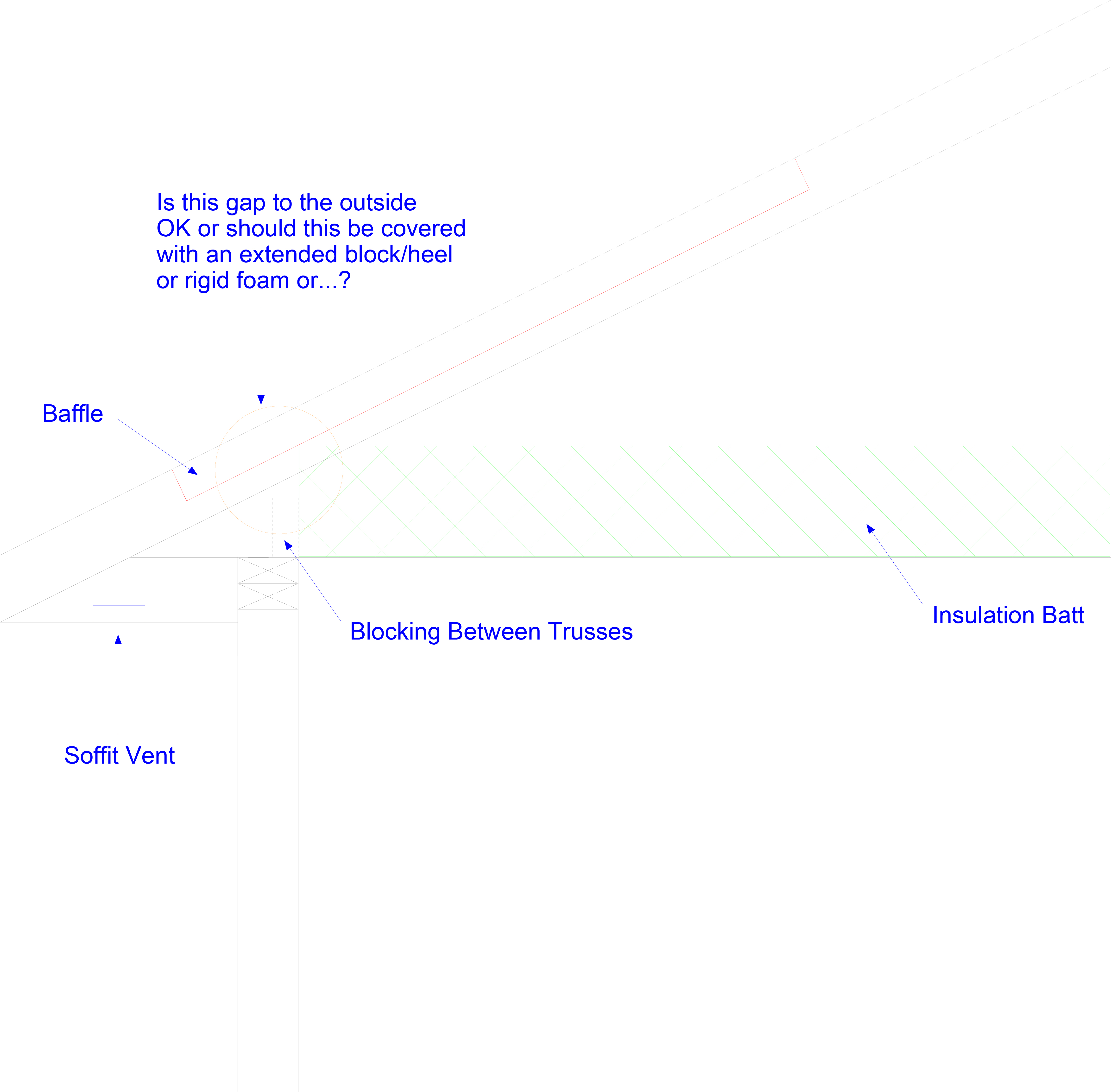

Working on messing with a ceiling and I want to be prepared to insulate it once in but I'm not 100% sure how the truss vents go. I assume that the first two are correct as the vent extends beyond the blocking.
Whatever gap there is between the block and bottom of the vent would be taken up by insulation (batts most likely.)
I also assume that install this way is incorrect...
Where the vent would be stapled to the inside of the blocking.
NOTE: Please, please, please ignore the fact I ripped that styrofoam to shreds as I didn't even think about the nails for the roof.

Looking around, I'm curious if I should block off the air gap that will exist between the top of the blocker and the bottom of the baffle (see image link for drawing.)
Apologies for needing a link. The image is too large (drawn in CAD to scale and exported.) It's faint until you zoom in.
