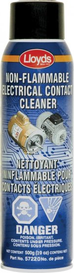

This is what I have been using it works great for cleaning circuits and switches
Lloyds Electrical Contact Cleaner
Multi-purpose cleaner used in servicing, rebuilding and maintaining electrical equipment. Ideal for switches, relays, shafts, bearings, armatures, brushes, contactors, etc.
Safe for all metals and most plastics. Used in most power-on solutions. Low odour. Contains no Trichloroethane 111. Dries quickly leaving no residue and a clean, paintable surface. Non-flammable.
Ideal for switches, relays, shafts, bearings, armatures and brushes
$7.99
