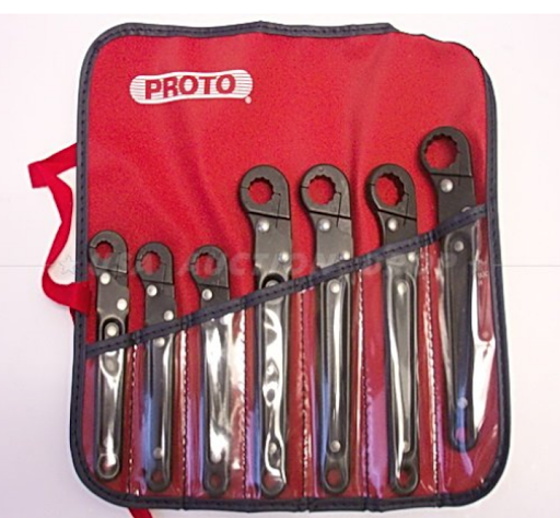

And for comparison's sake, has anyone ever used the older type of ratcheting flare nut wrenches?
http://www.royalsupply.com/store/pc/viewPrd.asp?idproduct=49948&idcategory=2745
Wright Tool OEM 3/8" wrench, closed and open:
Proto-branded set:

I've used the Facom 70A flare nut ratchets. Objectively they work very well, subjectively I spent the whole time thinking "I'm going to tear up the nut", on someone else's car, and ended up fetching my own conventional set.
I've no doubt the FastRatch works too, but I think I'd have the same mental block on using one. As they're $44 to $60 each (at today's exchange rate), I don't think I'll be buying one as an experiment :shocking:
