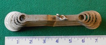

I found this set of nested box end wrenches in the bottom of a box of miscelleneous stuff I bought at an auction. I did not know that "SK" was derived from Sherman Klove.
I have read that they came out with the SK designation in the early 1930s, so these wrenches probably are earlier than that. The full set seems to be there, along with the original pin and wingnut.

These survived 85 years and with luck they didn't get thrown out or melted. Thank you for showing us this!

No patent number on them. They are in the envelope now awaiting pickup tomorrow. I am very glad they are going to a fan of old tools!

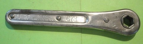

DadsTools said:
"...one of those pressed metal ratchets that has no maker's mark but are virtually identical both to the set listed on AA as the earliest sold under the SK name and to sets I've seen on eBay marked Indestro..."
I've seen those listed on Ebay in S-K and wondered about that too. They are indistinguishable from the Duro Chrome / Indestro versions. Maybe I'm not looking closely enough.
DadsTools
Jul 27, 2017
1,852
The sockets are the same too (although there is mismatched socket in the AA photos that I believe is from a later set, which is a shame because that's the one he chose to photo the details--look at the broaching in each of the sockets where they're shown together in a row and you'll notice immediately it does not match the others). Some of the ratchets may have a different kind of rivet in the head, but other than that, they were either all made from the very same stamping dies or one company literally duplicated the other's die with such a high degree of fidelity that the two are indistinguishable. Same for the sockets.
That being the case, either S-K were making these for D-I or vice versa. Could be also that S-K made the sockets for both while D-I made the ratchets. Something like that was going on.
