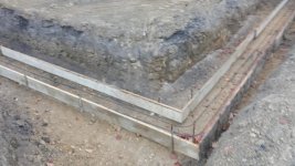

The footers are formed up and waiting for inspection. They should get approved today. Not sure how soon they can pour.

The footers passed inspection and they were poured, next up, foundation walls.
We are making progress....

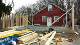

The framers finished up for now. I finally have a feel for what it will look like.
I was only able to get this pic of the front before dark. I think when it is done it will fit right in with the rest of the house. The garage addition projects forward exactly the same amount as the center portion of the house, 6 feet.
Now I am waiting on trusses.
Also, the framers could not get my engineered header up over the garage door opening.:dunno: I told them I would help, but they did not want any part of picking it up.
RSr
Jul 20, 2010
155
Pittsburgh, PA
Looks good, proportions seem in balance with the original structure. Strange they couldn't/wouldn't install the header, maybe they expect extra help when the roof trusses arrive.
T
tweidman
Dec 1, 2009
505
Ackermanville, Pa.
Thanks, my main goal was to make this look as integrated into the existing structure as possible.
I was almost able to get the header up there with my tractor, but the max lift on the loader was about 6" too short.
I think a different (larger) crew will be out to put up the trusses.
