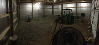

Been lurking and reading for quite some time, and it's finally my time to start a build thread. Long story short, the biggest I could go without a whole bunch of red tape was 24x26 on my lot. It's going to be 9' tall inside from the top of the concrete floor to the bottom of the truss. 1" double foil back insulation in roof and sides, 16x8 overhead door, 36" 9 lite walk door and 1 window. Farley bare bones as I am paying out of pocket as I go. We did the dirt work ourselves and I'm having a local Amish company build the barn structure. We will be doing the concrete and electrical ourselves. I have some pictures as they started the framing today. I will post more as the project progresses. Plan is to get the floor in pretty quick then I'll slowly work on the rest throughout the winter. 7d6e65e611b4f353516fcc61a297fabb.jpg

Small update, been drying the floor since Wednesday in preparation for the concrete. Dirt is now dry enough and got 4 hours of work in on it this afternoon. Drain is in and 2 loads of 53s in, partially spread. Had to call it quits for the night. Plan is to pour this Saturday, my Dad and I are doing all the prep and grading and then my brother in law, Dad and myself will be doing the pour. Slowly but surely, name of the game when you have more time than money [emoji23]0df9e896185d9442253b0eb4434dbdbc.jpg

Another small update. Nothing to major. Floor grading and base rock all done and packed ready for the pour tomorrow morning. Doing 5-6" fiber reinforced slab sloped to the drain in the center. I'll post more tomorrow after the pour!

Well we poured concrete on Saturday, couldn't have asked for better weather, it was in the 70s! We started at 7 and had buggied all the concrete in by 8 and had the final burn in done by 230. Turned out really well. Did the saw cuts yesterday. Now just to finish the cure then seal it up and start the projects!
