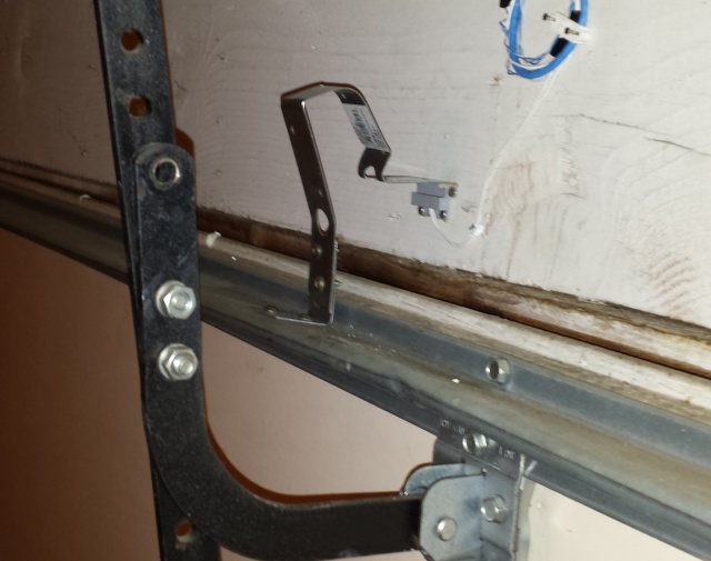

I got one of those wireless gadgets with the opener I put in the attached garage. So I put it in the detached garage but it has two doors. I bent up some wire and mounted the transmitter to that so that if either door is up it will show that on the receiver. Not pretty but effective.
View media item 6154
