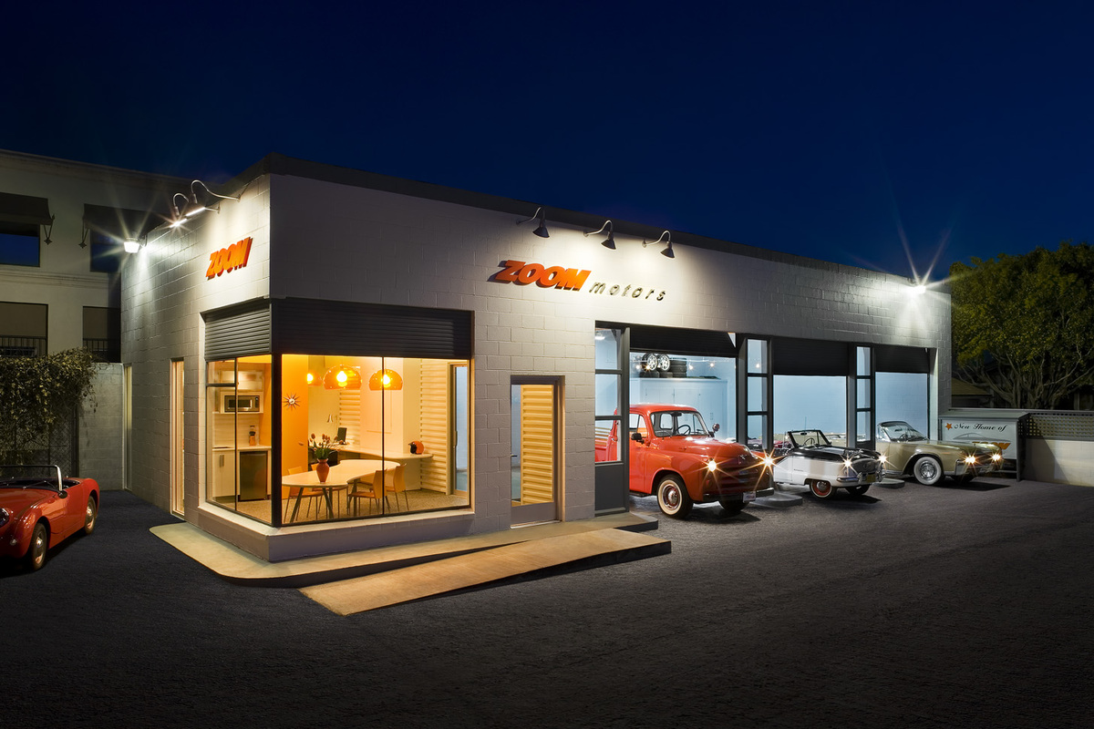

Given your taste in pickups and hot rods, I'd suggest looking at 50s and earlier architecture is a good place to start.
In terms of the roof, why not do something like this, where there is a brick facade, with a regular roof hidden behind it?
Cool dealership style could be an alternative to the gas station theme?
This is quite similar to your sketch!
Something different
The flat front facade is definitely a consideration. However, to get a 32-40' deep shop while maintaining a tall workable ceiling inside, you have to either go super tall in the front or really low pitch. Or run a gable behind the false front wall. While these are options, i don't know that they quite do "it" for me.
Ya i really appreciate service station architecture. Its all over the map. I guess i am starting to lean a little towards the later end of the era. Like that ^ ford dealership, more so than the last pic you posted. More clean, less formal.
