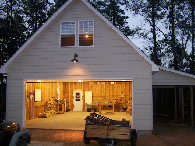

The carport motion activated flood light.

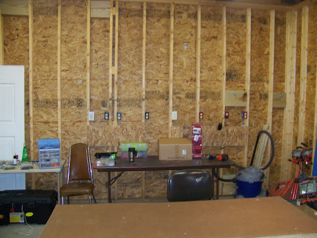

These are the 8 outlets at the future workbench.
The gooseneck light above the back door of the bonus room and dusk-dawn CFL Flood.

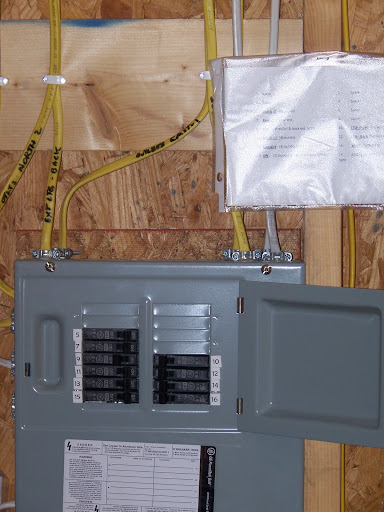

This is the small 16 ckt panel.

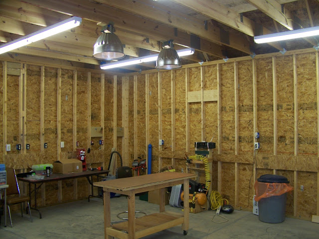

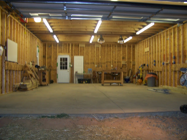

Nine 8' T-8 flourescent fixures. I went with 4 foot bulbs. Much easier to get home from the store. Sorry that this is fuzzy.

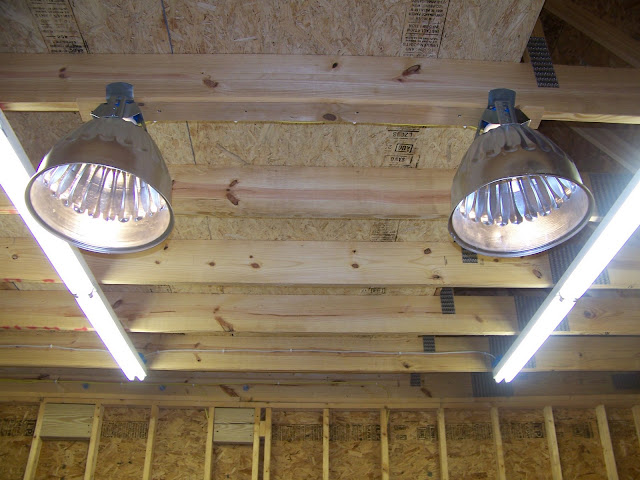

Alright this is my special lighting project. I got some scrap high bay Merc vapor lights with the guts removed and a standard 100 W fixtures installed above the wokbench.

1. Plan yor lighting fixtures early. Studs in the way of locations for fixture boxes. Small pancake boxes are really not code anymore.
2. You can live with half the number of outlets if you have one or two well placed extention cord reels.
3. Cramming wires into a box can rub some of the inulation off causing a short.
4. Make switched circuits as simple as possible.

Good lessons that you learned. some thoughts though :
Maybe add another head off the carport motion if it will accept it as the picture looks dim.
Why so many outlets at the bench ? Are they all on the same breaker ? Cant really tell by your legend but it appears they are.
Maybe change the CFL flood to motion to save you some money if no one is out there at night. A motion coming on would draw your attention to the shop if someone was out poking around.

On your breaker box directory, the ones labeled "spare" are really "space."
Since I'm not an electrician, I thought I would say this. The real electricians probably won't because they'd be criticized for picking on you. :thumbup:
Nice to see your broke the lights up breaker wise in case you need to do more electrical you will have some lighting available.
Like the light post !
The carport motion is not nearly as dim as it looks in the picture, but I will add another light eventually.
The workbench outs are on two ckts and are indicated by the red and black colored covers to remind me once the walls are covered. I still need to paint the GFCI covers though. They are labeled North - 1 and North - 2.
In the back I'd like to make both lights work off a motion dector. That might spook the baddies.

Very Nice.
Again, nice.
I've learned so much from the pros and amatures here at GJ. I am so very greatful for all the advice. Thanks to all that helped.
I guess the space is spare not the breakers that are not installed. You're right.

Photo tip: When taking a picture of the "lighting" projects, turn off the flash on your camera, they can be tough to compete with and make your lighting project apear weak.
I would imagine the electrical guru's will weigh in on the fact that you have outlets and lighting circuits together on breakers, that's a no no.
I think I can understand why.....would this also include a garage door opener?

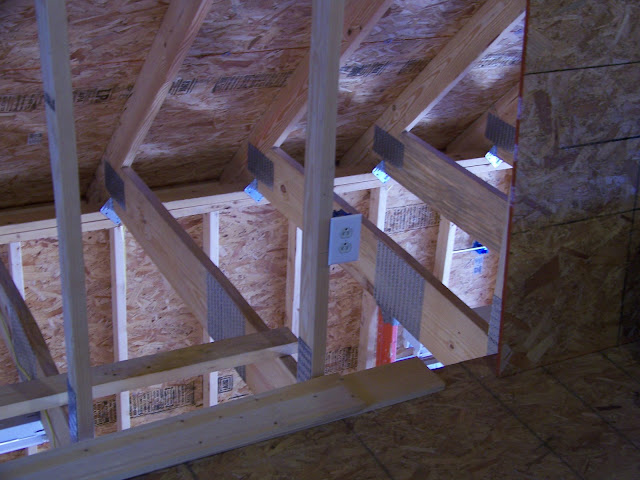

On the right hand wall you have blocking 2/3's of the way up that look like 2x8's or 10's. What is that for? Also you are showing some blocking at the top on the back wall at the top. same thing or different? And why the OSB strip around the perimeter of the wall midways up. And can you post up some upstairs pics?
One other little hint while you have pics. Before you cover your walls with drywall or such....pick out a corner (for instance the back corner in the pick I posted) and measure to your next stud in both directions. I am assuming that after that, the studs are 16" on center. The reason i say that is that the stud each way from the corner looks to be shorter than 16". If it is, mark a picture with the dimension and store it away in your toolbox, computer, or a drawer. That way after the walls are covered and you want to hang something, you won't need a stud finder or a knuckle to find the studs.

I'm not crazy about the idea of mixing lighting and receptacles in a garage but heck if that's all there is to complain about you did a good job. I don't like mixing the two because you have a lot better chance overloading a receptacle and tripping a breaker than you would a lighting only circuit. Breaker trips from an overloaded receptacle and the lights go out. Let's be realistic though, how many houses have shared circuits, MANY of them.
While you have everything still open I would love to see an emergency light put in, not required by code but it is an inexpensive insurance policy.
The blocking is to support the carport beams (not a super high load because of the other supports) and the ones on the back wall support the ledger board for the stair landing.
The OSB strip covers the horizontal run of romex. This is required by code for exposed framing. So that you can't (or unlikely to) hang things on it or store stuff behind it. This is only needed until I cover the all walls with OSB.

2) When you take the OSB down over the romex runs (before you sheath the walls) are you considering putting up protective plates? It's cheap insurance to keep screws and nails out of your wire runs. If not you probably should. If you insulate, do that before you insulate too, easier to see.

2. I was considering the plates although not required due to the fact I took so much time to make sure that the holes were in just the right spot.

How did the 100w lights over your workbench workout? Do they give you enough light? Shadows?

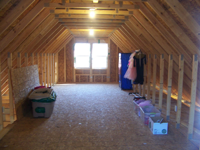

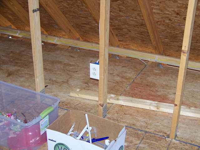

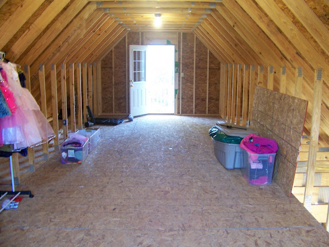

My wife is already storing stuff upstairs. The room is 15' X 36'. I'm planning on splitting it up into a store room and a TV/movie room.
I have 4 outlets upstairs (2 on each wall).
I'm trying both spot and flood lights in them to see which I like best. I think that I actually like the flood lights the best. I can also adjust the shade up and down to see if that makes a difference. These lights can be moved closer together If needed. I plan on making a larger workbench in the future (4'X8').

I like the looks.....
Have you considered using the space between the short wall and the roof as storage? In on pic you show how you have already put down OSB....a coupe of small doors and you would have a lot of space to store that odd stuff...you know, the junk that sits there for 30 years before you do something with it.....
15' wide? It looks more like about 12-13' usable feet to me.....
Storage; absolutely! I plan on at least one small door on each side. When I build the room, I'm thinking of putting in some built-in book shelves inbetween the trusses. This will still leave plenty of storage.
You know, I guess it is about 12' wide. I looked at the pictures and I have 3 rows of osb sub-floor (3x4=12 duh-huh).
