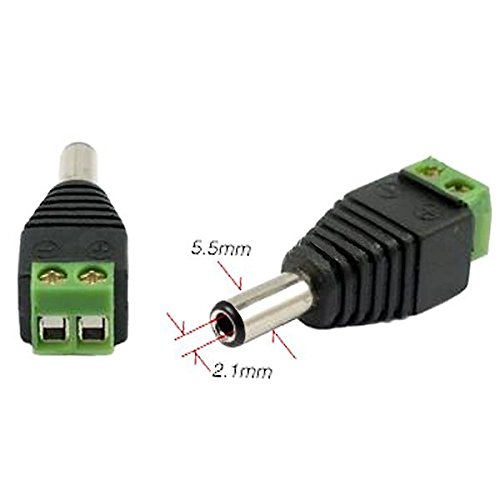

Yes I can.
so each light comes with a standard 2.1mm x 5.5mm female power plug. so I just bought these to connect my wire to that connector.
2.1mm x 5.5mm Male connector Link
The wires just get pinched in the back of the connector.
You could also Solder the + and - onto the LED strip. It's very easy to do. These LED strip and really easy to work with. You can cut them to the length you need. Very cool for mounting them around bends like under cabinets.
Another important aspect of the LED's lights. They run off of 12v. Because of the low voltage, the distance of the LED from the power supply will determine what gauge wire you will need to use. If you use too small of a wire, following OHM's Law, the lights will pull too many amps and the wire and lights will run hotter. I used a voltage drop calculator so I could use the smallest wire possible. My furthest run is 40 ft, for which I used 10/2 cable tray wire. As I got closer to the power supplies, I was able to drop the wire size down. The smallest I used was 14/2. Each run of wire is powering 2ea 75 watt strips for 150 watts total. 150watts at 12vdc is 12.5 amps. Using this Voltage drop calculator you can see what I mean.
At 40 feet, 12.5amp, 12 volts DC, the voltage at the end of the wire will be 11 volts. the LED's need 12. This is where the power supply saves the day. There is a POT screw on the power supply where you can increase the output voltage. Lets check it on our calculator. Increasing the voltage to 13 volts gives us our 12 volts at the end. Problem solved.
I did this for every run and the lights aren't dim and they don't run hot. I can hold the LED lights in my hands after running all day and it is barely luke warm.
