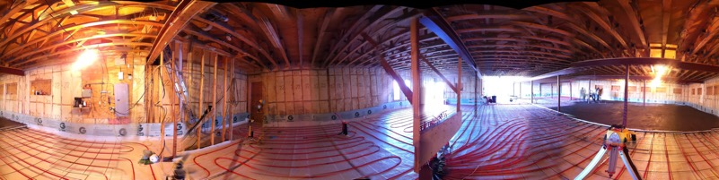

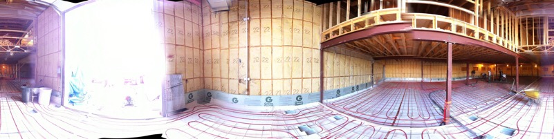

I've been on an efficiency kick in our 9100 sq/ft headquarters, building on a net zero goal envelope update completed 3 yrs ago. Having recently updated the building's 9 thermostats to Ecobee3 units, the next step is HRV control. The building uses a Venmar 220V commercial unit for fresh air exchange. It was previously just controlled by one of the air handler fan circuits, so operated via the thermostat's programmed fan function. This method of operation is pretty much a guess at adequate ventilation, and may in fact be quite wasteful.
We're trying to keep the building as simple as possible, so have deliberately avoided a dedicated building control. The Ecobee3 thermostat can control an HRV using an standard set of dry contacts. This however only runs the HRV on a schedule, rather than on demand.

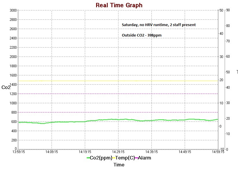

A call to Co2meters.com resulted in a few recommendations to manage our HRV. Joshua knew exactly what I needed, and was extremely knowledgeable. I ordered up the RAD-0301 Indoor air quality monitor, as well as the TON-0007 Co2 Monitor with Relay
The Co2 monitor plugs into a computer or power supply via USB, and uses free software to log levels. The wall mount CO2 monitor runs on 24V (like the HVAC system) and has a relay that in our case will open at 900ppm, and close when levels fall below 700ppm. You have four options, 800ppm, 1000, 1200 and 1400 set by jumpers for relay control.
You can see here that C02 levels in my office are just under 700ppm, with the HRV running constantly for a few hrs. The unit on the right is the USB powered monitor, and on the left, the wall mount monitor that will eventually control the HRV.
Before I install the wall mount units, wired to the HRV, we'll monitor a bit to see what our baseline looks like. The small monitoring unit plugs into a PC USB for both power, and the ablity to log CO2 levels.

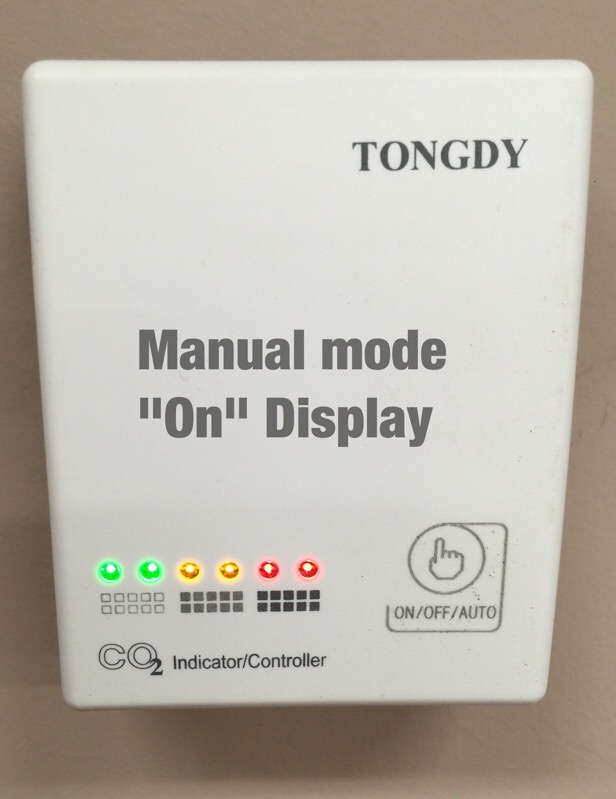

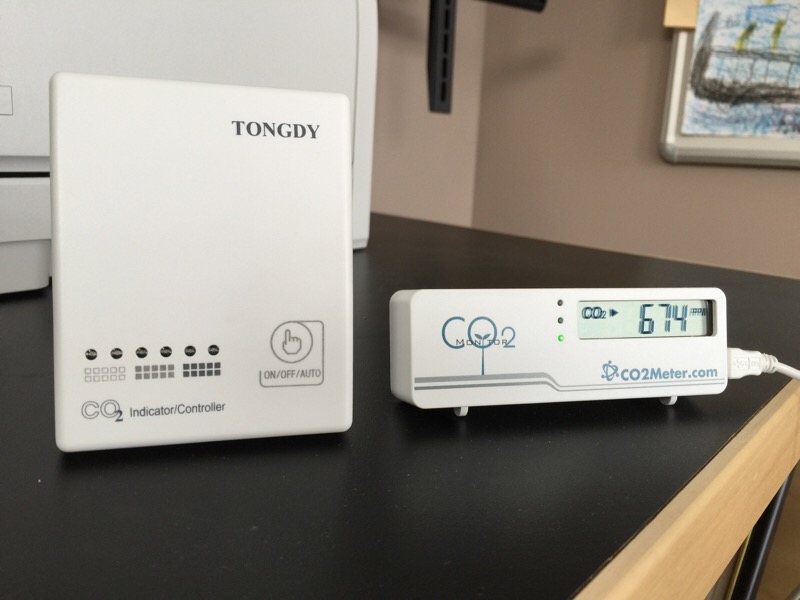

Co2meters does sell monitors that I believe you would use with a full building control system as they have 4-20mA or 0-10VDC outputs that could stage ventilation as C02 levels rise. The Venmar is a very efficient unit, but only has two speeds, controlled by dry contacts. I've always found the lower speed works well, and the first day of C02 logging confirms that. The Tongdy is relatively inexpensive, and provides exactly what I need..a closed dry contact relay which opens at 900ppm, and closes at 700ppm.
I have two of these:
Nelson at CO2meter.com suggested 700 is a very good target for air quality.

My thinking based on logging so far is that the 200ppm window on the wall control (on at 900ppm, off at 700ppm) should prevent short cycling. Will definitely monitor.

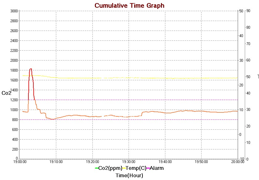

Here's a few C02 level plots done in the 2-4pm range by one of my crew. On Monday, the HRV was run on a manual schedule from 6am to 7am (off peak hydro), then again from 1pm to 3pm. On the weekend, the HRV does not run at all as normally there is no staff working.
Based on these plots, I would guess running the HRV based on actual C02 levels will not run much with winds 15km/h and above outside, forcing air through the envelope.

To wrap up this thread, here's the final install. Power to the CO2 meter is running from a 24volt transformer that was already in place in our mechanical room. The dry contacts to the HRV (on the 2nd floor in another mechanical room) are routed using two of the eight wires in an unused CAT5 network cable. The building network patch panel is very close to the HRV, so this was an easy way to connect to the Venmar HRV.
