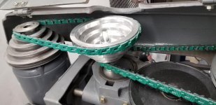

Here's my work-in-progress $20 Darra James ToolKraft with treadmill motor and controller:
At 300 rpm, as shown, it pulls perfect coils of swarf from aluminum using a 1/4" bit or counter-sink. It works well from about 200-2,000 rpm, but the old bushings start to threaten to come apart at the high speeds.
I'm having all the worn-out bronze bushings bored out and replaced with needle bearings tomorrow. That should reduce the noise and run-out a lot! It should also greatly increase the cost of the job. So far, the housing for the controls was the most expensive part of the project--treadmill price was "haul it off!" Before the machine work, I'm less than $100 into this project.
I'd like to make or purchase an intermediate pulley set up like those above (mounting it will be a problem--this is a small press), as the treadmill motor is rated 1.3 cont. hp, but at about 4,000 rpm. Reducing the speed by half would be a huge increase in torque.
