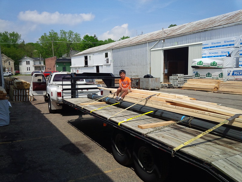

Next day's trip was to Alro steel in Jackson, MI to pick up 120pcs of 20' rebar, #4 bar = 1/2" dia and grade 60.
After lunch we found ourselves at the Fingerle lumberyard in Ann Arbor to pick up 2x10s for the footing forms. High gear, my friends, high gear!

Back to the lumberyard for a "lift" of 2x6x10s and some other framing timbers. I bought the entire thing being about +12 studs extra to what I needed, knowing I'd use the timbers or save them for future projects. I wanted the "housewrap" which comes with the stack for weather protection. I bought the "premium" Biewer lumber which is a made in Michigan product. Good timber with almost zero "wane" meaning rounded over barky sections that make a person go what the....?
