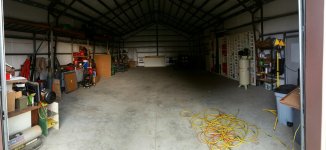

Thoughts on this? Basically a 30*50 shop. Use warehouse stacking stacked open end to open end (4'*8' sections) with wire racking up top to act as a mezzanine. Sheet the outside. A non-permanent, size adjustable tool crib.
I had a tool room in my last shop, it was originally designed for another purpose, but it was the best feature. I have presented this to a couple of folks I know and I get strange looks.
Thoughts? Hope this makes sense.

Basically, Yes. but instead of joining to run a row as normal, you would **** orange beam to orange beam to create a super "deep" shelf.
This will go in a corner, so sheet 2 sides, but one with a door. I like my tools out of sight, and they stay cleaner as well. The wire decking would be set at say 7' so the top will be a mezzanine (I have 12' side walls).
Kind of wish I had a bit of artistic ability right now. lol
This seems so simple, there must be a reason it has not been done. With 4'*8' sections of racking, I plan to use 3 sections, so the room will be 8'*12'.
Hopefully i am making this clearer and not worse.

Because it would be easier to just frame an 8x8 room in the corner of your shop with lumber, if you want it to be non permanent you don't have to anchor the base plates to the floor or even just use tapcons between a couple of the studs so they can be backed out easily later. A wire ceiling will let light in but it's also gonna let all the dirt and dust in. If you use a wire roof or sheet it you'll need some structure to carry the load meaning you'll need at least 3 walls to carry the load.

We had one in a shop I worked in. They used the loft area for parts storage. Everything was okay until a bin of small parts / consumables got dropped. **** would all fall through the expanded metal.
The owner finally wised up, tore it out and built a loft using dimensional lumber and 3/4 inch t&g sheet goods.
For what he sold the racking for it was about a break even.

I had given thought to the rack letting in dirt/ funk/ etc. That is a good point. I thought about laying ply or even masonite over the wire decking.
I don't think stick building a room would be easier, not for me, I have the racking, actually its set up as a shelving unit now.
I am not sure....lots of good points here. Figured there was a reason why I thought this was sheer genius and everyone I told about it looked at me like I had 2 heads.

I knew a guy that used four sections of pallet rack, each 4' wide by 10' long, with beams at 5' and 12' (had a 16 foot ceiling). He set them up long-side by long-side like you are talking about, and parked a car under the lower shelf.
He used supports between the beams every 2 feet, with plywood decking over that. The plywood sheets spanned across pallet racks, tying them together and creating a solid floor for the "mezzanine", where he stored stuff.
He had to remove some bracing from one of the pallet rack uprights to create an opening for access to the mezzanine area, and had a rolling metal stair (picked up at auction) that led up to that opening, then to the 12' top shelf area.

Here it is as it sits today. The original plan was to just have "high shelving" but I do not like how far it is stretching out. Stuff is getting too far away. Please excuse the mess, still moving in. The mezzanine height will likely be close to the same, but lower. Not sure what I am set at now.
These were Free-bees from work, they had been used outside, height cut, and the safety folks flipped. I am they guy who gets told to make problems go away. So basically these will be rotated 90* and stacked open face to open face, probably 3 deep (all I have now) to make an 8*12 room.

I would think they wouldn't be very stable without a support across the 8' length near the ground. Seem like the legs would want to kick out. Maybe if you bolted them down?

It's not a very popular idea because just coughing up the money to build an actual loft is a better idea.
Do you really believe that? I mean I can, but why? I guess we may be wired a bit different, but i like a challenge, this is free, and well, I like a challenge. I have tons of other stuff I'd also rather spend probably $5-900 on.
as pictured, they are stable as can be. If I do the room I will use tapcons or redheads as they are designed to have them

Got some work done over the weekend, still need to get it settled, but the racking is in place. Sheeting is in the shop but not up yet.
FWIW, I love it, my pops came over, he said, "Oh, I get it now, yeah, that is a great idea" and even the wife finally said, "I get it".

Took a bit to get pictures up, but here it finally is. Not sure this will be the "final" layout, but looks like it'll work for now. Decided against a totally sealed room for ease of working. Still gave me what i wanted, all my tools in a very compact space. I have also included a picture of the "magic bolt bin". Nuts bolts, electrical connectors, and basically all the other supplies all in bins. Weeks and weeks of work.

Simple, inexpensive, effective. You can reconfigure it, add on to it, or move the entire thing without too much work. You might find you want to add a second one for the fasteners/bolt room. It also gives you more wall space on the outside of it for storage/hanging items.
NAPA uses the same method in their distribution centers in a large warehouse by creating an entire second floor using the racks. It's very useful.
The only thing I'd suggest is that you bolt the two sections together so they are a solid unit.

If you look closely, it is not great. It was originally 20', cut down and used outdoors for a decade. But Free is free. I certainly wont be loading it anywhere near capacity. For the less than 1000# of stuff on top, its certainly overkill

Just be sure to bolt in the load beams so they don't pop out if the uprights were to move. I don't trust the "locks" that come with them.
Full disclosure, I am in California so around here, we are a little paranoid about the ground shaking.

Do you by chance have one of the orange shelf pieces install low on the very back corners? Adding the little shelf like you did should keep uprights from spreading. Good job.

I have a "medium" height shelf all the way to the rear. I can walk under it still so it is just over 6'.
Your idea is pretty good about the low one, the more I think on it, the more I think I will likely anchor these to the concrete.
