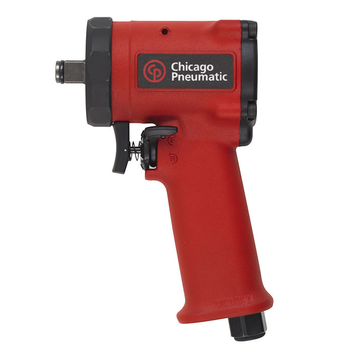

Chicago Pneu CP7732 - 2.9 lbs, 4.4" long, 95 db, 9,000 rpm, $116 shipped eBay 617 wk tq
Chicago Pneu CP7732C - 2.1 lbs, 4.4" long, 95.5 db 9410 rpm $150+/- 460 ft lbs 617 wk tq
