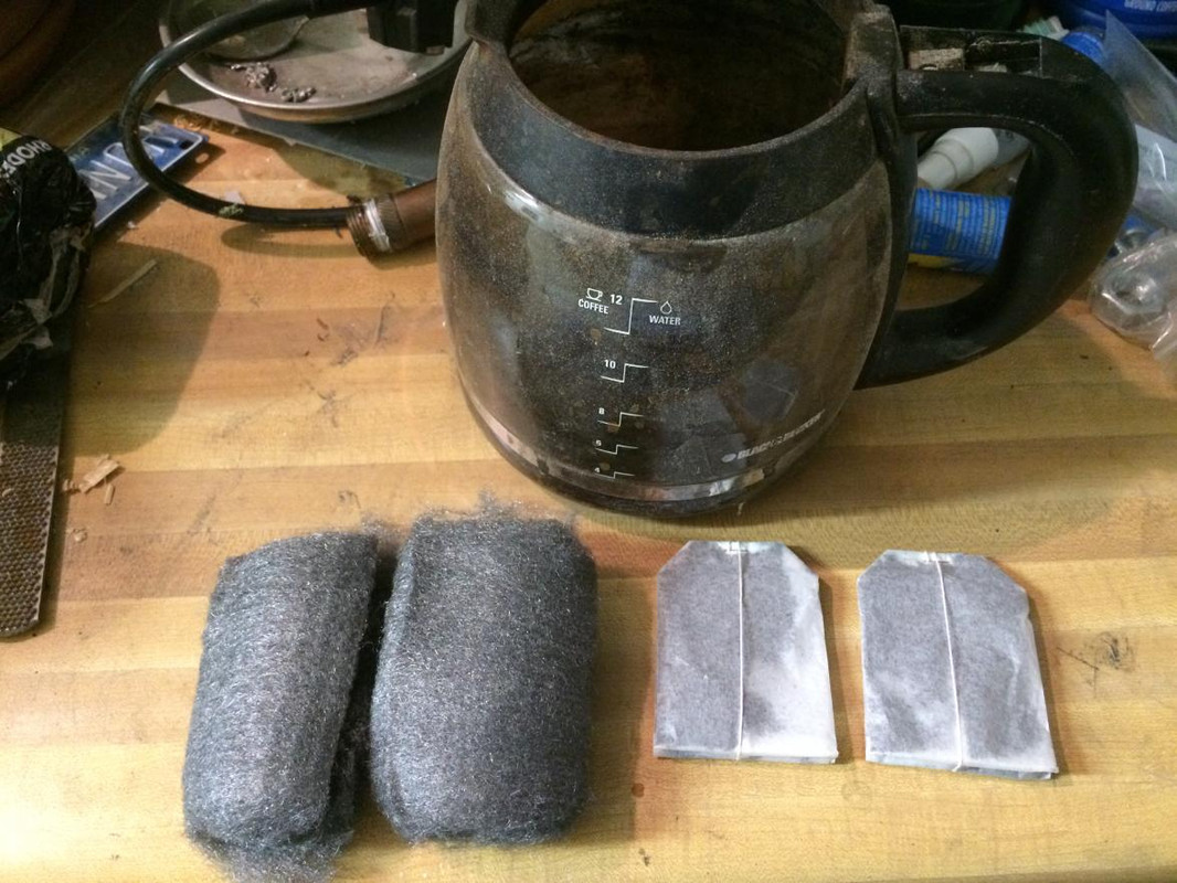

After making several gallons of the vinegar stain, I finally have a recipe to get to the color I want. To make one gallon, I start by pouring enough vinegar to make a full 12 cup pot into the coffee maker (this also is a great way to clean the coffee maker). I put two family size tea bags and two 0000 steel wool pads into the pot of hot vinegar (an old pot, not the one I use for coffee). After it soaks for at least 24 hrs, I use a piece of landscape fabric to strain it, then pour it back in to the remaining gallon of vinegar.

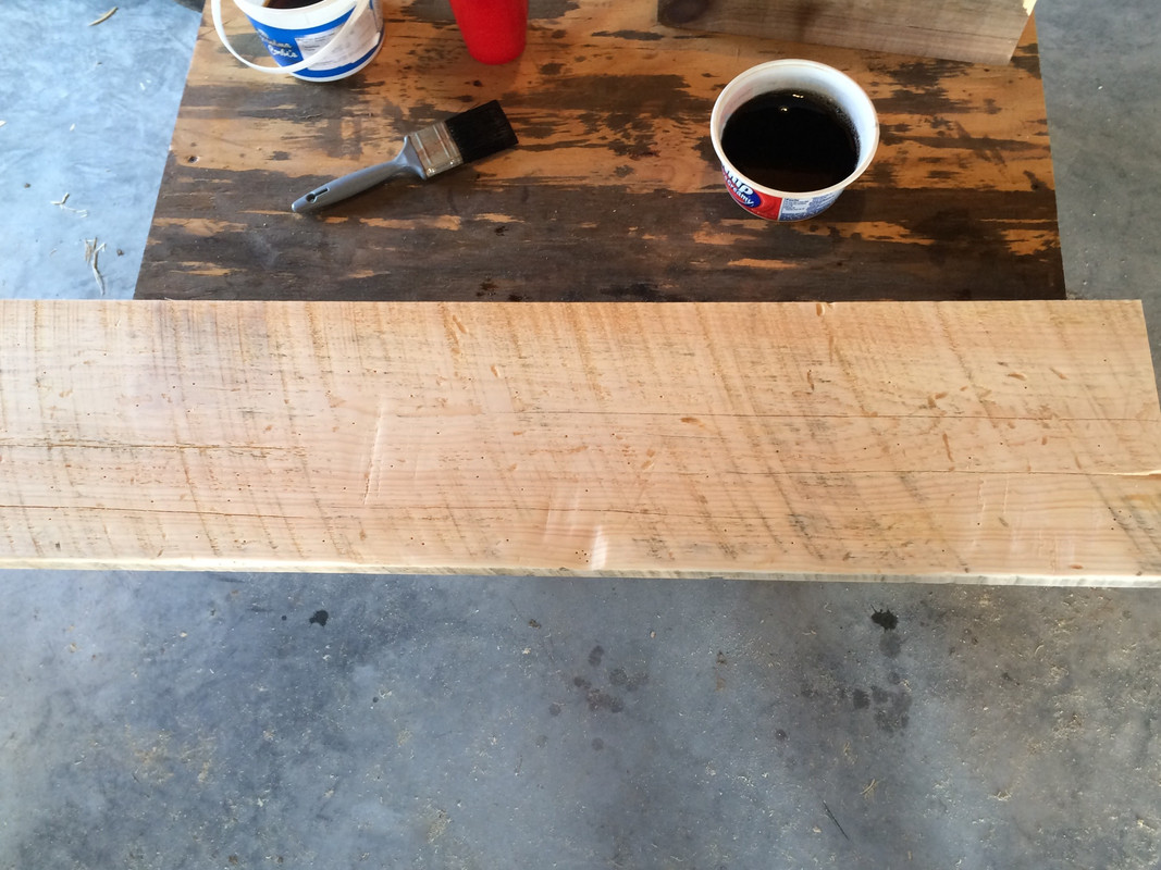

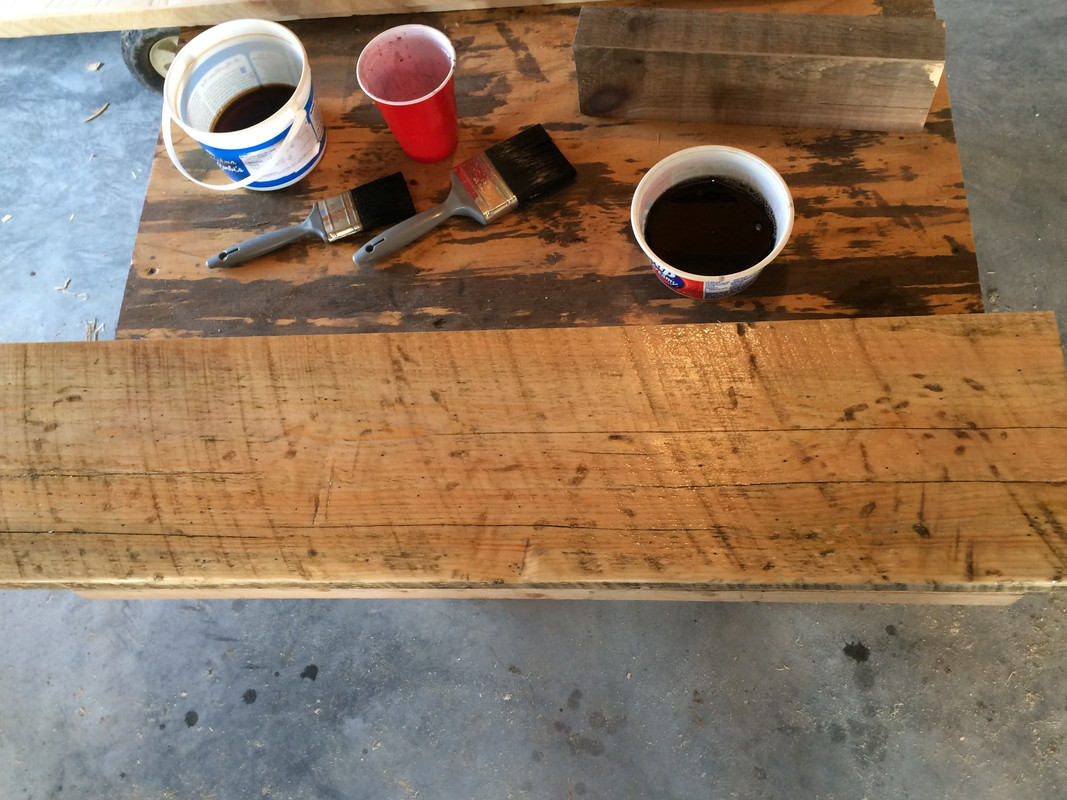

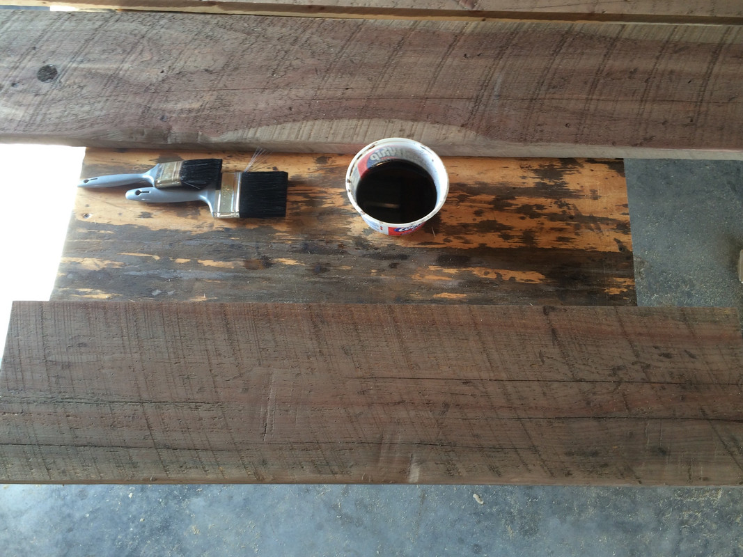

Well I finally got back to this project. spent several hrs figuring a formula that I could work with. I didn't want anything too dark.
my recipe was 1 pad of steel wool to 6 cups household vinegar. after it brewed for about a week the steel wool finally broke down.
I tried several variations of watering it down. tried 1:1, 1: 2, 1:5. 1:10 with water. finally ended up with 1:6 .
found if I added a little bit of dish soap it helped to break the surface tension and the brine seemed to go on easier/more uniform. without the soap I tended to get several pock marks where the brine didn't cover.
1 cup of solution to 6 cups water and a little squeeze of dish detergent , I ended up with the following results. ended up using about 8 cups of mix to treat about 400 sqft . I used a rag to apply and a small brush to get into areas that were say cracked, knots etc . I will also coat 2 coats of oil based urethane that has a golden tone to it. I'm happy with the finished product.
This is T&G pine that will be my garage ceiling, with rough sawn pine beams and posts made from 12" rough pine .
pic 1 shows an overview of my drying rack set up
pic 2 shows boards close up with solution applied
pic 3 shows a pc of untreated pine for a representation of colour that I ended up with
pic 4 shows the different colour variations depending on the amount of tannin in the wood.
