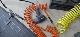

Background:
The gun has only been used a couple times since new. I went to remove caliper bracket bolts from a 3/4T Sierra. Factory manual says to torque these bolts to 221 ft lbs and use Loctite. These factory bolts have never been removed before and weren't particularly rusty or badly corroded.
The gun failed to break them free despite the guns rating of 750 ft lbs. Had to use a 24" breaker bar and lots of force.
I admit my pneumatic setup wasn't optimal. (ie 2 ea 50' X 3/8" curly hoses and generic couplings/fittings).
Questions:
1. Should this gun have been able to break them free? Were my expectations overly optimistic?
2. Is the IR 750 ft lb spec bogus. (like motor HP ratings).
3. Could required breakaway torque have have really exceeded re-installation torque by >3X. (due to Loctite, age, etc)
4. Is there a huge degradation factor based on setup. (ie hoses/fittings)
Other then this experience the gun has seemed to perform just fine.
TIA for any insight.

Low pressure makes impacts worth less. You don't mention your pressure at the tank, but if you are starting with less than 110 at the tank through that much hose you probably are shorting it. Lots of variables though, have to have a gauge at the gun to really know where you are at when the tool is running.

I'm pretty sure I was starving the gun from adequate CFM's for the task. Tank regulator was set at 90 PSI but it was 100' upstream from the gun with several/couplings fittings and a whip in between.

The regulator at the tank is the starting point. You probably were losing 20 psi through the regulator and another 25 through the hose. That's why you put w gauge at the tool and turn the regulator at the tank up as needed.

Just to close on this thread, I recreated my setup to measure pressure loss.
I lost a whopping 35 PSI!! With the compressor at 90 PSI, I was only getting 55 PSI at the gun. I never realized line loss would be this huge!! To get 90 PSI at the gun I had to dial up the regulator to around 120 PSI.
The gun is hereby exonerated. The 'tard behind the trigger is not!! Thanks for the help!!

Don't forget to grease the unit, I've seen multiple well use IR impacts that were wimps that once greased surprised their owners with their grunt.

It has a grease fitting on the body
Loscaldazar
Feb 23, 2013
2,385
You need a micro/mini grease gun to grease the fitting. It's not a grease zerk, but a little ball. Most people forget about this!
Also, are you sure those curly-q 3/8? I've only seen 1/4 curly hoses. Spent $20 on a goodyear or even better, a blubird blue hose (my favorite hose) 3/8 line and a $15 bucks on Milton V fittings. You'll have a better hose and much better power (and be able to run your impact longer at full power, since less pressure drop will be present in the lines).
