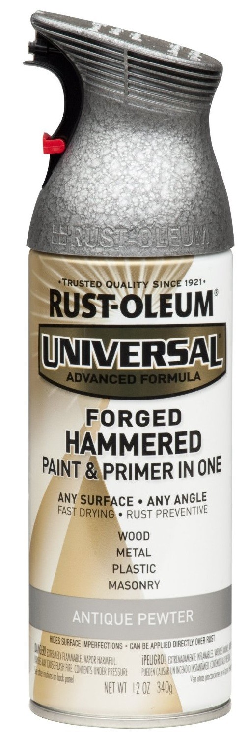

I ended up finding a "Antique Pewter" hammertone that I think will look nice. I do have some red tool boxes, but my rolling carts are black and grey, and my cabinets are blue. Clearly, matching in the garage is not my "thing."

Productive day. Everything is painted and will cure for a couple of days until I can find the clip.

Looking great so far!
Your textured paint looks fantastic and I love your choice of color. I hesitate a guess that this is not the first time you have spray painted something, right?
Do you have any inside information about how to achieve great results with the textured paint besides simply following the directions on the can?
Well done my man! :beer:
G
goofiefoot
Jun 24, 2016
196
Rockport, TX
Thanks! I really like how the color turned out. No, not my first spray job. I paint light coats with time to dry between. I usually hang the pieces I paint so I can hit all sides with each coat, but that wasn't possible with this project. In this case, I had to just wait a couple of hours before I turned the pieces over to get the other side
I hadn't used the Rustoleum hammered before, and while the texture just worked out with my technique, I really hate the design of the can.
The trigger mechanism is awkward and takes some effort to squeeze which makes it difficult to spray evenly. I'm more comfortable with a simple traditional spray tip, but I've also had luck with the clip on triggers.
Shiftless
Mar 9, 2014
14,712
East Bay SFO
Just follow the directions..nothing special...Hmmm....
When I used the hammered finish paint, black, out of the same odd shaped can, it resulted in a mess.
I used the Rustoleum primer over bare metal on a Prentiss Bulldog. I let it dry several days. Final product was so blotchy I recoated with textured rather than more hammered.
Did you use primer first? Your paint job was excellent in hiding the imperfections in the surface of the jaws where dings usually telegraph through.
Once again... Great Work!

It's just a trick of the eye. Most of the texture you're seeing IS the imperfections. That's really by design - I want most of the character to come through.
I did not prime first, just prepped the bare metal as best I could.

Shift: if you want a great finish with the spray can hammered paint i opt for the $10 per can version instead of the $5 one that GF posted. both will give a good hammered look if you can put it on the right thickness. the key is to warm up the piece either by laying in the sun at 70 degrees or in an oven or smoker. then spray on a final coat a little thicker where it almost runs. you don't need to spray on a primer coat, but if you do just a light one works ok.
