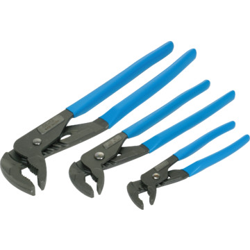

If you were to only get one more item I would get a 10" or 12" pair of Channel locks. Still made in USA. But there are so many scenarios out there in the automotive world were it often seems you are not working with the optimum pair of pliers.

Channellocks (arc joint) in 2 or 3 sizes.

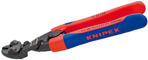

I have a larger pair of electrician pliers and the Knipex mini-bolt cutters.

My Channellock 420's are probably my most-used set of pliers. The 430 is just a touch longer and has 2 more adjustment positions. I have a hard time imagining getting by without a set of waterpump pliers. The Knipex style ones are really really good, but even a no-name set of tongue & groove style pliers are absolutely essential, IMO.

If your looking for Channellocks, this style seems to have greater grip strength. I find myself grabbing them before my trusty old 430s.
