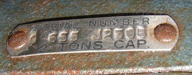

It was dark when I got home but I took a few pics anyway after giving both of them a real quick light clean up as both were pretty dirty, and still are.
Attached are a few pics of the Walker 2 ton 93655.

Anywho, my first thoughts are the 2 ton is huge and heavy. I didn't put a tape on it but it's got to be 4 foot or longer and getting it up and into or out of a pickup by myself is definitely a no go. I like how the handle has three different positions you can crank the jack up from: standing up, about halfway leaned back, and just about horizontal to the floor.
The 1.5 ton looks to be about the same thing as more recent Hein Werner or Snap On floor jacks. If I'm not mistaken Walker somehow became Hein Werner and they were the OEM for Snap On. I'm hopeful someone will correct me if I got that wrong.

Ok' Im seriously jealous & mad, even sad that I missed out on these but I'm so glad a GJ member got them first..:beer: :drool:. Good 4 you bro'', what a great find!!
WWheeler' you can send HiBall a pm & he'll have the correct kits I believe? My understanding is Hiball travels a lot so it may be awhile before he gets back with you but he normally will get back to you at some point if you shout.
Lazzar's HCRCNow.com kits will fix you up well and may be quicker and you found them already but Hiball can be cheaper if you can wait on it?
Walker Jack Identification help???
http://www.hcrcnow.com/uploads/drawings/walkerlincolnserialnumbersystem.pdf
Located that here with other info. (see- Walker Lincoln - Serial Number System)
http://www.hcrcnow.com/drawings/lincoln-walker

I don't follow what you are saying about the resivoir tank. The bottom of the tank sits in a groove in the pump body. The ram cylinder has flange at the top, that has rwo notches it, that you describe as the spanner nut. When you screw in the ram cylinder the tank is pressed and hopefully sealed between the flange and the pump base. Where do you get 700ft lbs and 300ft lbs? There is only one thing being tightened that creates a seal at both ends of the tank. It is not much different than any bottle jack. Later Hein Werner jacks like my 2 ton recommended Loctite 515 flange sealant to guard against leaks but that is obviously only usable if you take it apart. Another problem with taking it apart is having to fabricate a two finger socket from an impact socket to remove and replace the flanged ram cylinder. Any other method will make a mess. Ask me how I know.
123Go
Oct 7, 2012
201
Hey' 6ptsocket, glad someone is really reading here..
Indeed the oil reservoir is held down by the spanner nut and spec'd at 300 ft lbs. I should have wrote Ram Cylinder or simply Cylinder I shouldn't have used case to describe it.
The main Ram Cylinder is torqued to 700 ft lbs into the block assembly and gets destroyed a lot while removing to be clear. So don't do that...lol
