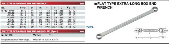

t45, many thanks for the insight. Didn't mean to put these dissimilar wrenches together. Was just brainstorming about a way forward.
I want reach. For timing belt tensioners. For A/C, Alternator serpentine pulley bolts. Transmission drain bolts. Oil changes where the oil filter is in the way. (I'm looking at you Honda!) I like the idea of these XL long 0-degree offsets. That last KTC set is kind of nice. And I like how they don't stand out too much from the Snap-ons. But I think I'd rather have that 22x24 than the 8x10... But maybe that's just cause I had to crack a 24mm on my brother's Volvo this past weekend...
I think I'd like a small set of these three wrenches, preferably in the extra long zero-degree offset. 12x14, 17x19, and 22x24.
Those three wrenches in the Wright modified offset are coming in at $75 shipped from HJE. I can't find out how long they are though... The catalog doesn't help either...

According to wttool.com 12/14 is 8.6", 17/19 is 11.5" and 22/24 is 13.1"
I'd be inclined to believe the size but can't state for certain it's right.
