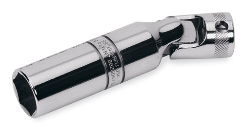

I've had a Gearwrench 80546 swivel spark plug socket with a permanently attached extension for a few years. Makes it so your extension doesn't come out of your spark plug socket when using it, and it has a swivel function making it easier to get into some hard to reach places to do spark plugs (Subaru spark plugs....).
I figured I'd upgrade to the Snap On version- the FSXK320A. I received it a few days ago and went to use it yesterday. It is shorter than the gear wrench version, meaning it can't reach all the way down to the spark plugs in a Subaru without adding another extension (the drive end of the Gearwrench just barely sticks out, allowing for a ratchet to be attached to it).
Furthermore, the collar that retains the pin on the swivel portion is larger the the one of the Gearwrench. It won't even fit through the spark plug access hole to remove the spark plug! The gearwrench is much thinner and has worked on every Subaru I've used it on!
Even better, the Gearwrench uses a magnetic retention system that works way better than the rubber boot in the Snap On.
Here are some measurements..
Thickness of the Chrome socket portion (Snap On slightly smaller):
Snap On- 0.8550"
Gearwrench- 0.8630"
Thickness of the Swivel Pin Retention Collar (Gearwrench significantly smaller by over a tenth of an inch):
Snap On-0.9840"
Gearwrench-0.8800"
Price:
Snap On-$73
Gearwrench-$10-$15
The knurling is better on the Gearwrench to boot too. I'm surprised the Snap On doesn't fit Subarus, as this type of spark plug socket was practically invented to do spark plugs on them. So way to go Gearwrench, some of your products are indeed better than Snap On. I'm also glad I decided to check this before getting rid of my gearwrench socket.

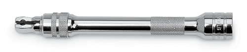

Snap on has 40 types of spark plug sockets...
and locking wobbles that are much lower profile than 5/8 sockets
Which also come in various lengths, as do the 5/8 sockets... :headscrat
Of course none of this is needed if you aready have a socket that works. :eek:
But don't blame a brand when they offer a greater variety tools for the purpose that are being overlooked.
(also, snap on locking extension, have anti-snag flanges and release mech's that work against any counter-force should they "catch" on withdraw--two redundant design elements built in for FOD avoidance )>

When it comes to spark plug sockets, imports are better.
Craftsman USA 5/8" vs Koken ZEAL 16mm:
5/8"/16mm thickness of outside wall of socket:
craftsman 22.13mm or 0.871 inches
ko-ken 20.53mm or 0.808 inches
The locking extensions I use are slightly lower profile than the outer socket wall thickness so it hasn't been an issue yet. Will say that the Koken plug socket fit into the plug well of an '89 Suzuki Katana where the Cman did not.

I'm not blaming an entire brand for anything. This is the tool to do Subaru spark plug sockets quickly without removing things in the engine bay. The all in one design is simple and guarantees no separation between socket and extension.
I looked up the locking wobble extensions and the Snap On swivel sockets (without the permanently attached extension- the S9706KFUA). The total length of those two would be 6.72," which is going to cause clearance problems once a ratchet is attached to that. It may work for some Subaru applications, but not all like the gearwrench tool will.
Snap On decided to also produce this style of spark plug socket, and it isn't as good as the gearwrench. That has no bearing on any of the other Snap On offerings for spark plug sockets.
