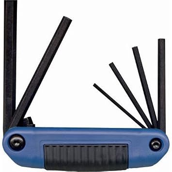

I needed a new set of hex wrenches and read great things about Bondhus. Their site even goes to great lengths about how their ends are cut and chamfered in a superior way. I just received them in the mail, and they're pretty sad. The ends not only are not chamfered, they're uneven, and have chunks missing. I really hope this is a bad batch and sent them an email. In the mean time, I wanted to see if anyone else has had a similar experience, or if there's another brand I should be looking at. My made in China Stanley set looks like the lock work of a nice watch compared to these. I love my USA made Craftsman set, but it appears the new ones are now China.

I don't think those are genuine Bondhus. If they are, their future is pretty dim. I've never seen that poor of quality from them in the past.
Not to be too inquisitive, but how much did you pay for a set of those?

Thanks for the replies. I got them from Amazon. They are all stamped USA, the size, and a hex icon. The steel feels quality, and they appear to be genuine. The ends on ~70% of them look like a crayon that was snapped in half. I really hope this is just a bad batch.
I've had a lot of issue with "made in USA" products from once great American companies recently (brand new S&W 686 revolver, Remington 870, Hein-Werner floor jack to name a few). If this trend continues it is a slap in the face to the efforts to keep manufacturing in the USA. I bet Taiwan could make some real nice handguns. Sorry for the rant. LOL

That's how the ends usually look on at least a couple of the keys if you get the double pack (like the 22199 set) with metric and SAE. That double pack is only about $13 shipped on Amazon so I think they had to cut corners a bit to meet a price point. If you pay a little more for the more complete metric only set that doesn't skip sizes, get the black coated torx wrenches, ball drivers, or any of the gold or silver coated hex key sets you get well formed tips. I did anyways. I think they are trying their best to make a value type set to compete somewhat with all the cheaper tool brands out there, kind of like how Channellock has cut down quite a bit on their finish quality to be able to stay price competitive with China tools at Home Depot and Lowes.
I have and use good and poorly finished Bondhus L wrenches. I just make sure to keep any bad ones I find cool and I grind off the first 1/8" or so of the tips and I am left with perfectly formed ends that are made of good quality steel with a good heat treatment on them. It is a quick fix and in my mind at least the little extra effort required on my part is worth it for the price paid when all is said and done. I have been using Bondhus stuff almost exclusively for quite a while now because they are very good and I don't know of a better bang for the buck brand. In my experience they fit fasteners just as well as the expensive brands too.
That makes sense. Judging by the good reviews this could be a recent development. I'm returning them regardless, but will see what Bondhus says. Price isn't a factor; I just wanted a good non-ball end set.

Looks like the wrench was sheared off bar stock, and they didn't perform facing operations.
My Eklind sets that i received as a gift in 2006 were only sheared, they do not perform a facing op like Bondhus. But, their shearing looks better than that.
I have Bondhus in larger sizes in sae 7/16 and up, they are all ball end long length, and beautiful as far as hex keys go.

Do they have Bondhus stamped in them also? Is it spelled correctly? All of mine do. I looked as tome of mine and some have 'made in usa' all in line and some have it in two lines;
made
inusa
So that tells me that things have changed along the line or they have two different places making the wrenches.
This thread prompted me to look at my Bondhus drivers and they do not have "hex icon" on them. The tips on mine are all ground, but mine are ball drivers.
Can you post more pics of the wrenches and packaging so we can see what you received?
My Eklind driver set like this has sheared ends sort of like what you're picturing.

Another way to dress the tips (which I agree shouldn't be needed on new tools) is to chuck it in your vise, and file it.
Here's my set with one hastily dressed (no chamfer). Can you spot which one ? :)

Those are the ones, their pro-guard line. They have the exact same description as the ones with a ridiculous gold finish (I don't understand how gold could hold up). The BriteGuard / chrome ones don't have a standard length metric set available in hex (not ball end) just extra long.
It's identical to the photos on their website. It's their newest production judging by the logo stamped on the plastic holders. I've seen server variations of the printed logo looking at images on here and online, mine look just like the ones on their site.
I'll post an update when I hear back. I'm really just looking for a non ball end standard length set. That's only available from them in the finish I have and gold (which as previously stated seems like a stupid idea for a coating).
