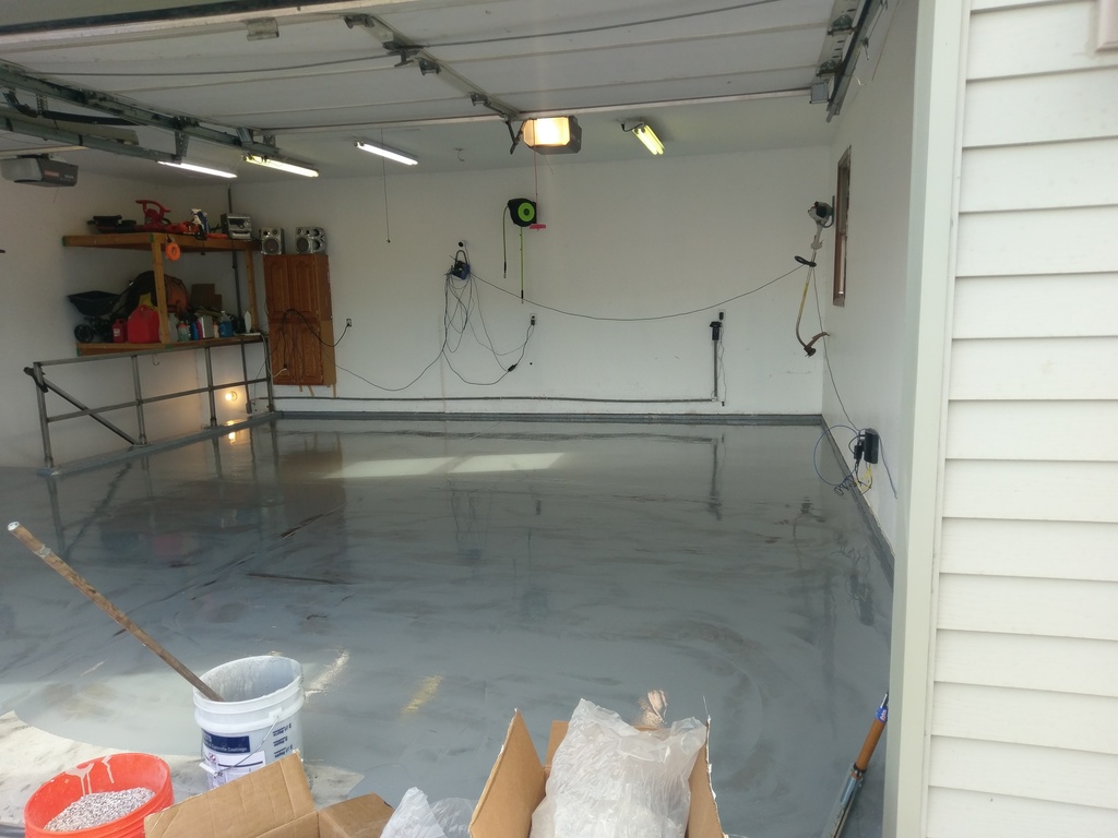

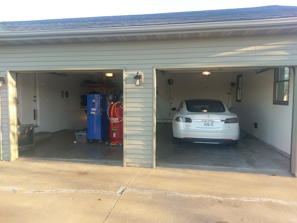

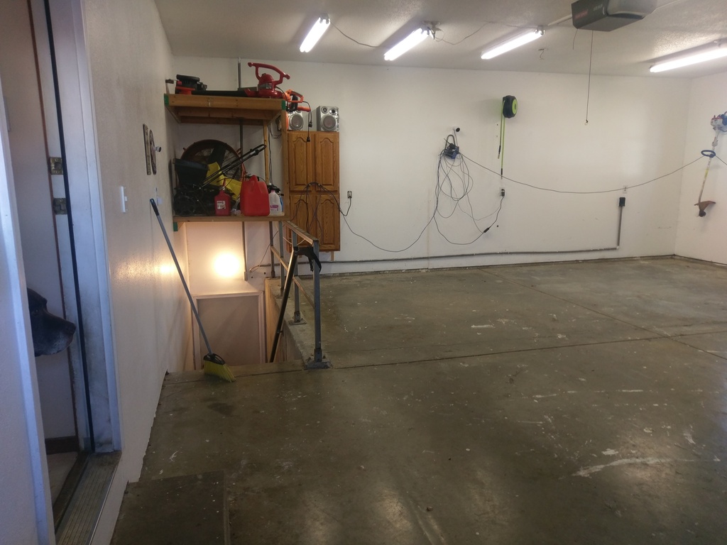

For awhile now I have been trying to figure out what flooring product to go with in my garage. After getting a couple Racedeck type samples from various companies, and thinking long and hard about what to do i went with epoxy. I like the idea of plastic tiles as I am not really planning at staying at my current home for very long but decided ultimately given the shape of my concrete and the weird slopes it has by the interior door way that epoxy was the way to go.

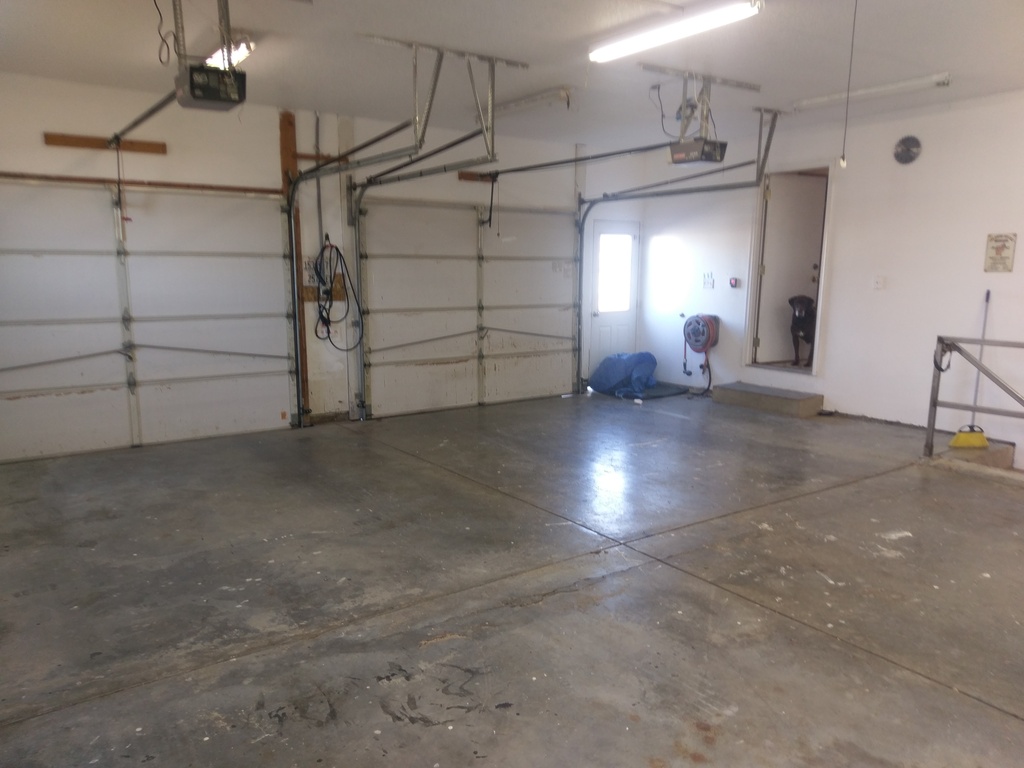

Some of the before shots. Its kinda hard to see but the concrete had a few cracks in it, old paint and herculiner stuck to it and overall looked like ****.
The black stuff is the herculiner, lasted longer in the garage then it did on my trailer project sadly... :(
Cleaning out the garage completely *****..
Install day...

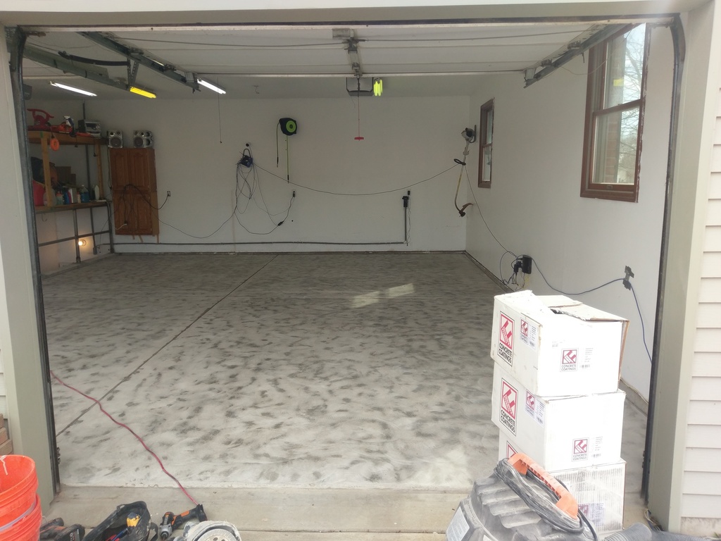

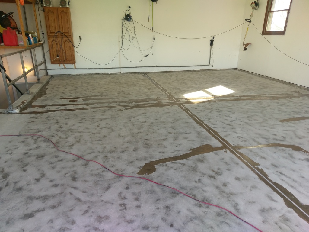

After grinding..
Fix the cracks
Putting the Epoxy Base on..

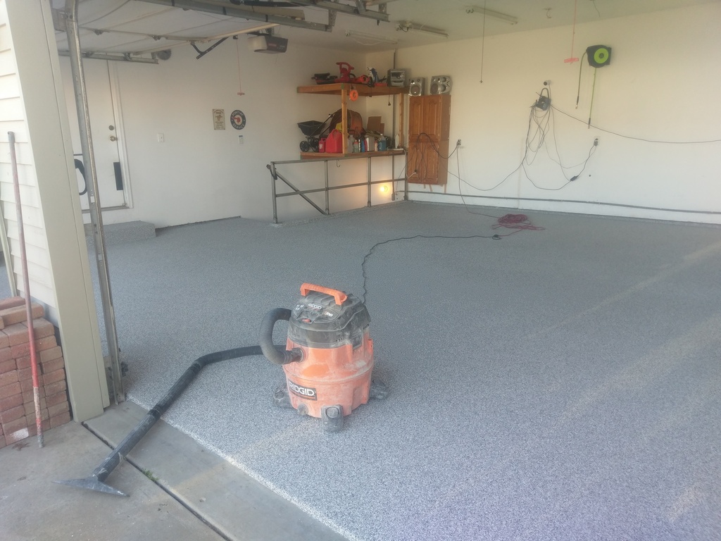

Flakes and color
Clear is on..

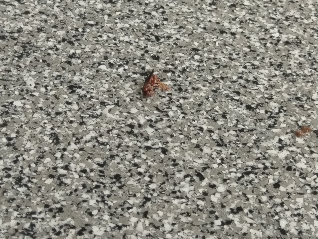

Found a bug..

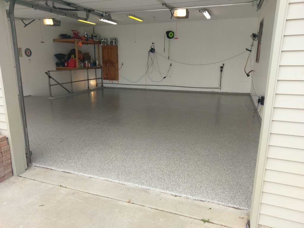

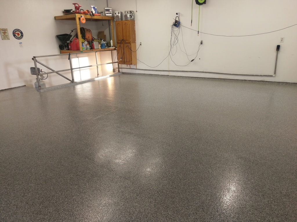

The results..
Overall there was one spot that doesnt look good I have the option of having the installer fixing it or just live with it not sure what i am going to do yet.
Overall I am pretty happy with the results, I guess we will see how it holds up over time. The project took a single guy about 4 hours the first day, and 3 hours the following day to complete.

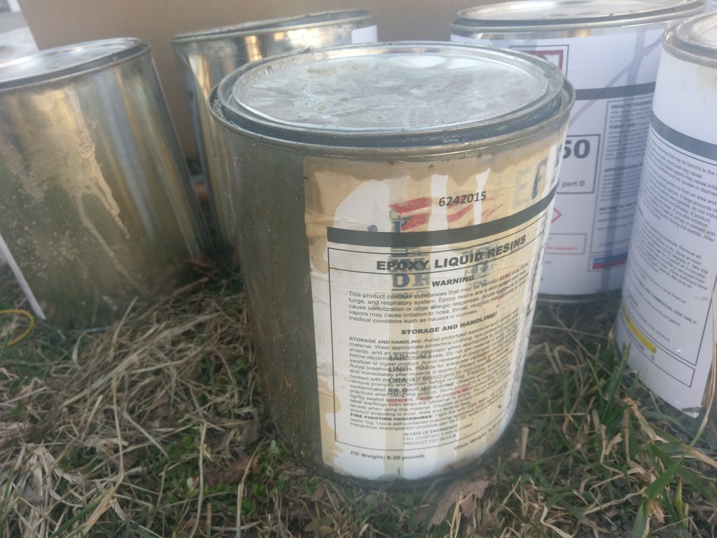

Thinking about this after finding out its 95% solids, instead of the 100% I was told was it would be. Should I bring this up to the installer and what will I notice because it is 95%? Will it just be 5% less mills then what it was when it was laid down or is there going to be a long term issue with the floor?

Well, the 95% solids isn't the issue. The problem is your overall coating is likely really thin and they didn't use an appropriate primer. That price is just really cheap for epoxy. Too cheap. You can bring it up if you want but it won't be worth your time. Any decent installer wouldn't touch a job for that price. I just got into the business and could barely get materials for that cost. That being said if you don't intend to use the floor very much or expose it to salt or anything you might be okay. Situations like this is why epoxy gets a bad name so often.

There is very little difference between 95% and 100% solids. The missing 5% is replaced with solvents. It actually makes it easier to apply with no measurable difference in thickness. It also helps with penetration into the concrete when a primer is not used. Primer is not a requirement, but it is highly recommended for high solids epoxy.
$1500 for 700 square feet is cheap and a reflection of only two coats of material total being used. I'm guessing the top coat was epoxy as well and not a polyurethane or polyurea? The going rate is a minimum of $4 a square foot for a professionally installed coating with a primer, high solids base coat, and high performance clear top coat.

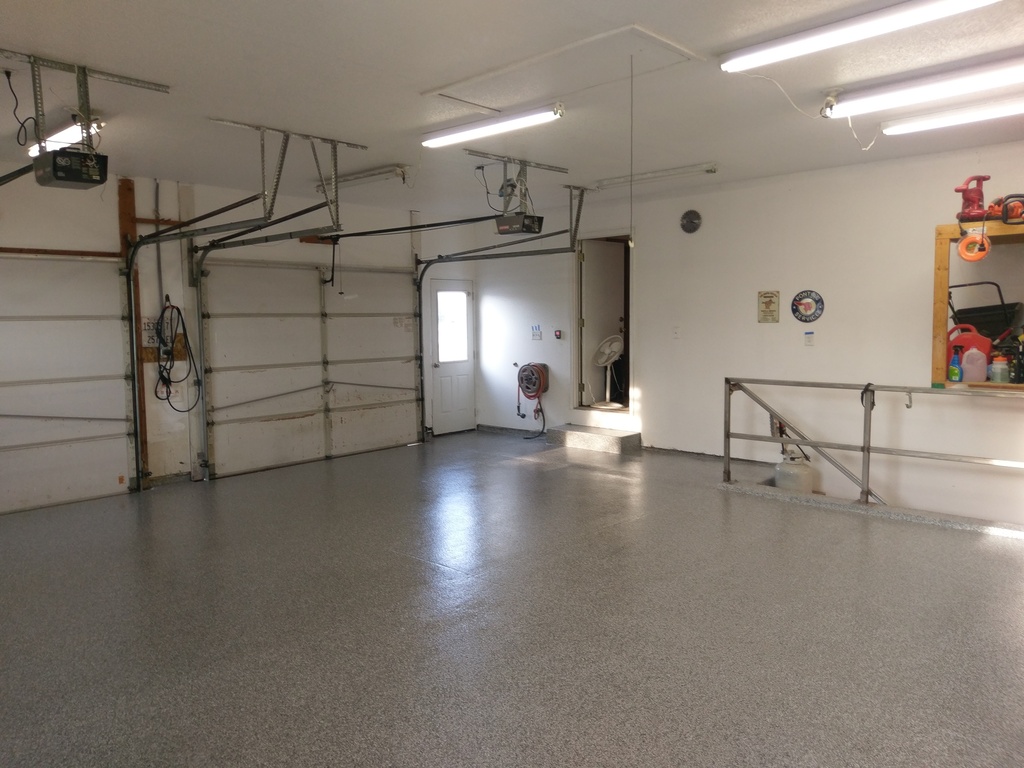

Well almost 2 years to the day since this was installed and its holding up great. No chipping, no yellowing and still super easy to clean.

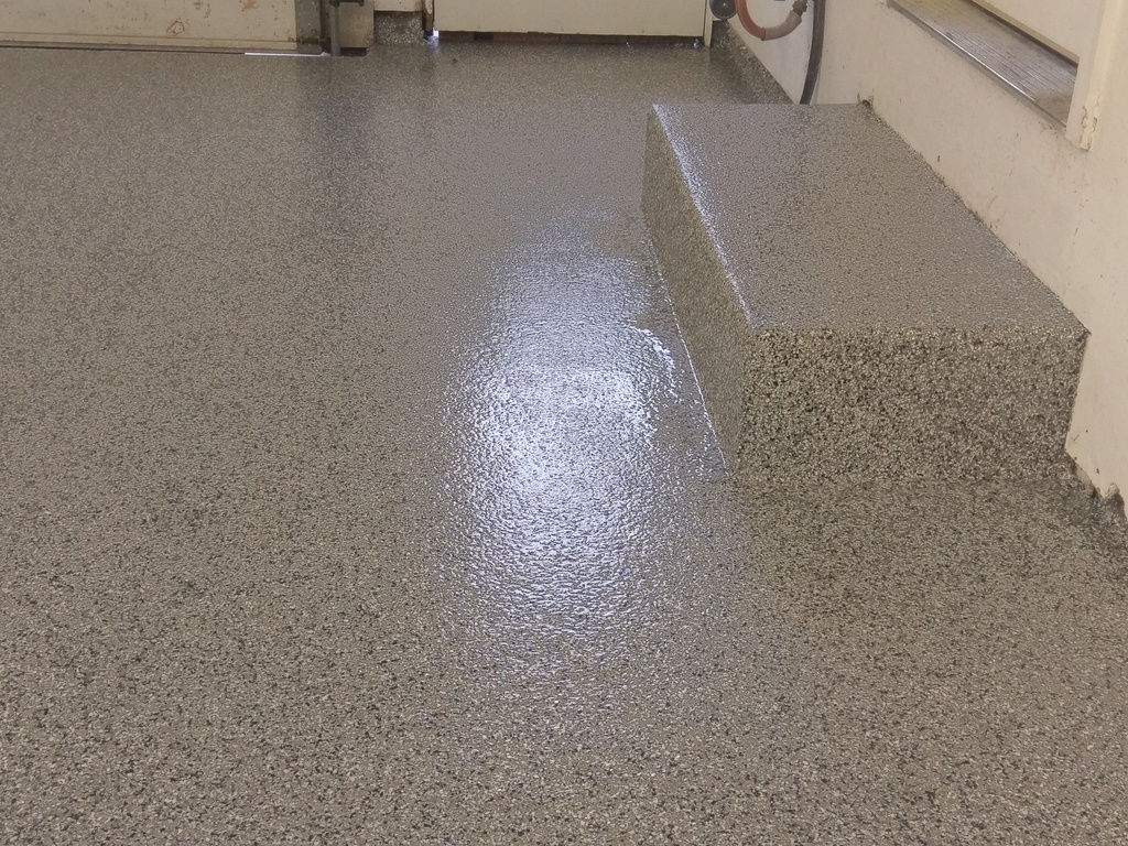

Year 3.. The floor looks great still, cleans up well and has taken some abuse with projects I have been working on. If you get the right light you can see just a bit of yellowing however its very minor and no one notices besides me. Its been really scratch resistant, and so far held up to welding sparks without a problem.
