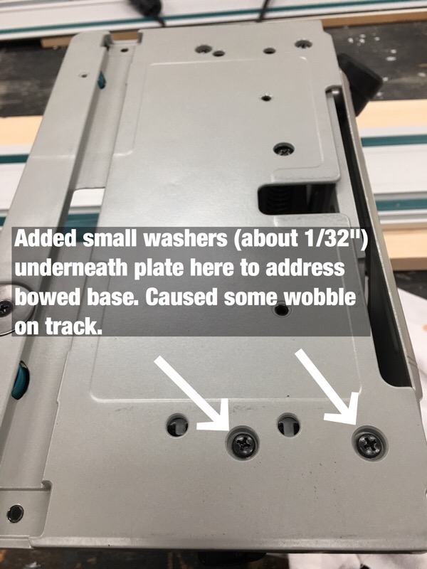

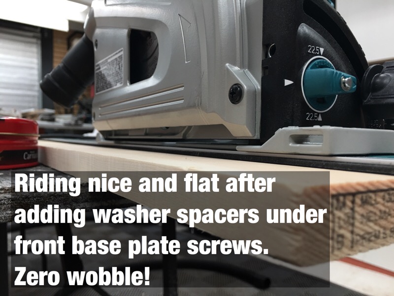

Before firing up the saw, I carefully checked the blade to see that it was square and true to the base. The saw base had a small bow in it which was also reported by a few other customers in reviews. This bow resulted in a slight wobble on the track, so it needed to be addressed. I fixed it by removing the saw base (four screws) and shimming the front of the plate up about 1/32" with two small washers underneath the front two screws. The plate is pretty much perfect now. Makita should really make this a basic quality control check as it likely would affect cut quality if not addressed.

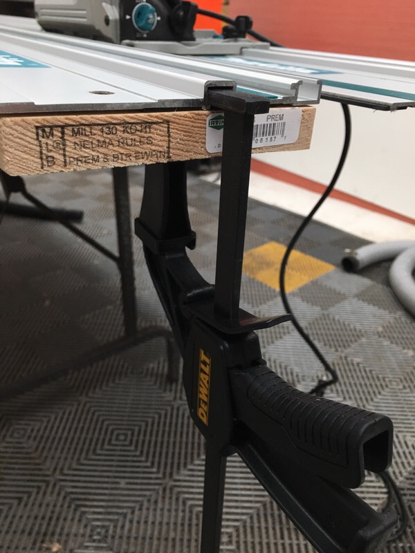

The Dewalt track clamps are very nice. I did not use the clamps at all making the cuts on the laundry room torsion box "test" panel at the end of this post. Gravity and the non-skid strips on the tracks held them in place nicely while cutting.

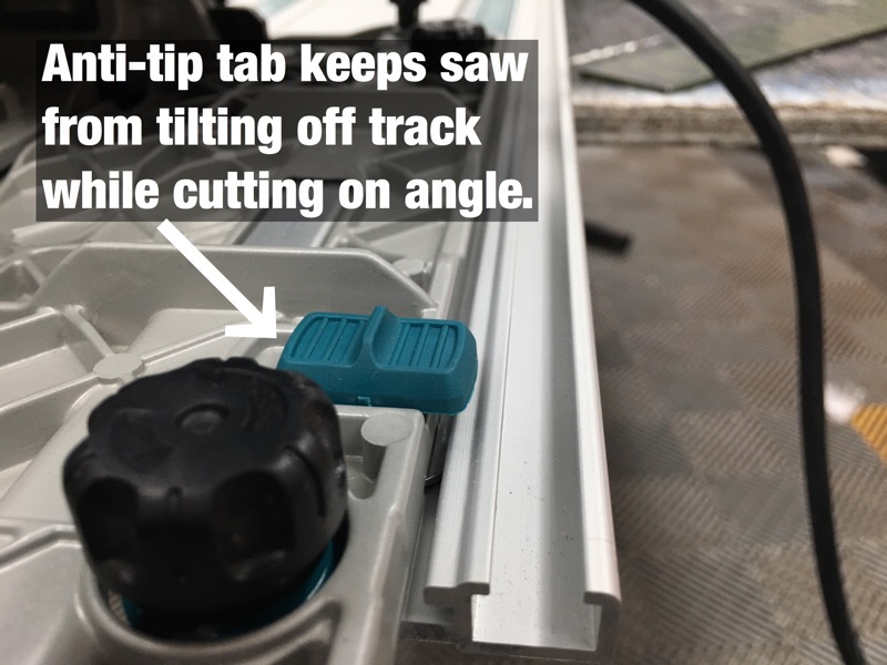

The instructions really don't explain how to square the base plate to the blade, or adjust the 90 degree setting for cuts. If you remove the base plate, you can figure this out..but these pics should help.
After some tweaking the base is pretty much perfectly flat.

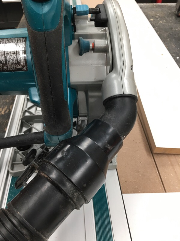

Dust collection is excellent. Trying a cut without a hose connected filled the area with a surprising amount of dust in a few seconds of use. With the hose connected, there is virtually zero dust :)

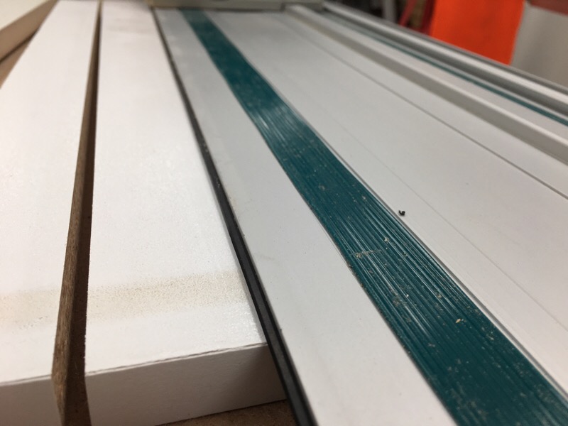

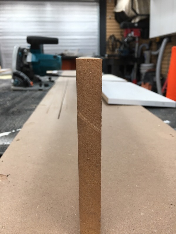

A few test cuts on some scrap melamine show that the stock blade, set up properly, provides pretty much perfect cuts. The edges are sharp (don't slide your finger down these!), clean and laser straight.

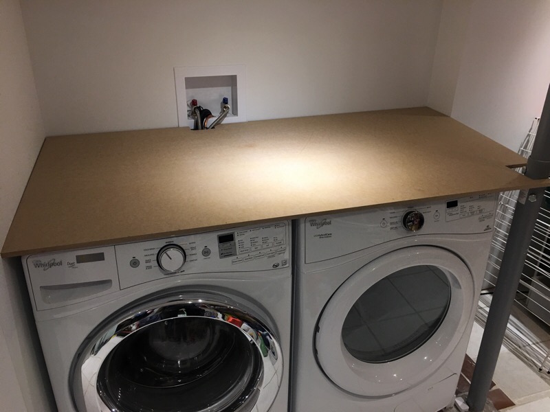

This is the first panel cut with the track saw, and test fitted after using the "tick stick" method (a few posts back) to transfer the irregular shape to the material. This panel is one of four that will result in a clear span torsion box counter top over this new laundry area. It was ridiculously easy cutting with the Makita track saw! Dust is pretty much zero with my small Dust Deputy cyclone setup. Cutting the panel took only about 5 minutes once marked out using the tick stick template I made a few days ago. Fit was perfect..no adjustment required.

I rarely use the track clamps, but for critical cuts (like trimming torsion boxes I had built) the clamps give extra security. Dust collection has been flawless.

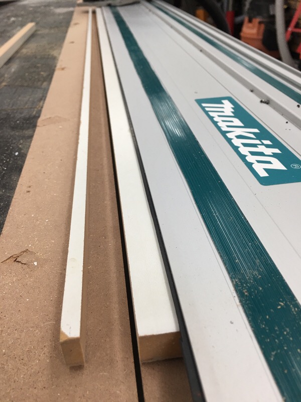

I've been using a very simply to build but just as accurate shop-built versions for 30 years or so. It's probably more accurate actually, since the guide edge you create is actually formed by the cut being guided on the guide edge using your particular saw and blade!
Plenty of instruction online, but it's basically 2 layers of Masonite laminated together, then ripping off the bottom layer with saw that is guided by the narrower strip you just glued on in the first step.
The newly ripped edge can now be lined up on any straight line, clamped and ripped and you EXACTLY the placement of the cut edge because it will match the edge you just formed when you cut off the excess width in the previous step.
I've been using 48" and 96" versions of this in my sign shop for 30 years or so.
