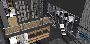

Priorities vs. Responsibilities vs. Everything Else
Plan A:
The initial plan was to build the hangar out into a modern industrial style loft space but it would take me many years to complete it the way I want: polished floors, mix of corrugated metal and concrete wall panels, tongue & groove ceiling with exposed steel trusses, commercial kitchen, glass garage doors, polycarbonate windows, and glass walls with a few cars parked inside!
Basically a garage condo combining a dream house and dream garage. I even modeled the entire proposed build in 3D using Sketchup...
Then reality sets in. I started creating a budget for everything proposed. Then compared that budget to what I can spend. I estimate it would take 3-4 years to complete the build while living in a tent eating rice twice a day. Nope, not happening yet!
Plan B
The most logical thing to do is build the hangar out for income. With a background in photography and having rental studios before, it only made sense to turn this into a rental space for photographers, film, and small gallery events. Plus, I can use the space for installing vehicle graphics on larger vehicles when it's not occupied.
So Plan B it is!

GTFO. Your dream renderings were the exact vision I had for a commercial space I lusted after but was not for sale. Awesome that you're local-ish! What part of town is this in?

I’ll PM you in effort to make it slightly more difficult for the internet to find me lol!

Impressive. Love the rendering of plan A, hopefully that'll materialize
Thanks! I went back and forth for months on this. Decided I didn’t want to get a construction loan and the time it would take for me to collect all the materials and built it out would render the space useless for a few years. I’d rather have an additional source of income vs. what would feel like a never ending project lol!

I like where you're heading with this now, and the current doors sure do look much better than the previous ones.:thumbup: Looking forward to your continued updates! :)
