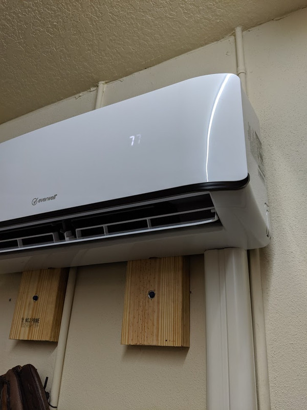

Long over due update, last year I installed a mini split finally.

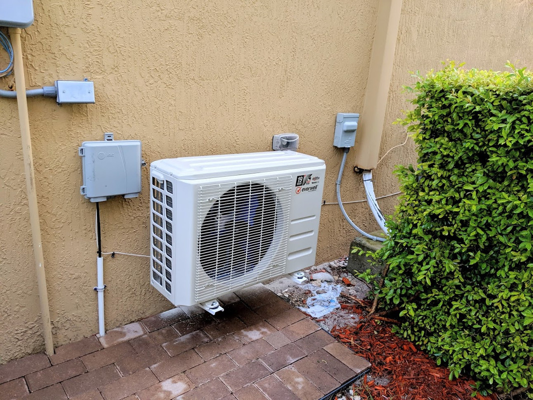

I picked up an Everwell 1 ton, 220v unit in Miami for super cheap. It is basically a Mr.Cool style unit for $450. Includes the lineset and comes pre-charged.

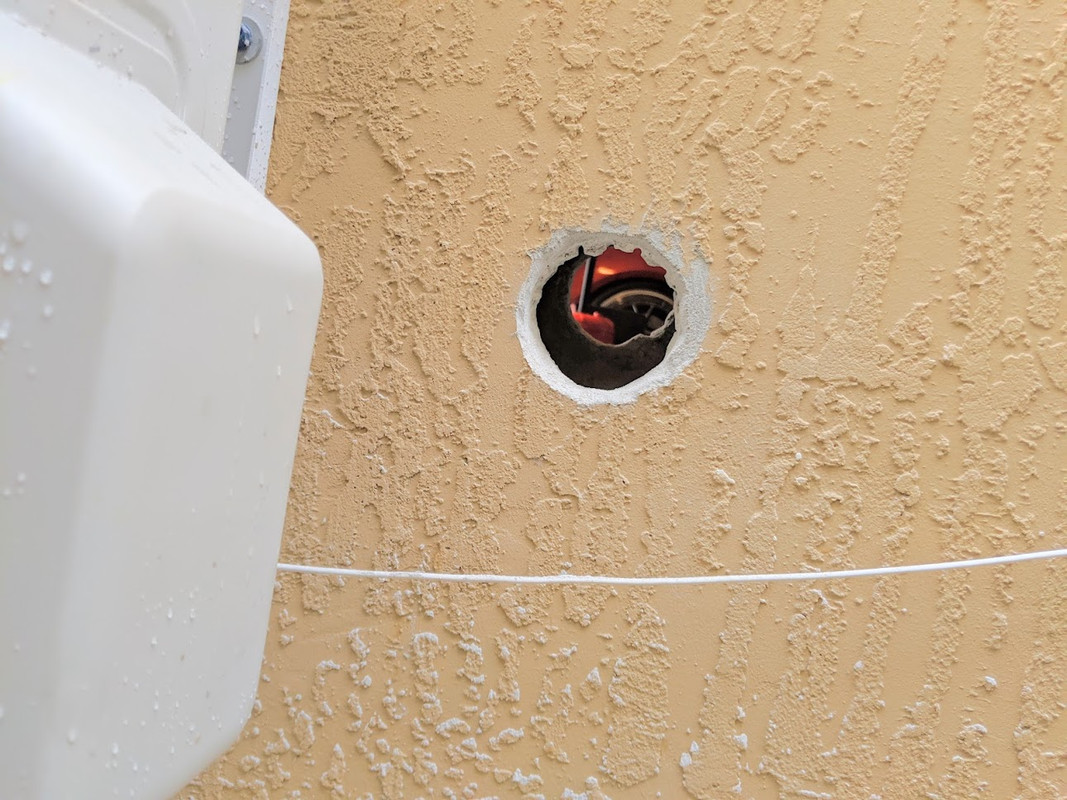

This was the 2.5" hole I needed to drill, I decided to make the hole lower instead of directly behind the inside unit because I wanted the outside wall to look cleaner, I didn't care about the lines being on the inside wall. Added a 15A 220V breaker, ran some lines in PVC conduit and mounted the disconnect outside and it was all fairly easy.

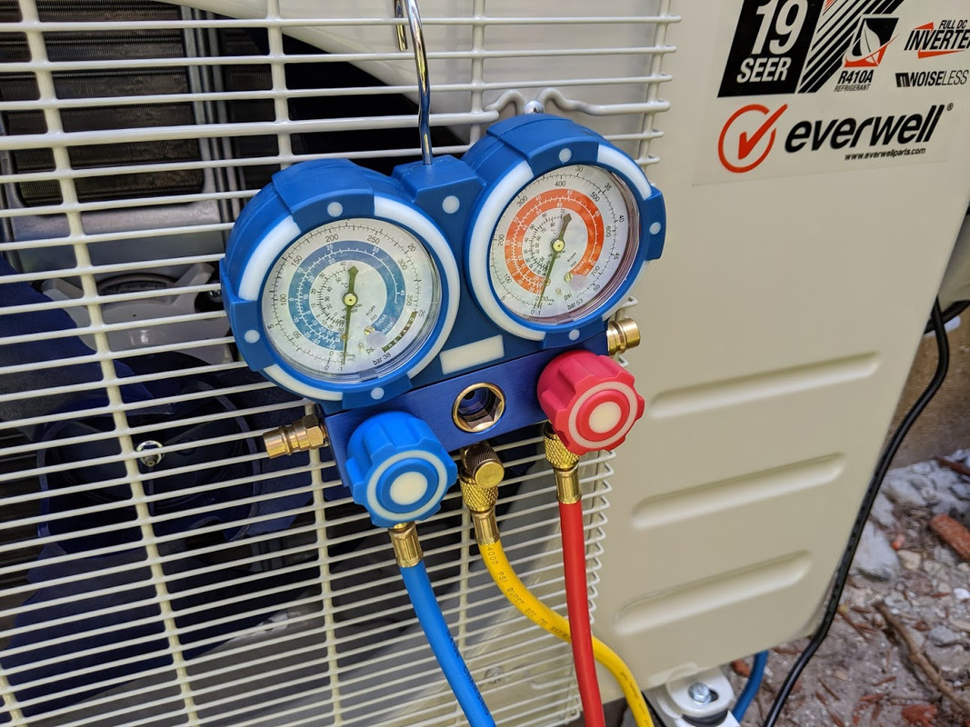

After not having any luck calling an AC tech to evacuate the system, I bought a gauge set and pump from amazon and did it myself.
In the south florida heat, it has been a god send, I can actually get alot more done.
