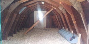

all buildings had dirt floors, the attached garage was very heavily built out of spare timber from jobs the PO had done (a carpenter), and due to the size and length, and due to several major problems with the house layout, it was decided to take about a 3rd of it and convert it into living space, losing one garage door.
This move solved all problems with the house, and allowed expansion access to the loft from inside the house if I wanted to turn that into living space in the future as well.
couple of pictures of the initial layout of the attached garage. The attached garage had originally been an open sided horse barn, and covered a basement bulkhead and a stair up to the loft

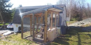

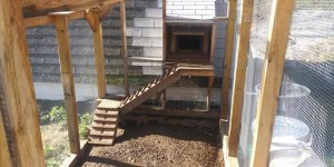

After flailing about a bit when I first moved in trying to work on everything at the same time and getting nowhere, I wrote out an extended list of how each building would get improved and in what order, by order of necessity. Trying to stick to this has been a challenge. The principle problem I had, was that I couldn't really put anything in them because they were so primitive.
I was trying to condense a commercial condo full of stuff from my business, and my personal family stuff into these spaces, and it just was not going to happen stacked on wet dirt, I needed concrete.
I was most excited about the brown rotten shed and liked the design. It had eave doors that could be opened and pinned, and with the garage doors open, there was a great breeze through the structure even in summer heat. I loved the half sunken foundation, and the potential to add a second story that could be driven into was there. First order of business was to clear out all the rotted stuff left in there by the PO

Much overdue update, mostly ive been finishing interior house bits over last two years, not much work on garages. (Small child work suspension)
The few things i did were decide to knock down the red building becuase was just too poor condition, and not really usable, and small white building i converted the second story into an ample chicken coop. Plans in the works to double the run size, estimate it can hold more than 20 chickens comfortably, but the run is just way too small for that
Couple attached images of the chicken coop shed conversion. I made this way more complicated than it needed to be, so now after a year of experience with the little beasts in residence, will make changes to do things just right.
