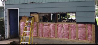

Termites the other Carpenters. Well I guess I never really knew how much damage termites can do. My dad who is 87 was pulling the siding off his garage. Told me that he has a small termite problem. He had the siding pulled off and one sheet of plywood. What I saw was let’s just say bad real bad. From what I could see the termites had eaten 95% of the sill and just about every stud up roughly 2'. Kept telling him its bad and it was going to be a lot of work to repair.
Brief history, the garage is about 40 years old. Did not have a pressure treated sill. Full frost wall with the area under the slab set up for a passive solar heat storage. 2x4 walls with sheetrock on the inside plywood with 12” wide Masonite siding. The wood walls only is about 4” from the ground.
After seeing that the studs were not supporting much behind the first plywood sheet he removed first thing to do was brace the wall up from the inside. Next up was to strip the outside wall. The bottom layer of plywood was removed, and all the insulation was removed. As you can see in the pictures I don’t know how it was supporting the roof.
I know you guys like pictures so I will be posting the repairs.

Few more pics of what was found. We decided that we would try and work with the Sheetrock as opposed to ripping it all out.

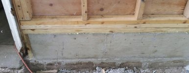

Raised the concrete wall by 10 inches. Used the old plywood to make a form for the outside wall. Used 1/2" pvc sleeve to slide a 3/8" rod through to the inside plywood. This will allow me to slide the rod out after the pour. The concrete mix was a 5000 pound mix with an additive for extra strength. A ******** was used to get rid of any air.

Sill seal installed with new pressure treated plate. 1/2" bolts securing the new wall in place. New studs, insulation and plywood glued and nailed

Back wall work included removing the bottom sheets of plywood, cutting all good studs back 15-1/2" and cutting the balance of damaged studs 6" above any sign of the damage.

Concrete form work. The concrete forms are only 3.5" thick. The concrete used is a custom blended mix that is incredibility strong. The concrete has a super plasticizer for superior strength.

Sill installed, studs in and insulation.

Bert_
Dec 24, 2016
9,876
NW Iowa
This was a bearing wall. I thought that it would be better to make a good bearing surface. Glued screwed and nailed. plywood on both sides of the joint to stiffen it up I dont think its going to go anywhere. On the back wall I did sister the studs in. I will have a few pics of that later today.
I'm happy to see other ways to do stuff. The only way I've ever seen it done is to cut the existing stud, cut a stud to fit tightly below the old one, and sister a new board alongside that spans the joint.

did you say this garage was solar? where is that?
nice job all around
The solar system is a passive hot air system. The garage foundation is 4' down with a 3" concrete slab that rest on top of the footing. the void from that slab to the underside of the garage floor is about 3'-6". In that space under the garage slab there are stones of various sizes from say 6" to 20". I know I washed and placed them there with my brothers a long time ago. So the way the system works is there is duct work that goes from the roof down to the bottom of the footing. The war air heats the rocks and retains the heat. This radiates up to the floor. During the winter I don't think it goes below 45 degrees in the winter time. And that is here in New England. Its old school but it works. I used almost the same setup up in a sun room in my house only It has a trombe wall. The stone area below the room is 8'x18' x 4' deep. But I got my wife to wash all the stone for that. With one small fan moving the air around that room does not go below 55 degrees during the winter as long as I do not go longer than 3 days with no sun. The no sun would be from snow building up on the roof windows.
