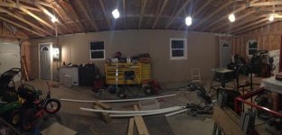

Thanks to the weather and a small electric heater I was able to get garage around 70 degrees to start getting some paint on the walls. Its amazing how much brighter the work space gets with a little paint.
