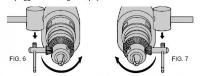

Not having much luck in getting the chuck off as there is no good way to hold the spindle from turning. There is an unmachined portion of the spindle which I have tried grabbing with vise grips so as to not marr the bearing surfaces. The head of the retention screw Item 76 appears to have been broken off.
Found a picture of the spindle on line, and from the thread pattern it clearly looks like the chuck should spin counter-clockwise as viewed from the chuck end. However, this is in direct contradiction to the manual instructions I found (Figure 7). I'm inclined to believe the spindle thread picture.

Did you remove the chuck retaining screw? I assume you did, in which case the technique is whack sharply on the chuck key as shown in the illustration. Most chucks I have seen are right hand threaded. The retaining screw is left hand threaded.

Which direction to whack the chuck key? The manual itself has verbiage to whack the key "counter-clockwise" yet the included manual Figure 7 clearly shows "clockwise". Meanwhile the threaded nose of the spindle from an Ebay identical part shows that counter-clockwise would be the proper direction.
I am still inclined to whack it counter-clockwise based on the spindle thread form from the Ebay part. This appears to also be consistent with other drill chucks.

I would put a large allen key in the chuck, give it good fast sharp whacks counterclockwise.
I tried this to no avail. The problem is the spindle is loose and the gearing is not in place to help react the blows/whacks to loosen the chuck. So it just spins instead of challenging the chuck/spindle threaded connection.
I used a vise grip on an unmachined portion of the spindle, tightened a piece of hex in the chuck, held the vise grips in a vise, and used a 1/2-inch pneumatic impact wrench - all that happens is the vise grips slip.
The retaining screw is a left hand cap screw near as I can figure for this model based on the part number. Looking in the chuck, the counter bore is visible as is the sheared off shank/former cap screw head.

The chuck is screwed on with a regular right hand thread only the little screw inside the chuck is left hand.. Whack the chuck key CCW. Now to get serious. If that does not do it, and I have come across a few, get out rhe impact wrench. Put on the largest allen (hex) bit that fits in the drill chuck, tighten chuck on hex key and "impact" off. That never failed to do the trick. After you get it off, be careful getting that broken screw stub out of the end of the spindle. You don't want to mess up the spindle. Add that LH thread screw to your shopping list; you won't get one in the hardware store. Reverse is still worth having, just to get a stuck bit out of the hole.

Tried the impact gun trick with hex stock - no dice.
Remember - in my case the spindle was free wheeling due to the stripped key, and no way to grip the spindle to stop it from rotating. Thus, using a wrench, whacking the key, using an impact gun, etc, just made the spindle go roundy round instead of challenging the chuck-to-spindle thread. Perhaps now that the key is restored and gear train engaged, chuck could now be removed via these methods; however I have declined to proceed down this path as the drill is back in business, no worse than its been for the 10-12 years I have had it.
