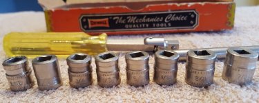

I have this ox wall set. Picked it up just because I liked the flex driver.
I have that same set somewhere around here.
Yes, the flex driver is kind of cool. Also WAY less money than a 4764 Proto! :lol:
The Japan-made knock-off posted by Cf mtn is the first one I've seen in the original container. Most of them I see have a different ratchet, though - with a fatter handle.
Oldtuleguy said:
Looks the same but no driver
Oxwall made a number of different sets - some contained the flex driver, some did not. I do not believe I've seen a Japan-made knockoff that contained a driver - only the ratchet and a 2-inch extension. Almost impossible to tell the Japan-made sockets from Oxwall.
