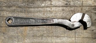

This came from a box with quite a few vintage tools. Most were nice. This is the exception, only marked 150 mm / speed wrench. It’s not what I think of when I think of a “speed Wrench”... I usually think speed handle for sockets. The construction is stout but poorly finished. Any ideas about who made it? I assume it’s domestic, because of the lack of country of origin.
Thanks in advance,
alton1911
29,592
that looks like an Asian-made knockoff.
I believe one of the earliest variants of that type was made by Heller. I could well be wrong.

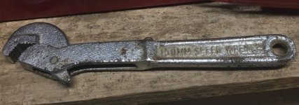

Interesting, I have one of those that was my dad's made by Weil and stamped Japan. "ADJUSTAMATIC". I always thought it was for pipes, LOL...
cgrutt
Mar 4, 2016
8,427
Here it is in Popular Mechanics ad from 1966.
Which fits when my dad would have purchased it. He even lived near Woodmere NY at that time, lol...
