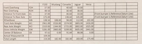

I’m installing this lift with an eye about 2-3 years in the future. My daily is a F150 Supercrew. If I intended to keep or drive something that size forever, I’d need to reconsider some things, and perhaps consider a diagonal installation - which would encroach on the activities of the bays on either side of my lift bay.
The F150 is temporary. Nonetheless, I’m factoring it into lift placement because, why not. I believe I’ve got the shallowest standard 3 car garage going, and that’s part of why I’m sharing all this. It’s reality for many of us in the ‘burbs.
What’s coming? I’ve got my eye on a 65-66 Mustang, maybe a 68-72 Vette. Other cars likely to make it on the lift: A Nissan Versa and the wife’s Jaguar XE. By considering the most ridiculously cramped vehicle in my plans (ye olde F150) I’m covering all bases.
I offer up my plans and research both to enlighten and to get advice....please chime in.
I cleared the center bay and lined up the truck. I ended up with maybe six inches clearance in the front and in the back with the door closed. There’s a clear shot to the ceiling between the lift motor and garage track. If I opened the door, I could get it off the ground for tire rotations, brakes, etc....which would involve scurrying in and out of the adjacent single garage door.
This exercise had two goals: 1) to aid in lift placement, and 2) to determine the center of mass for the truck. I put floor jacks on either side frame rail of the truck and lifted it off the ground at its center point. Before all this I had done some calculations to determine the center of mass of the truck....I’m no engineer, but I ended up fairly close in my math. I’m seeking this data for that Mustang and Vette as well.

Why all the fuss over center of mass? With a smaller car, you locate it on the lift based on CM and that’s that. But if you’ve pushed the limits and have little to no room front and rear, you need this info because the front wall is non- negotiable....good thing the truck is short term.
With tape all over the floor, I backed the truck out and started measuring. Looking at these lift platforms one would think center is center....but is that really so? As it lifts, the “center line” where all the bolts are and the scissor arms meets moves forward relative to the overall length of the platform. I compared the manuals with actual measurements I was taking. Wait, did I say manual(s)? Check out the two manuals included with the lift. Note that one version has only one extension, while the other (the one I have) has two, front and back:
The correct manual seems to have been gone over, tho the translation is still bad, and it sports measurements in inches, not mm.
I needed that accurate picture to try to identify where center would be at full lift....(I guess I’ll confirm this when I test fire it).
Blue tape marks center on the floor and what I believe will be on the platform at full lift. With all this, I began to slide things around with a 31” spacing between platforms. Tape shows the platforms within the rocker panel markings for the truck.
This is all good and well, but it’s just an informative exercise. Is optimum placement based on the truck the best thing overall? Am I sacrificing room at the front of that Mustang for the sake of placing this truck? I’ll do a similar exercise with some other vehicles to optimize it....we’re still a ways off from cutting, so there’s plenty of leeway here.
I need to get ready to test the lift. They move quite easily on the four dollys. I need to consider and account for any “tippiness” that may occur as they are tested while sitting on their dollys.
I’ve ordered a transformer to buck the voltage from a measured 248-250 down to 220 as recommended by Greg Smith. My question about these transformers sparked a debate in the electrical forum. Some say it’s not necessary because the duty cycle here is so short. I don’t mind the $175 to avoid any problems, real or theoretical. The point was made, however, that you want to be careful about not bucking it too low, as low voltage can harm the motor. I measured voltage at different times and sized the transformer to get me right in the middle of the recommended 209-231 volts. Beyond that, no one articulated any real harm that using one would cause, aside from the dent in your wallet.

If I had a deep garage - or if you do - a lot of this logistical migraine-inducing geometry could be skipped. At 19.5 feet deep, fitting a Mustang, Corvette, Jaguar XE, Versa....(and the F150 a coupla times before it goes) requires some consideration.
I’m still gathering measurements on the Mustang (don’t have it yet), and the Versa is off at college. The Versa is easy. Here’s a spreadsheet I’m using to find CM of each vehicle....some blanks need filling. Below that is a side view drawing of the garage bay with the platforms depicted in the floor. Each colored line represents one of these cars...a decent cross section of cars to come....A mark near the middle of each colored line indicates that car’s center of mass (CM). For the Vette and Jag, I see 30” of room at the front, about 20” in the back. A Mustang is nearly the same length as a Vette, but the weight distribution is quite heavier in the Vette’s ***. The Versa is a non issue.....Clowning around with the F150 indicates 5” of useless room front and back when on the lift.
The photo below shows how I moved the nearest platform back about 5” to make sure I have enough room to work on all the cars at the front. Being unrealistically over-focused on the F150 would compromise comfortably working on the cars. Looking back at the drawing above, you can see what that did to the F150 CM relative to the lift - it’s gonna be a bit off. Fine for a one foot lift to do brakes, but not for the full vertical lift.
I probably spent too much time worrying about the center point of the lift platform at full rise as it relates to the intersection of the scissor arms at rest, I think it’s irrelevant based on some reading. First, there’s the Atlas manual, for FWIW. Regarding placing the car on the lift, it only says to center the car on the platform, side to side and front to back. Out of curiosity I also checked the manuals for full rise scissor lifts made by Bendpak and Nussbaum. They say essentially the same thing....No concern is stated about the true center of the platform at full rise. All the manuals, of course, call for best practices and common sense.
I feel good about 30” of work room at the front and 20” at the rear for most vehicles. I need to confirm some Mustang measurements and then I’ll be ready to chalk the lines to cut, with a system test slated as soon as I get the transformer in and some hydraulic oil.
