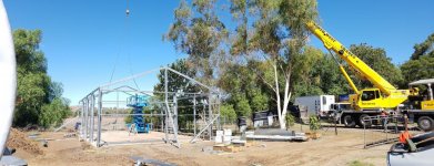

Construction began this week! Monday was raining but it didn't stop the guys from Ranbuild getting stuck into it.
The big crane they got in to lift on the roof trusses was pretty cool to watch!
Getting exciting :D

Tada, we have wall sheets, followed by gutters and doors. There was a slight mixup with the order and the end wall sheets were sent incorrectly (early in the order I changed the shed from 10deg to 20deg roof pitch, and the end wall sheets weren't updated in the spec). The longer sheets are on the way and will arrive early next week :)
The colours I went with are Shale Grey (Roof, Walls) and Basalt (doors, gutters, barges).
