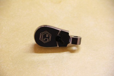

Also,
the Matco head has "88" inside the Matco symbol,
but doesn't list COO anywhere on it.
I guess I'll assume USA, or maybe Taiwan unless someone says differenly.
Action feels great, and this is the type of ratchet with the little floating latching piece inside.
The Capri handle has COO listed as Taiwan, and a 159 ft-lbs rating on it's hanger card.
It feels quite nice,
has a spring loaded ball bearing to lock the head into position (which even my Snap-on FDLB 3/8" breaker bar is lacking)
though there is an Amazon review showing atleast one broken one.
I like it so much I plan to build a second one and not bend the handle on that one.

I was going to attempt to drill out the center of the bar for a spring and ball bearing,
but was (very) pleasantly surprised it already had one.
The check ball is fairly large and has great "action" with the new head.
I did have to clearance the outer edges of the handle receiver to allow the new head to fully flex without hitting
ball and clearancing should be visable here:
Instead of using a lockwasher in the recess on the side of the head,
I used a small O-ring & stainless washer to apply side pressure without digging in as a lock washer might.
Oil could effect the O-ring over time, but I can always replace it, or go to a lock washer as originally intended.
So far the way it is now feels much better than the other swivel head Matco's I was already using.

Kinda cool, I'm actually in the market for a new 3/8th flex head, think this is the best ratchet for the money? I've already got the Capri breaker so might be kind of a fun little setup
As noted above, the inside of the Capri bar had to be clearanced a little bit,
to allow the head to fully pivot.
Contact was on the top inside edges of the bars opening when the head pivoted too far forward, or backward.
Not much had to be ground off, but I'm sure the chrome is gone in those 4 small locations now.
Either way, it was tough to resist buying the Matco kit for $25. :pimpflash

I had bought one of the ratchet heads in december for 30$, same seller. Put it on a S-K flex head torque wrench, had a 36 tooth Craftsman head on it. Works nicer now.
I really like the action of these heads,
time will tell how durable they are, but the build quality seems spot on.
I had only seen the 'floating' style ratchet mechanism
(floating clicker inside the head that ratchets against the main gear) in less expensive heads.
Most of my "good" stuff is older now so maybe that explains why all of them have their ratcheting mechanisms solidly attached to the switching lever, and not floating
(^not sure if this is the best explanation)
I find it a bit amusing that a thread about putting a Matco ratchet head on an inexpensive handle doesnt get blasted like the thread where the OP was going to put a Snap-on handle on a HF breaker bar. Must be a Snap-on thing. I find it interesting to see what can get adapted to work.
Yeah,
I saw that thread too,
maybe that was seen as more "badge engineering" like putting a Ferrari badge on a Hyundai,
and this like finding Ferrari drivetrains cheap and gutting a Hyundai for parts to make them work.....
or not :lol:

What is the width of the ratchet head at the swivel point, wondering if some breaker bars I already own would work?
