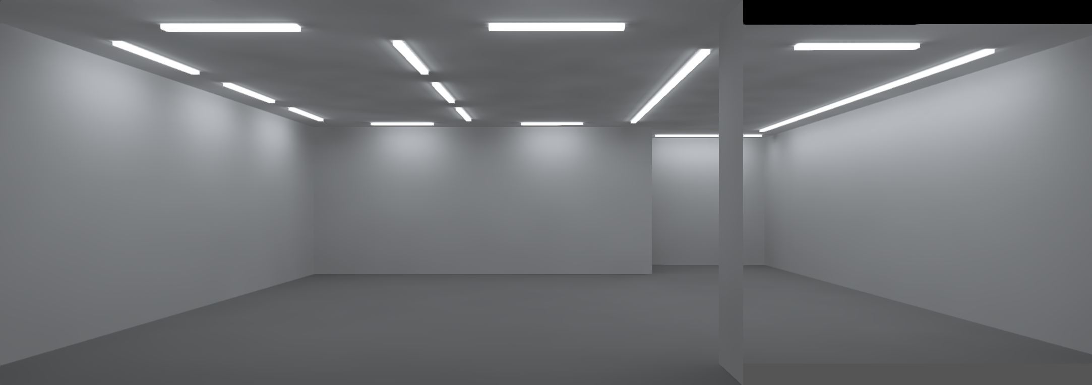

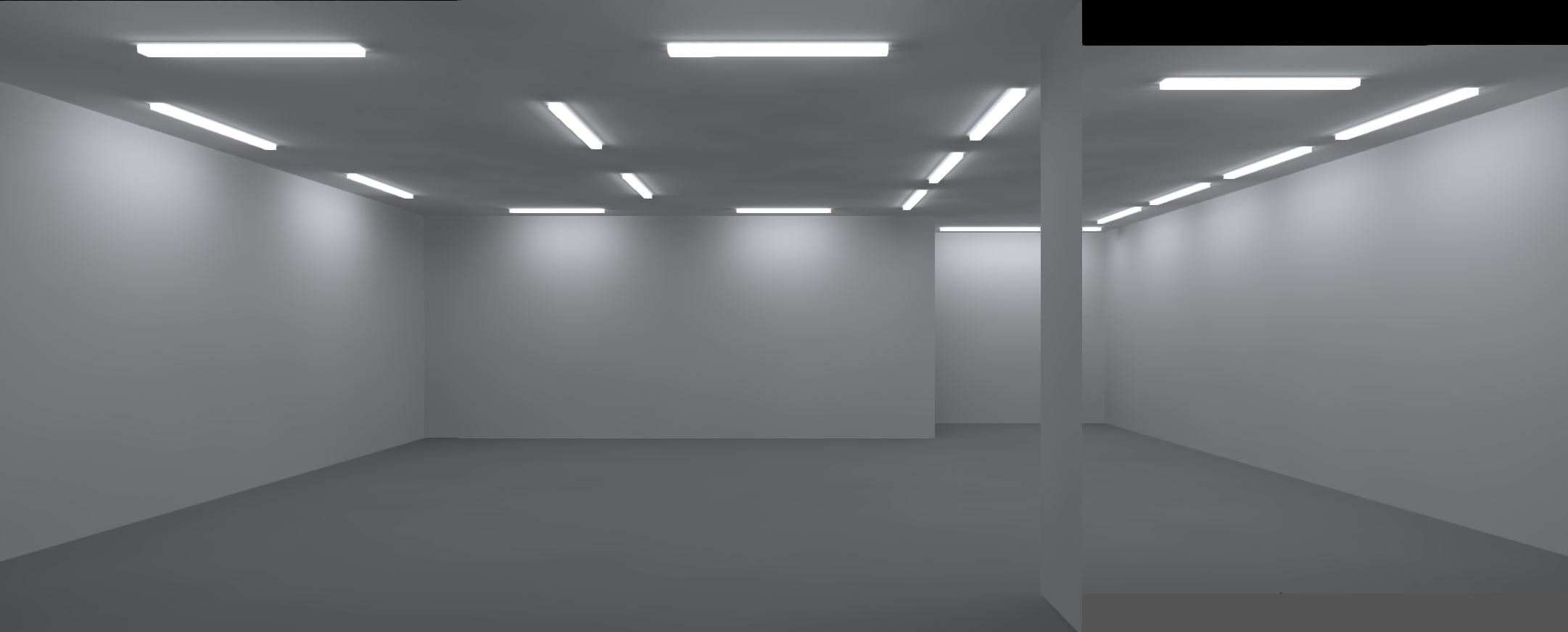

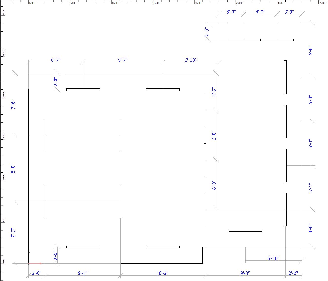

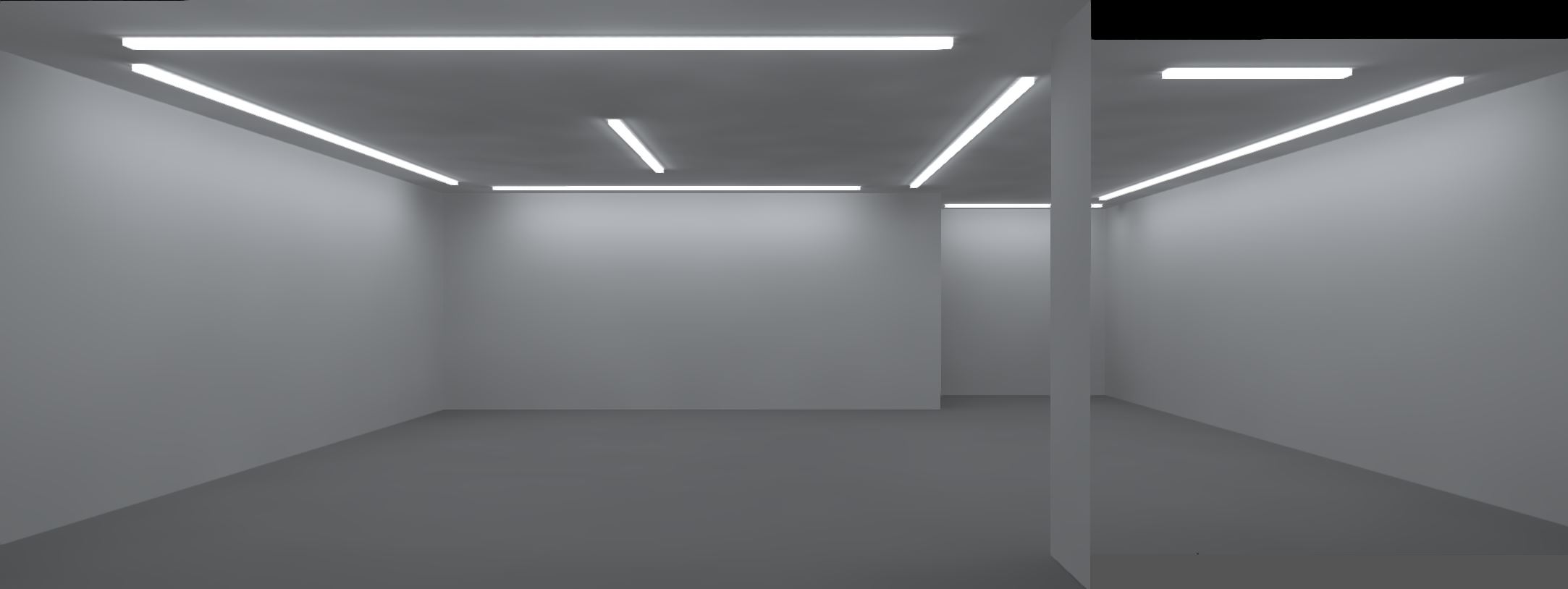

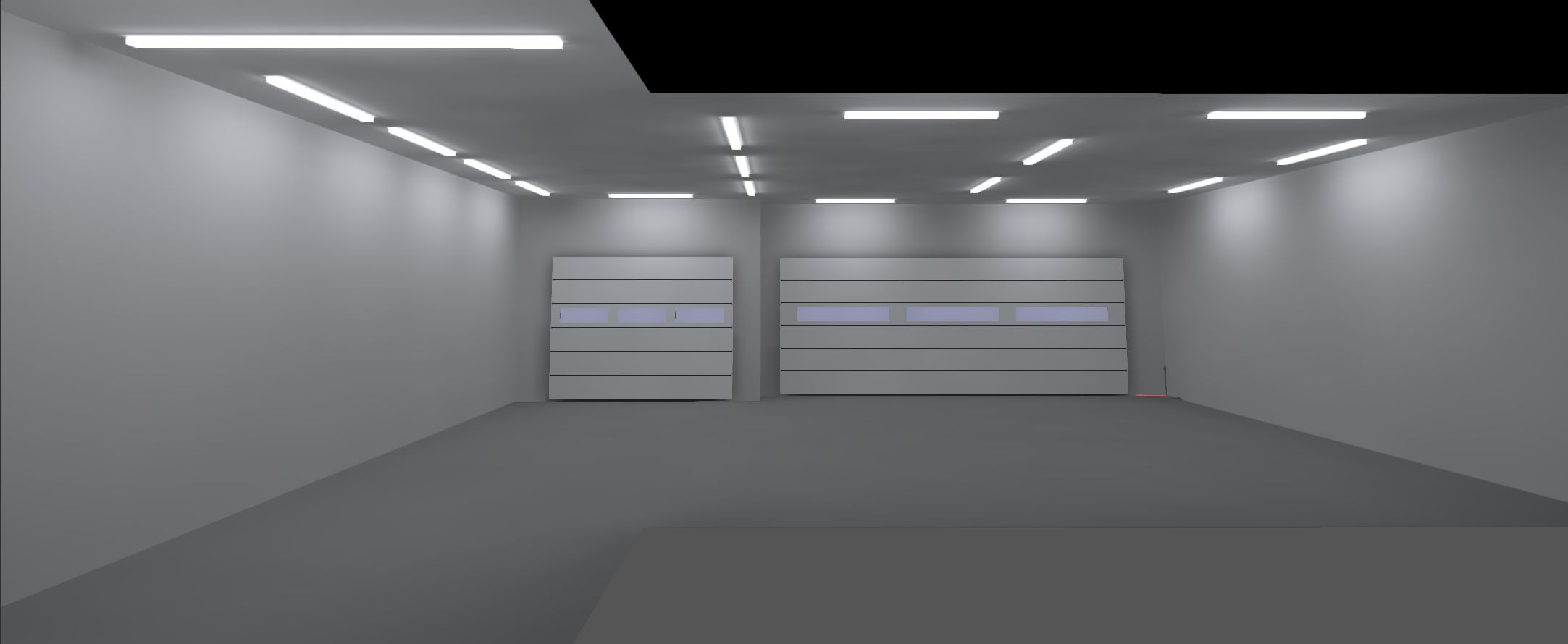

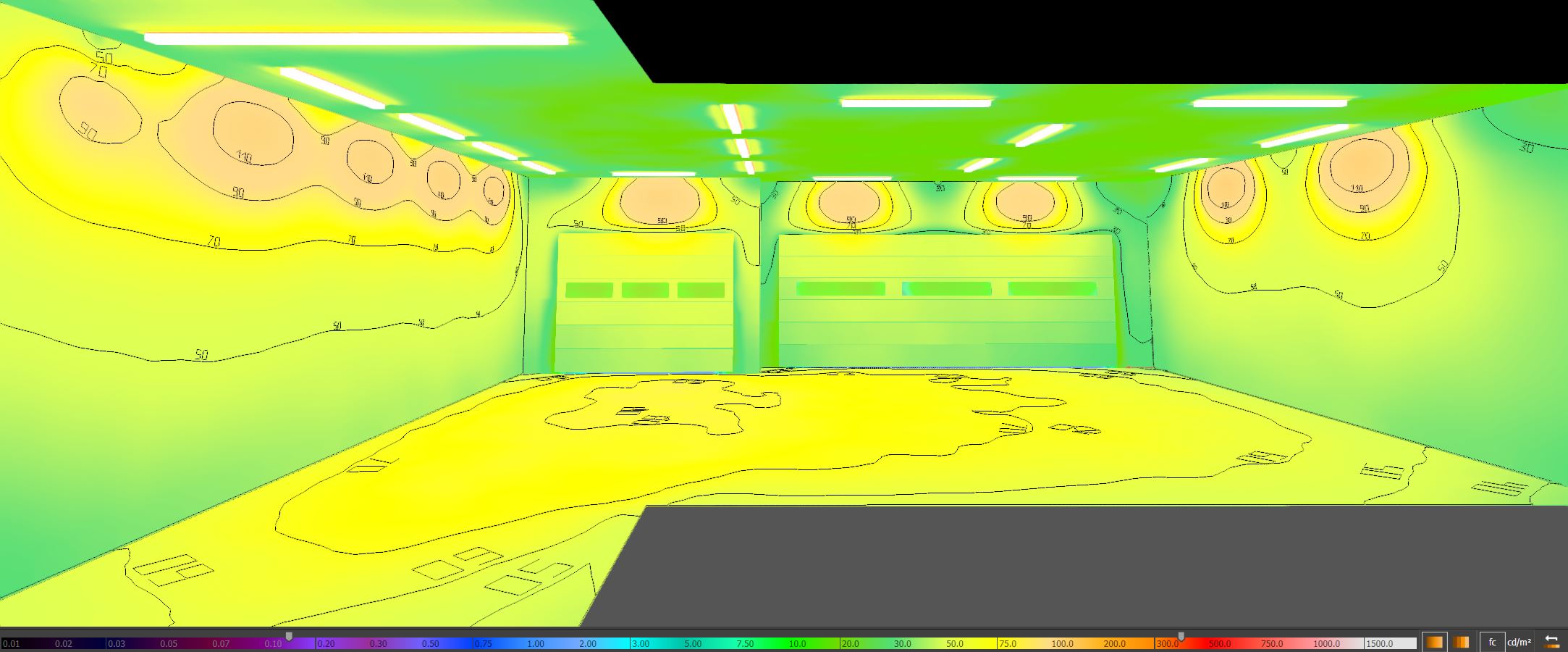

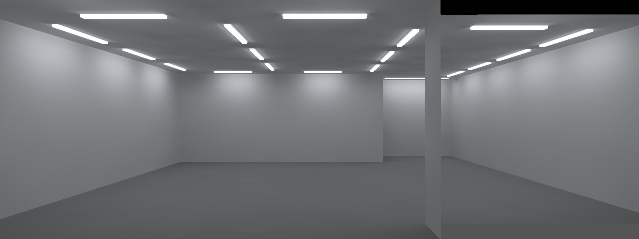

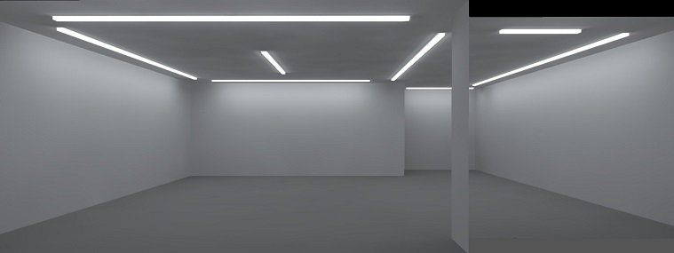

Platonic Solid
Nov 29, 2014
3,587
CT-USA
34 x 24 x 10
Qty.18 Fixtures (linked to Dialux Report)
Avg footcandle whole space = 74fc
Avg fc in 3rd bay = >80fc
Avg fc in bays 1+2 = >70fc
Cost: 4ft 2-Lamp Strip Light: $26.88 x 18 = $483.84
Qty.20 Fixtures (linked to Dialux Report)
Avg footcandle whole space = 83fc
Avg fc in all bays is the same.
Cost: 4ft 2-Lamp Strip Light: $26.88 x 20 = $537.60
Qty.22 Fixtures (linked to Dialux Report)
Avg footcandle whole space = 92fc
Avg fc in 3rd bay = ~100fc
Avg fc in bays 1+2 = >90fc
Cost: 4ft 2-Lamp Strip Light: $26.88 x 22 = $591.36
Qty.26 Fixtures (linked to Dialux Report)
Avg footcandle whole space = 107fc
Cost: 4ft 2-Lamp Strip Light: $26.88 x 26 = $698.88

Well here is an update - house is finished - we move in tomorrow!
Garage turned out way better than expected. Can’t believe how much light I have in my garage for just under $400... couldn’t ask for anything more!
Here is a quick pic I snapped with my phone. Once we get settled in I will post better pics.
