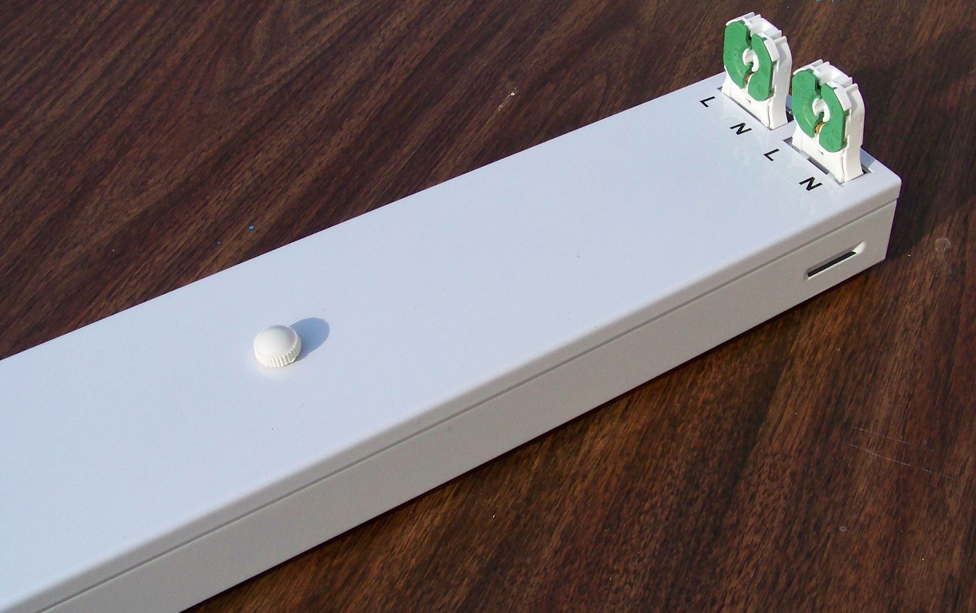

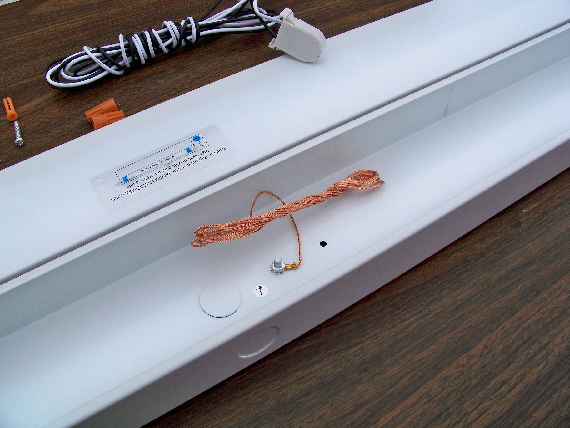

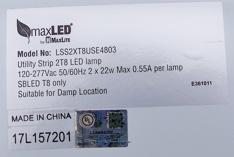

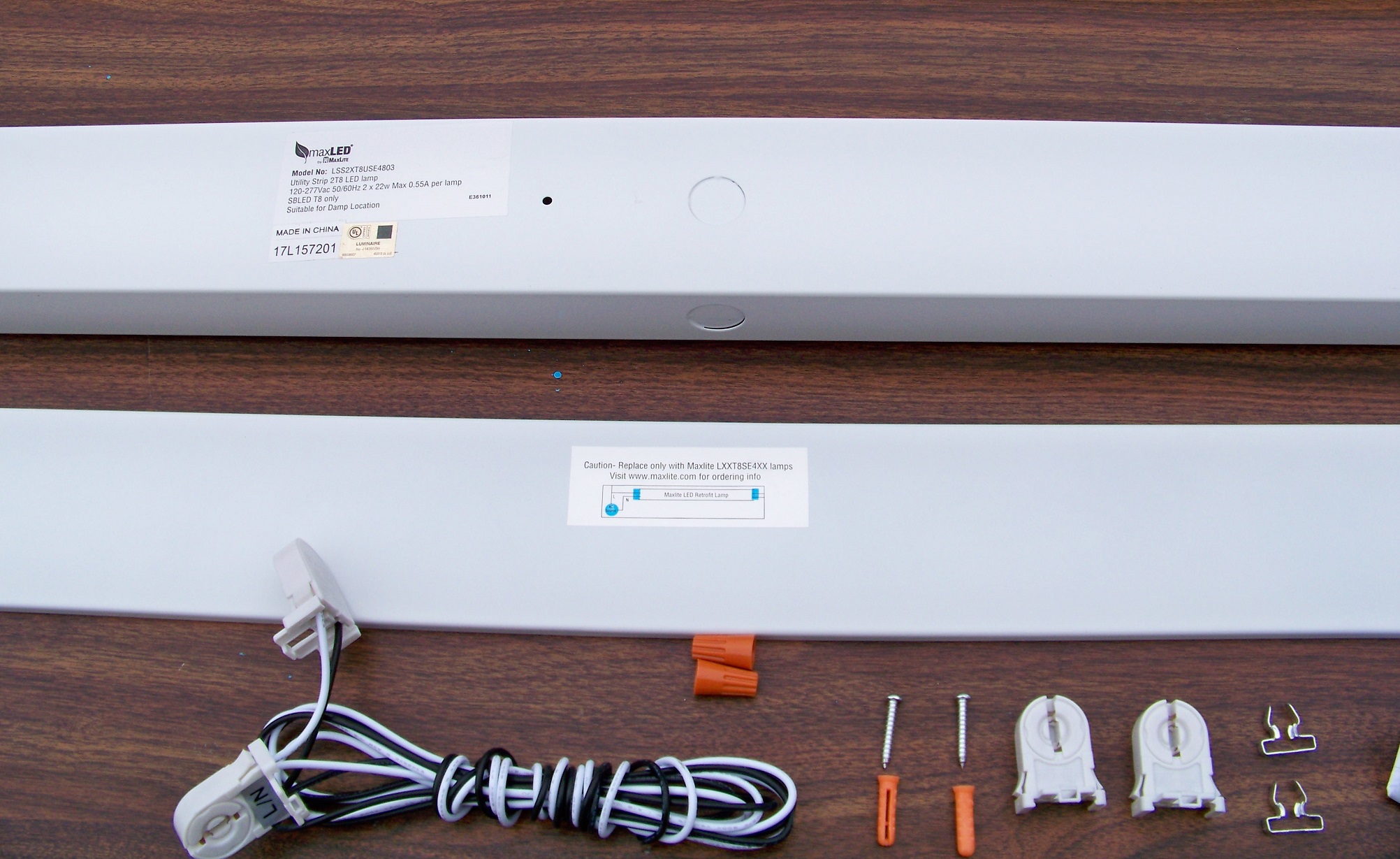

Maxlite LSSXT8USE4803 4' 2-Lamp
Maxlite LSSXT8USE4803 4' 2-Lamp LED Ready Utility Single End Powered Strip Fixture Review
(most images linked to larger views)

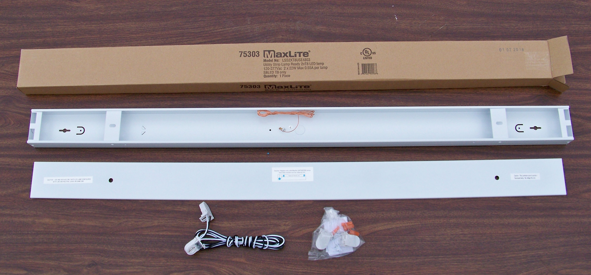

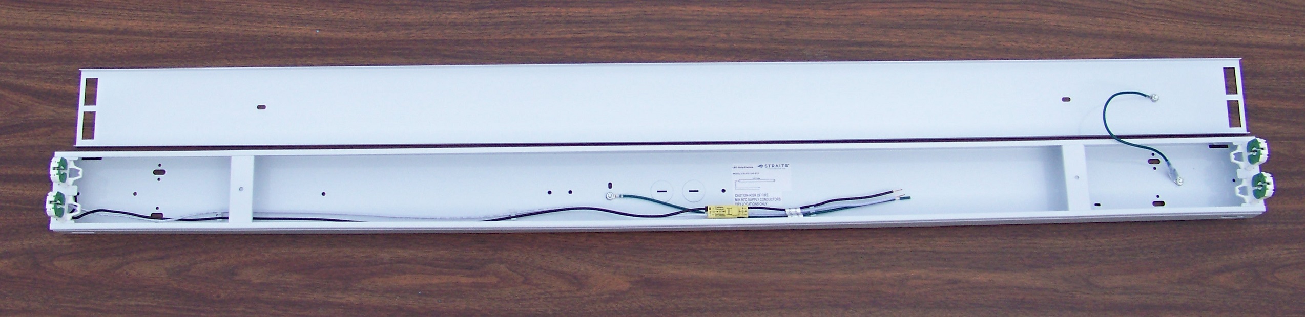

Assembled fixture Weight without lamps = 3.97 lbs.

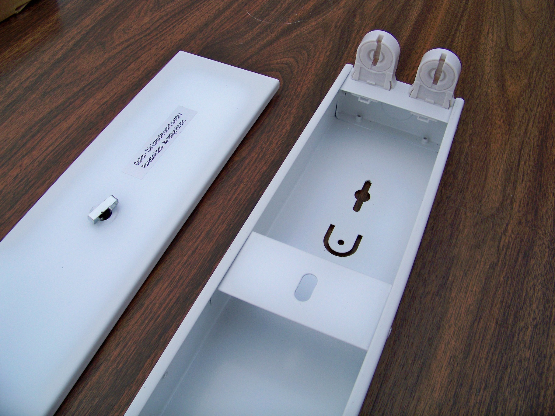

Measured Housing = 48.12 x 3.32 x 1.67 (not including lamp holders) 2.92 (with lamp holders)

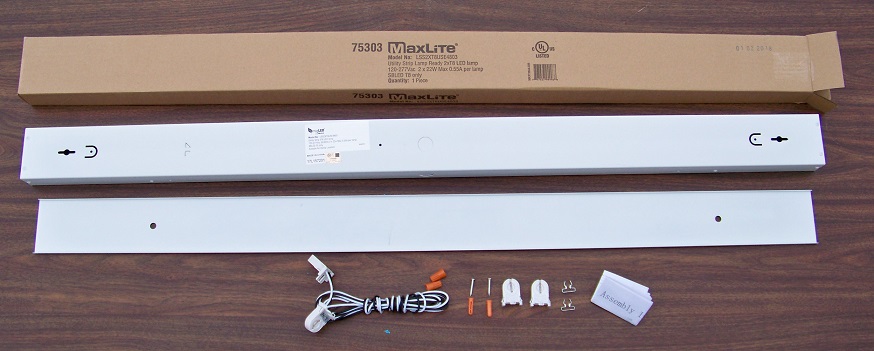

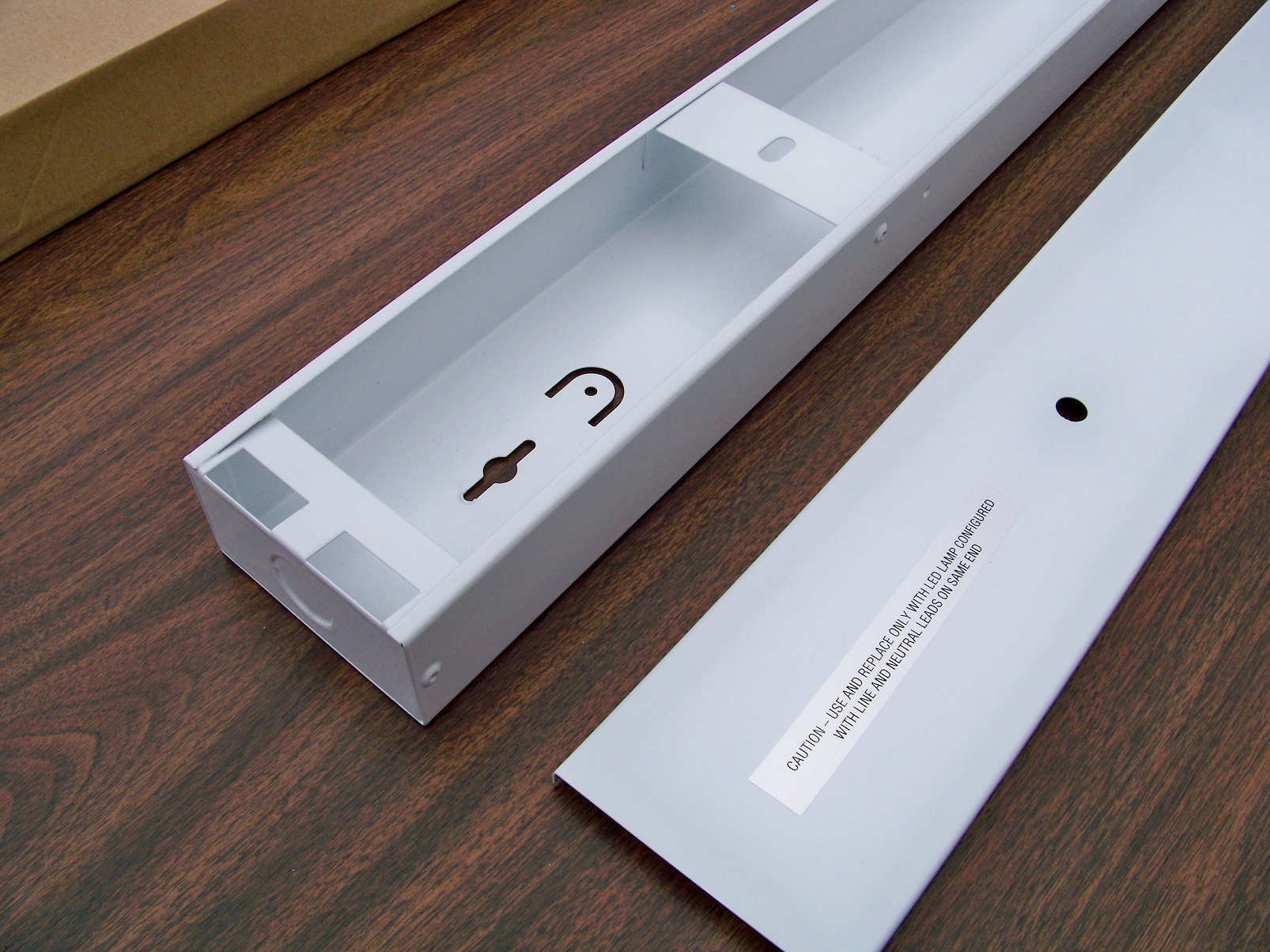

Housing material: 24 Gauge (0.024) Cold Rolled Steel finished in white baked enamel. The paint job is thorough and there are no sharp edges or burrs.
Housing back and bag contents.

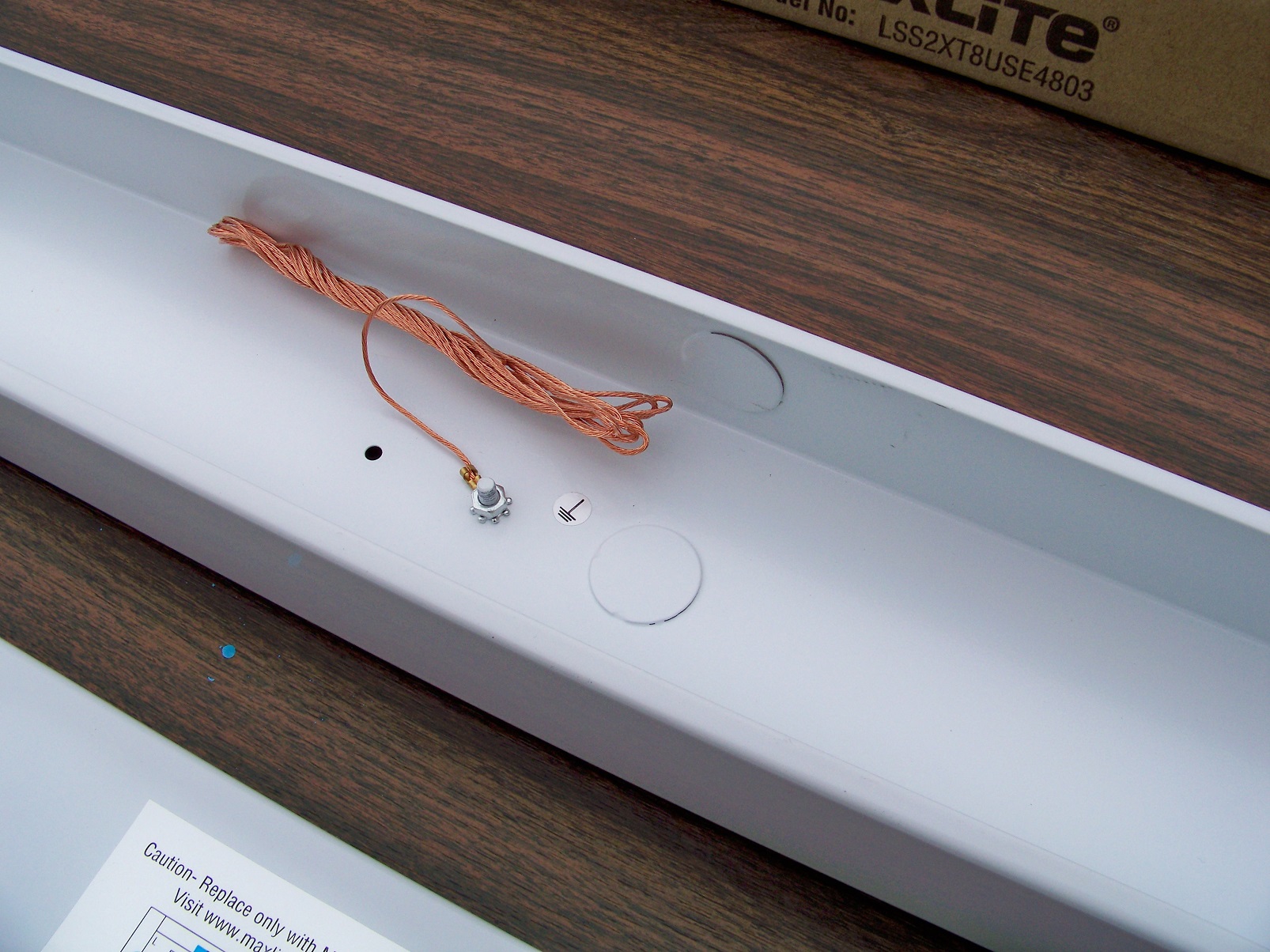

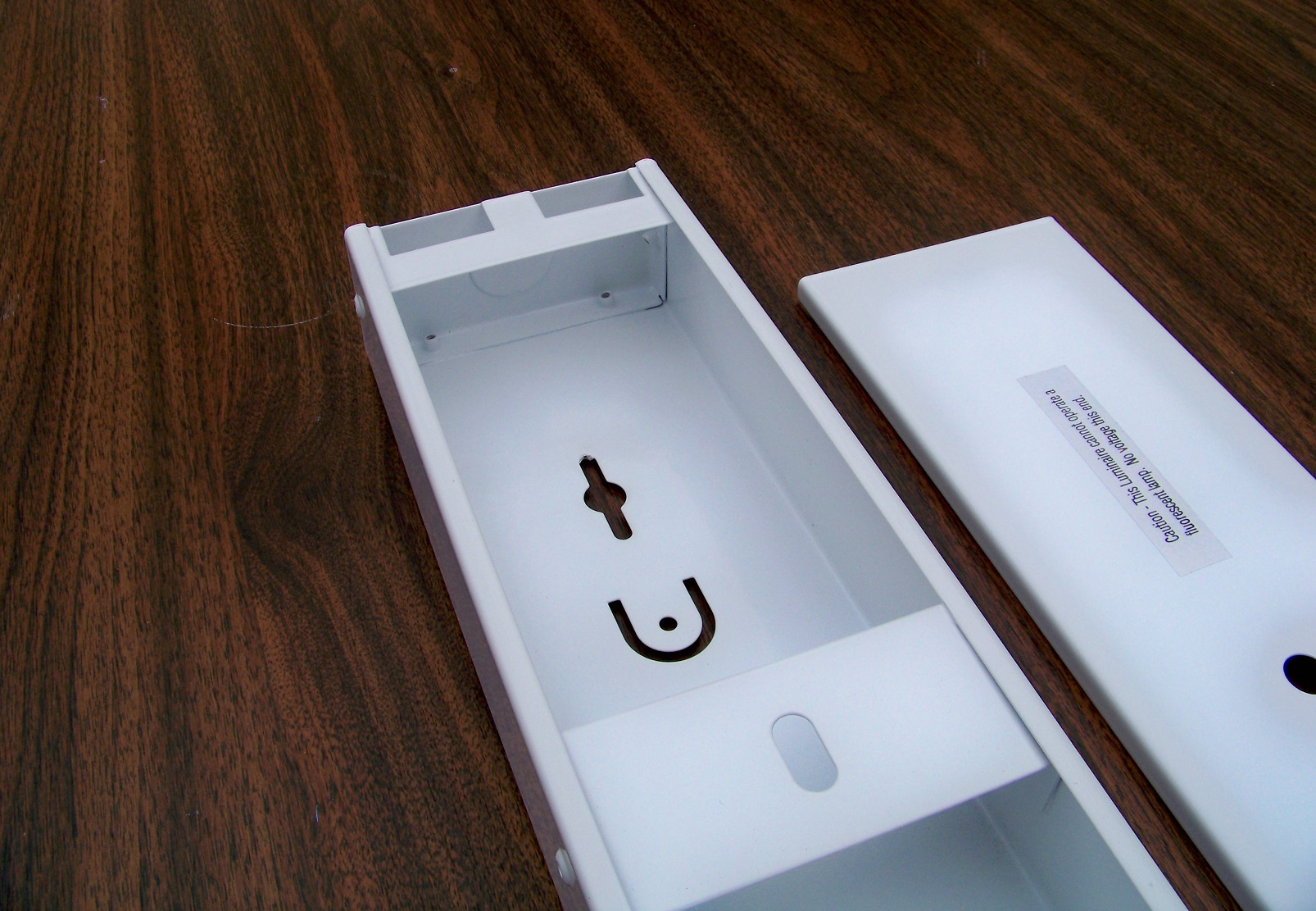

Since the fixture ID and UL labels are on the back, once you surface mount the housing you will no longer be able to see them. This could be an issue with building inspectors as they are supposed to be visible after fixture installation. It’s OK if a cover has to be removed, but you shouldn’t have to remove the entire fixture. I did bring this to Maxlite’s attention. They had no comment.
The housing back has 2 “U” shaped cutouts with holes in the center. They’re intended as a wire management feature. The idea is to bend the tabs into the housing and ty wrap the wires to it.
There are four 7/8” Dia. conduit knockouts. 1 on center back, 1 on center side and 1 on center each end. Ends and cover retaining straps are attached with pop-rivets.

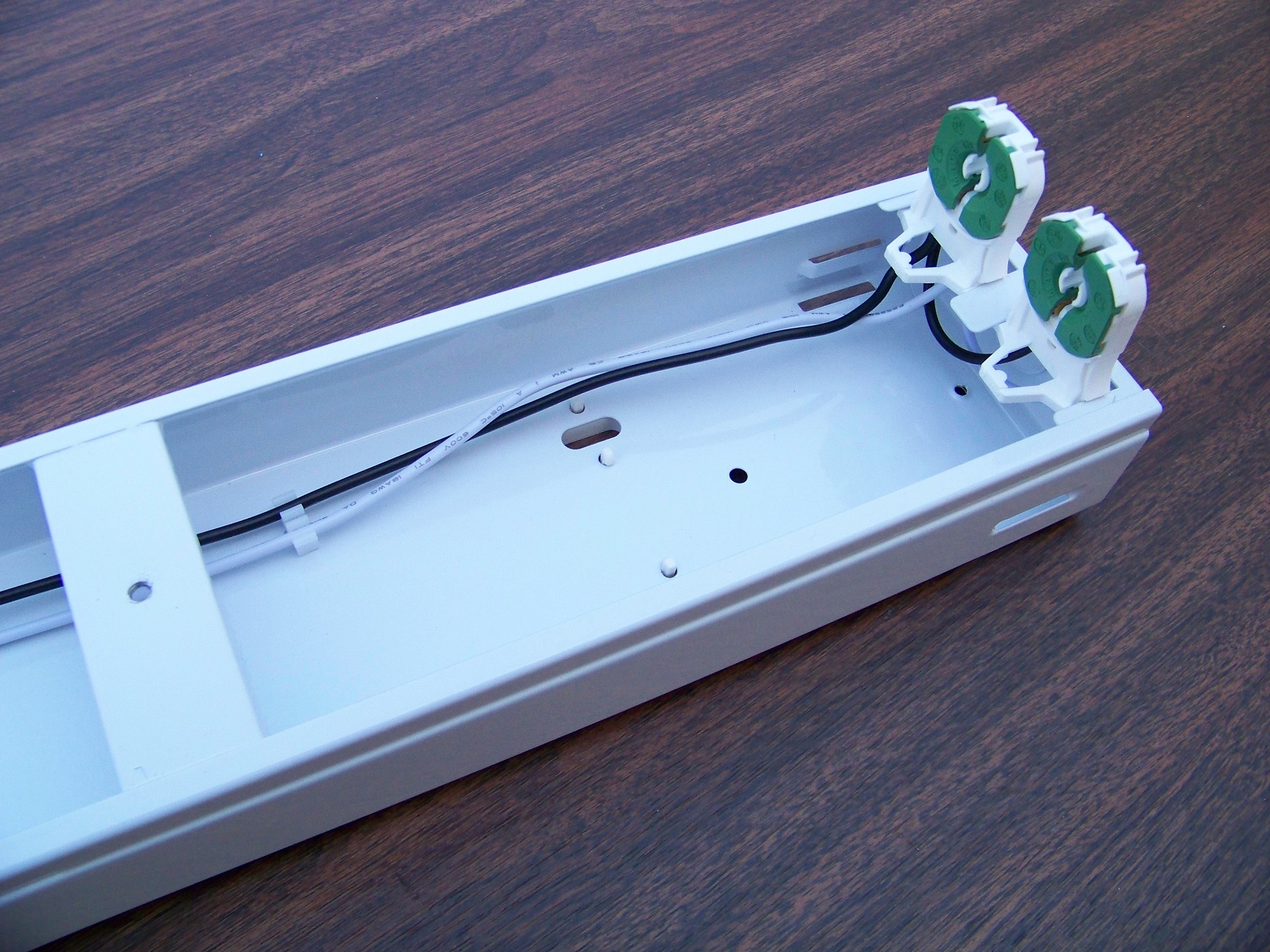

Maxlite LSSXT8USE4803 4' 2-Lamp Continued

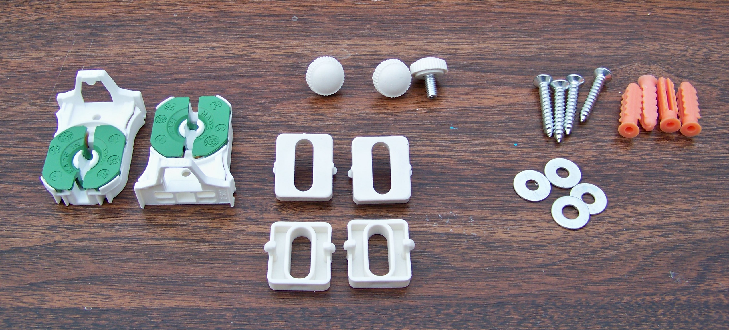

The cover is secured to the housing with 2 simple but effective captive quarter turn clips. The cover only fits one direction, so you’ll want to put the unpowered lamp holders on the end to coincide with the “No Voltage this end” cover label.

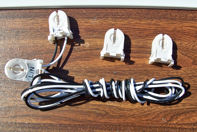

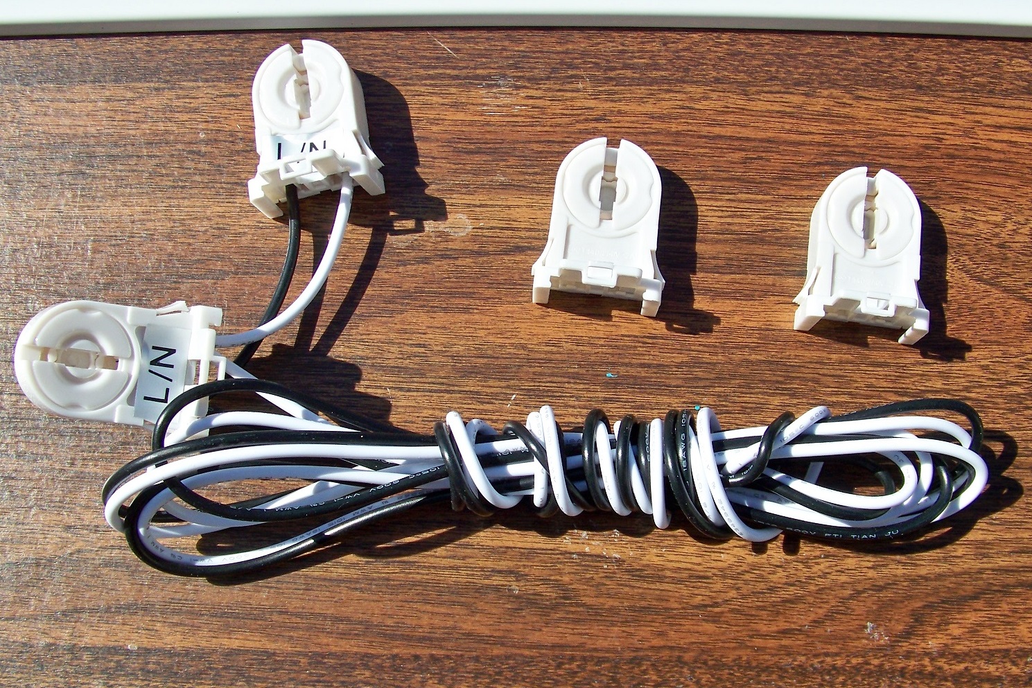

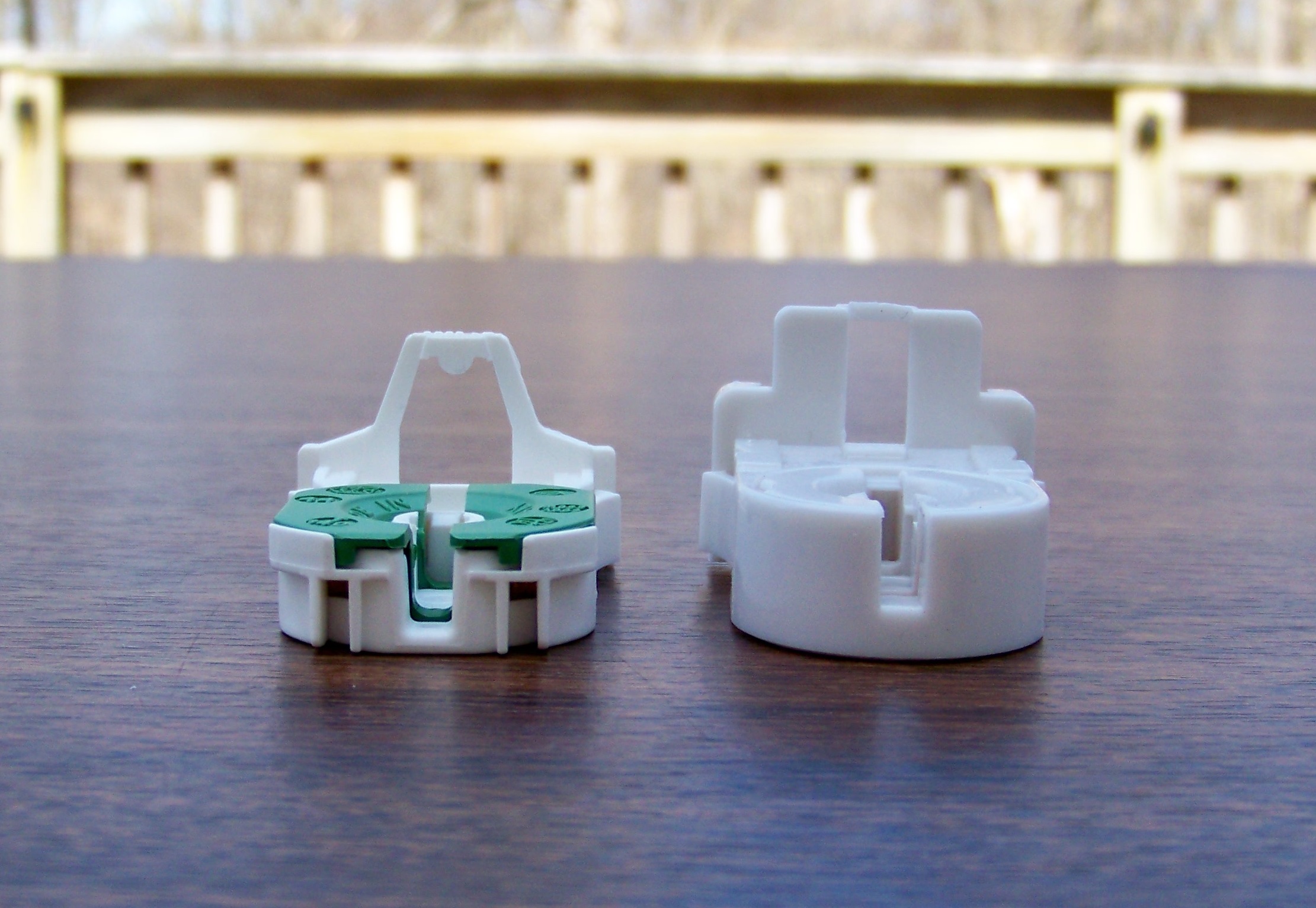

Tombstone snap-in lamp holders are a Chinese brand that I’ve never heard of = HUNPOOL TC-05K3 (link)
They are G13 Medium Bi Pin, unshunted, rotary lock, bottom push-in wire entry with wire release. “Wire release” is a common feature that permits you to insert a small tool – like a straightened paperclip – in the bottom to release the wire.
Above picture shows a standard lamp holder on left and Maxlite lamp holder on right. Top front to back lamp holder thickness = 0.46”. Most common snap-in tombstone lamp holders are 0.344” thick. Should you need to replace one you'd have to contact Maxlite as using standard lamp holders would result in excessive lamp slop. This is a minor issue, but worth being aware of.
The pair of prewired lamp holders are clearly labeled L/N (Line/Neutral) and come with an impressive 6 feet of 18AWG stranded wire with slightly tinned ends. It’s better to have too much wire than not enough. The ground lead is secured to a threaded flush head press stud via hex nut and ring terminal. After spending 5 minutes unraveling the ground lead, it measures almost 7 feet long!

It comes with 2 plastic drywall anchors and screws for surface mounting via the keyhole slots in the housing.
Unlike traditional fluorescent strip light housings, there are no side slots provided for “V” hook and chain mounting. Their spec sheet mentions a cable kit. I requested a picture of this kit but only received the following description: “This is a slot nut cable hanging kit. The nut with the cable would go through the surface mount holes and get bolted on the inside of the housing. It has an adjustable grip to adjust length.” This method of hanging via 2 centered cables sounds unstable as there’s nothing to prevent side to side wobble.
The housing sides have 4 small holes – 2 on each side. These are for the optional wire guard. If you want to hang these fixtures from cables and don’t want to drill holes for “V” hooks or Y-Toggle cable hangers, the 4 small side holes could be used to fabricate something with more stability than their cable hanging kit option.

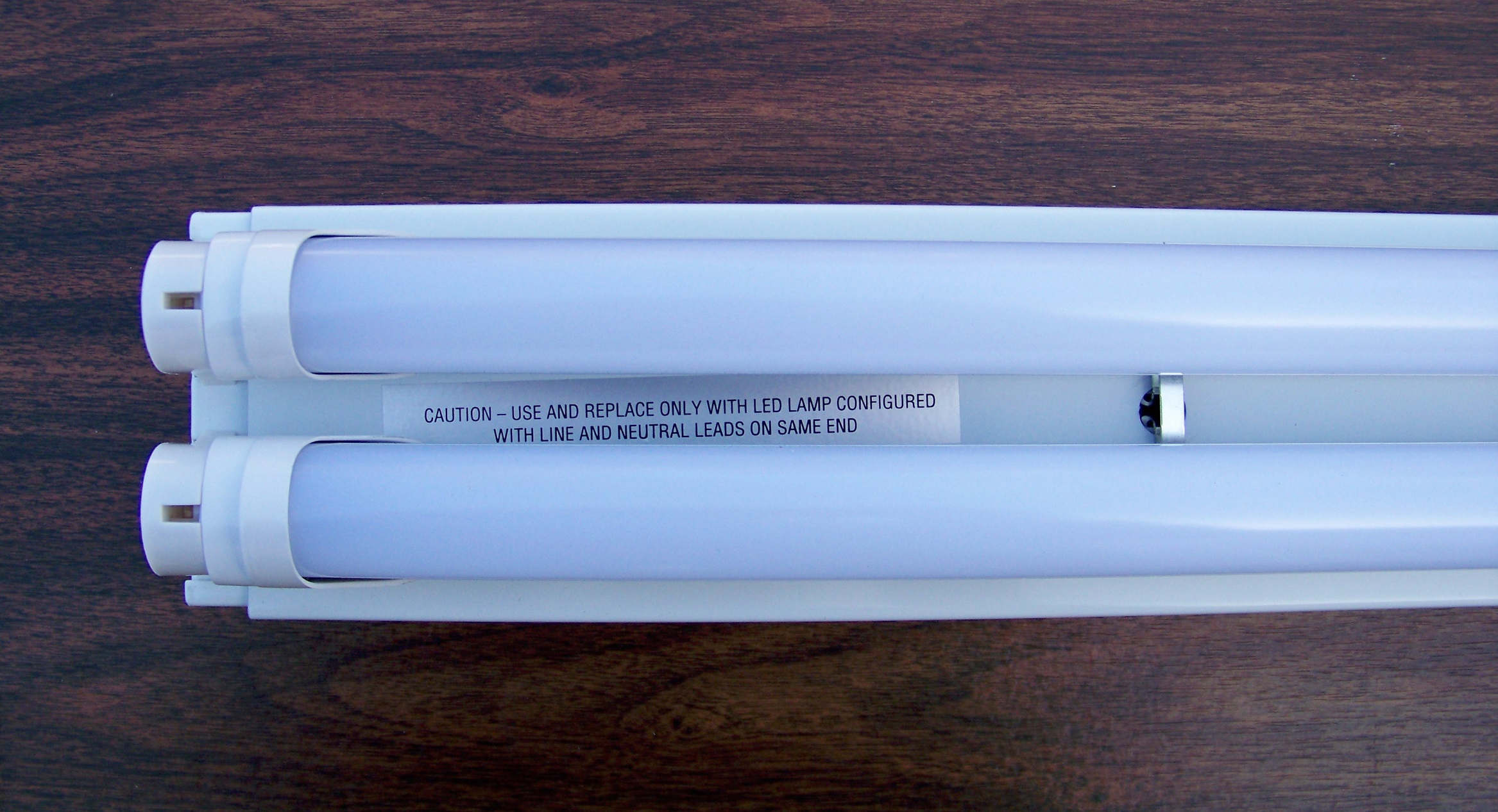

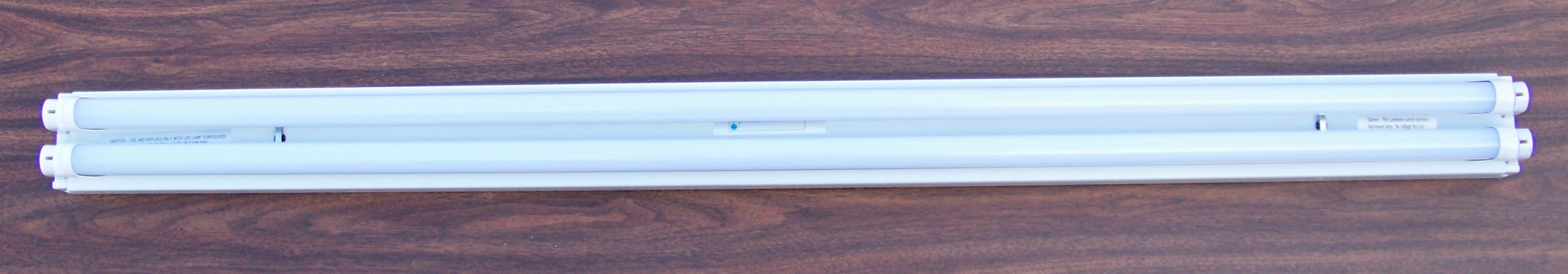

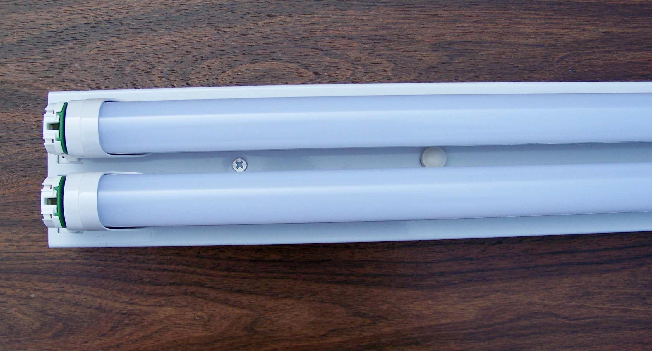

Below pictures shown with GLLUSA 4' 5000K GL07103-3M Lamps installed (not included).
Conclusion:
The Maxlite LSS2XT8USE4803 is a sturdy well-constructed fixture for this price range. Suitable for surface mounting to drywall, wood or steel. If you need hanging fixtures, you might want to find strip light housings with more mounting options. The damp location UL Listing is nice, but doesn’t mean much if using dry location listed lamps such as the GLLUSA 4' 5000K GL07103-3M. If you ever have a failure of the off-brand lamp holders, you can always rewire it to the 2 non-powered sockets.

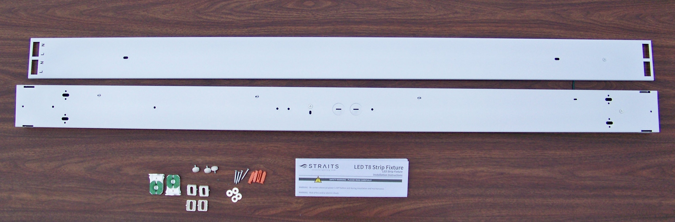

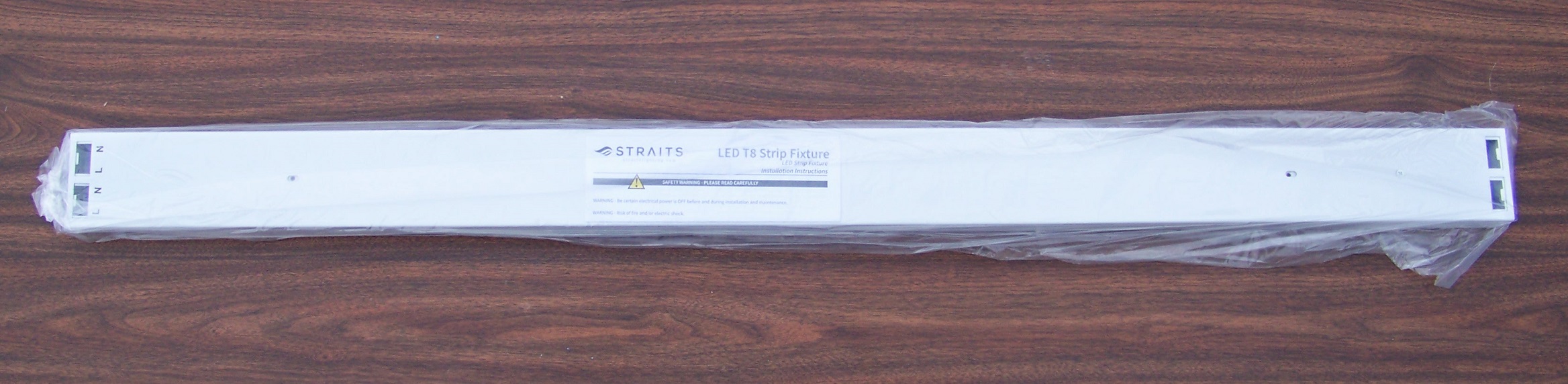

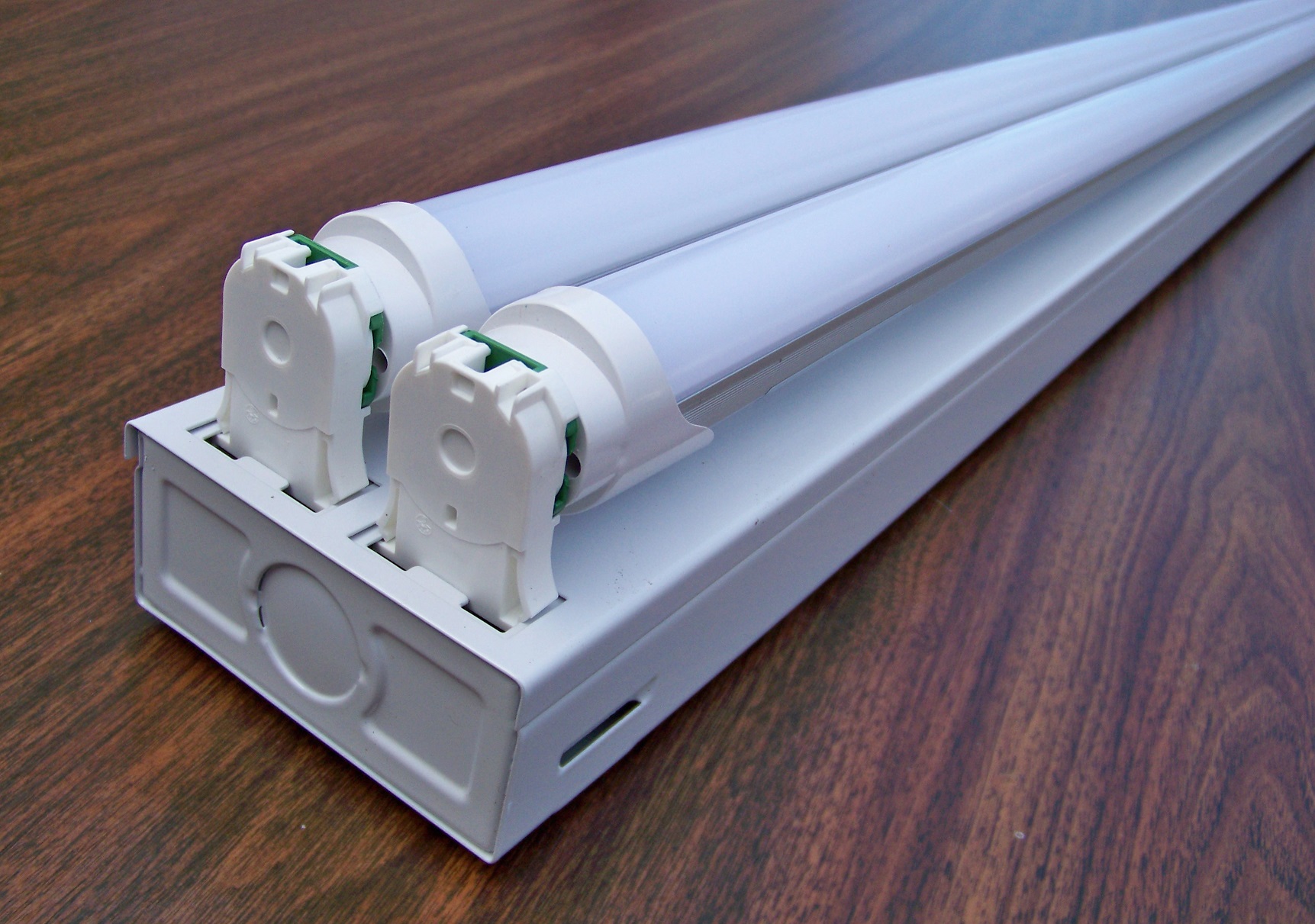

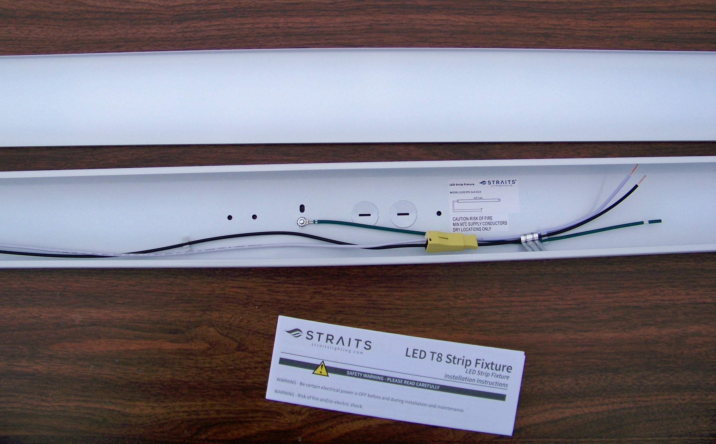

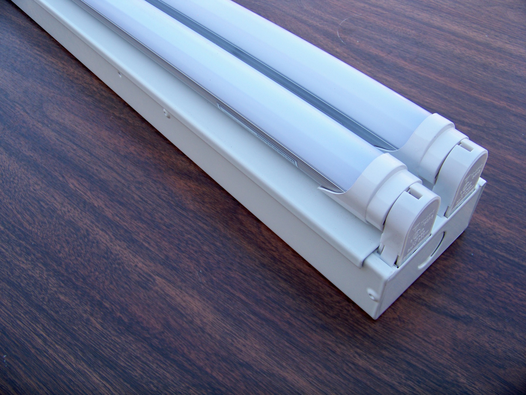

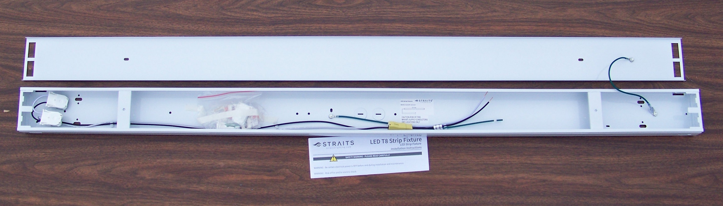

Straits Lighting SL913TK 4' 2-Lamp
Straits Lighting SL913TK 4' 2-Lamp LED Ready Utility Single End Powered Strip Fixture Review

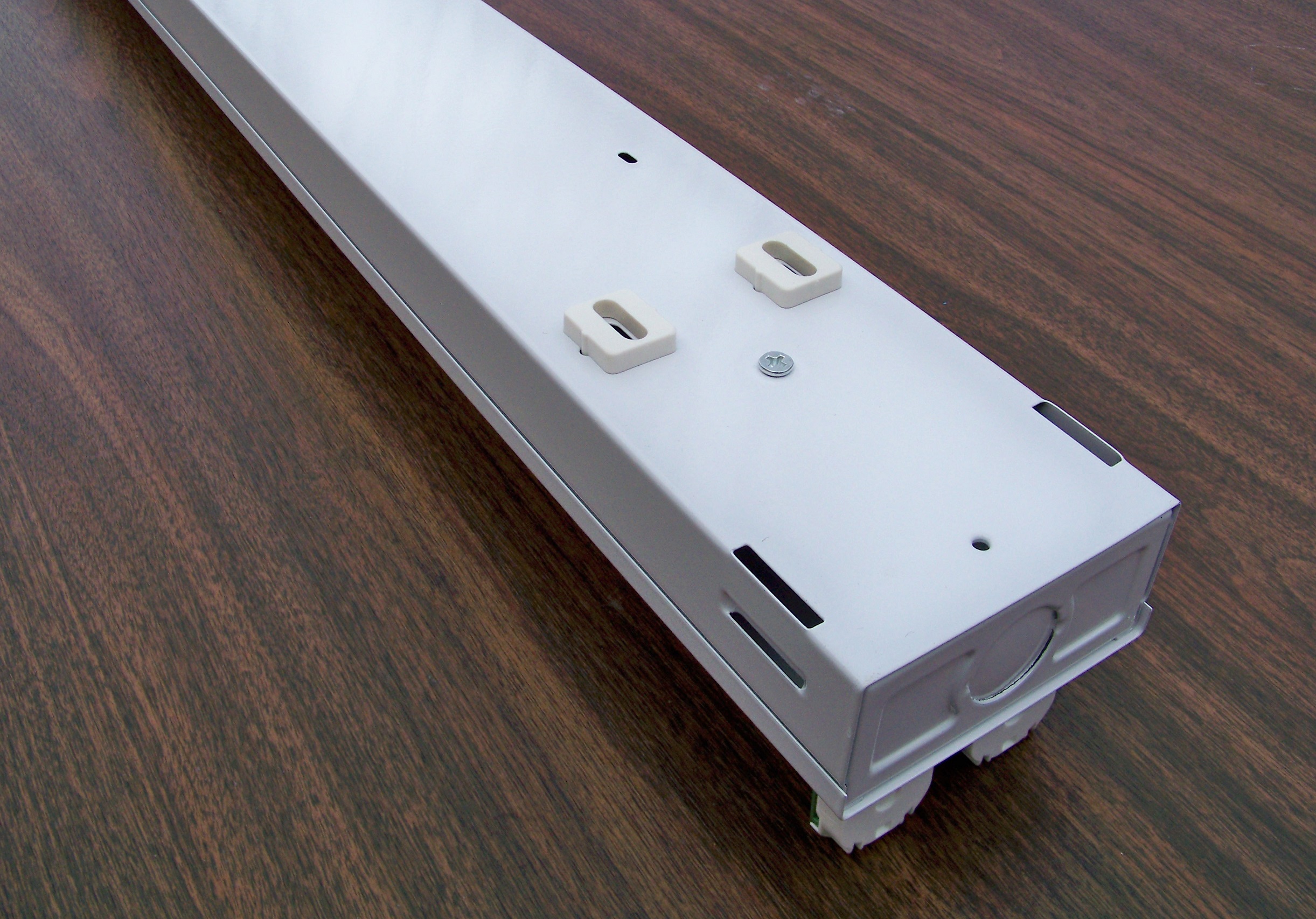

Assembled fixture Weight without lamps = 3.05 lbs.
Measured Housing = 48.56 x 3.23 x 1.67 (with 0.20 tall rear spacers) 2.93 (with lamp holders)
Housing material: Measures 0.026 with paint. So it’s either 25 Gauge (0.021) or 26 Gauge (0.018) Cold Rolled Steel finished in white baked enamel. Noticeably thinner and lighter than the Maxlite housing. The paint job is thorough and there are no sharp edges or burrs.

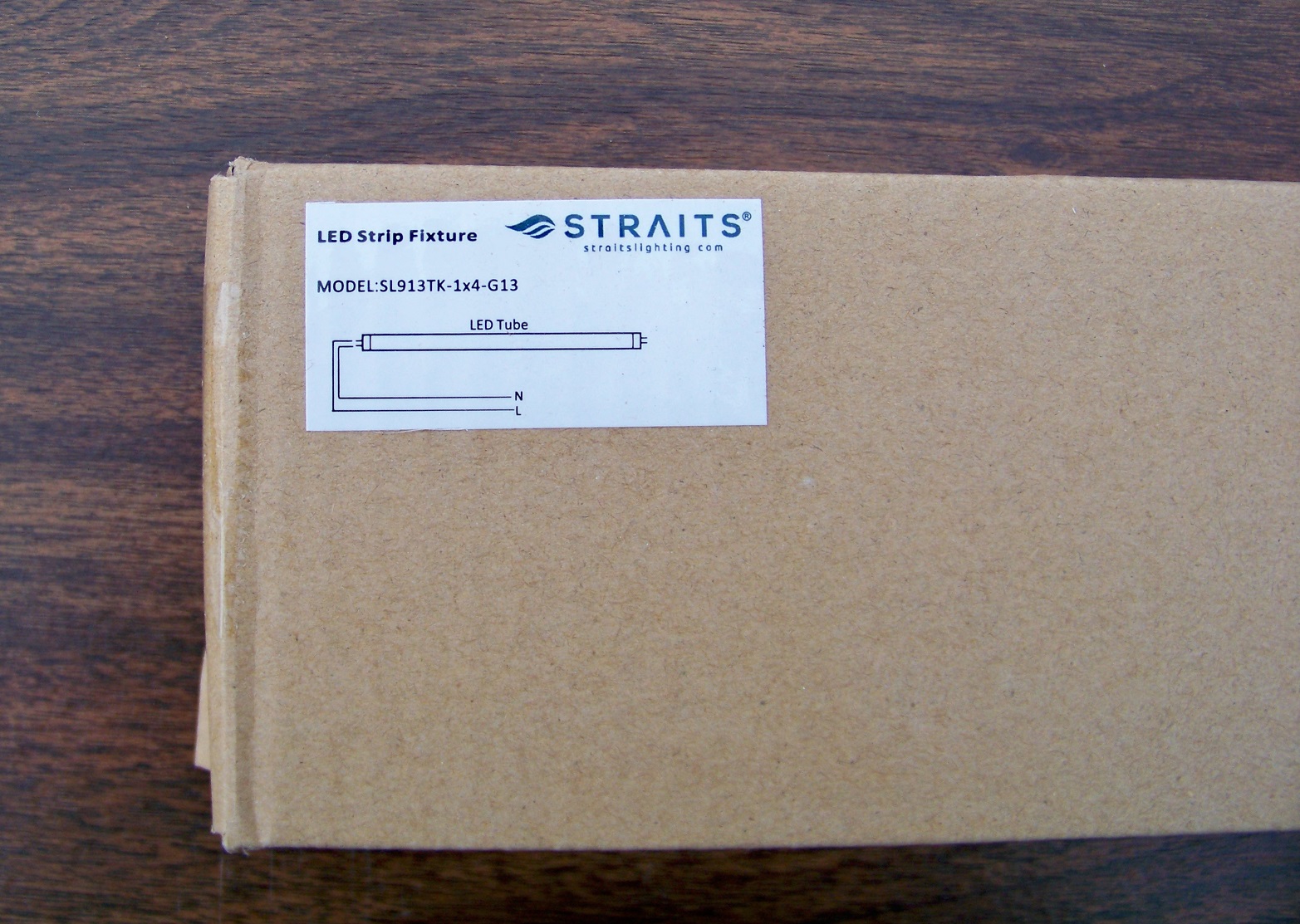

No print on the Straits Lighting box, just the ID label.
Fixture comes in a plastic bag to prevent finish damage from cardboard box transit vibration.
There are four 7/8” Dia. conduit knockouts. 2 on center back and 1 on each end.
Hardware bag contains 2 rotary lock Tombstone AAG Stucchi 3249-9-H/S-SN-U-PBT (link) snap-in lamp holders. They are industry standard 0.344 thickness G13 Medium Bi Pin, unshunted, rotary lock, bottom push-in wire entry without wire release.
Ground lead is 1ft long secured to housing via screw, hex nut and ring terminal. Wired lamp holders come with 26 inches of 18AWG solid wire plus Wago 873-902 Lumi-Nut Pushwire Connector and a 7 inch wire pigtail. This would be a nice perk if it wasn't installed incorrectly from the factory. The 4 hole side is supposed to be for line-in and to daisy chain to the next fixture. Instead 2 pigtails leads are installed on the output end and the lamp holder feeds are connected to the line-in terminals. Ironically, it would actually be cheaper for the manufacturer to install it correctly as then there would be no pigtails.
These are the only labels on the fixture. No UL Label. Their literature states “UL Certified”, but there is no record of the SL913TK part number in the UL online certification directory. Whether a housing of this nature needs to be UL Listed is debatable. As long as the electrical components and lamps are UL Listed (which they are) and there are no major safety violations, this isn't a huge deal (unless your building inspector calls you out on this). The notable safety violations are the missing Caution labels.

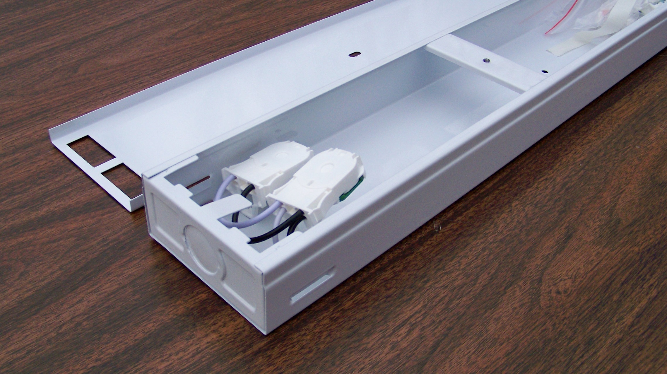

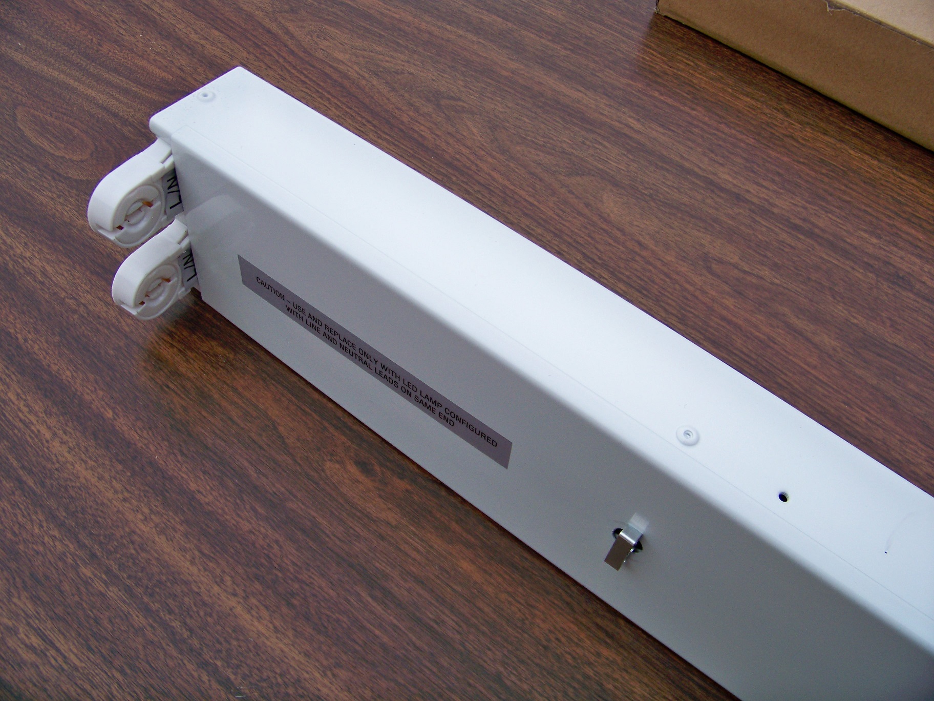

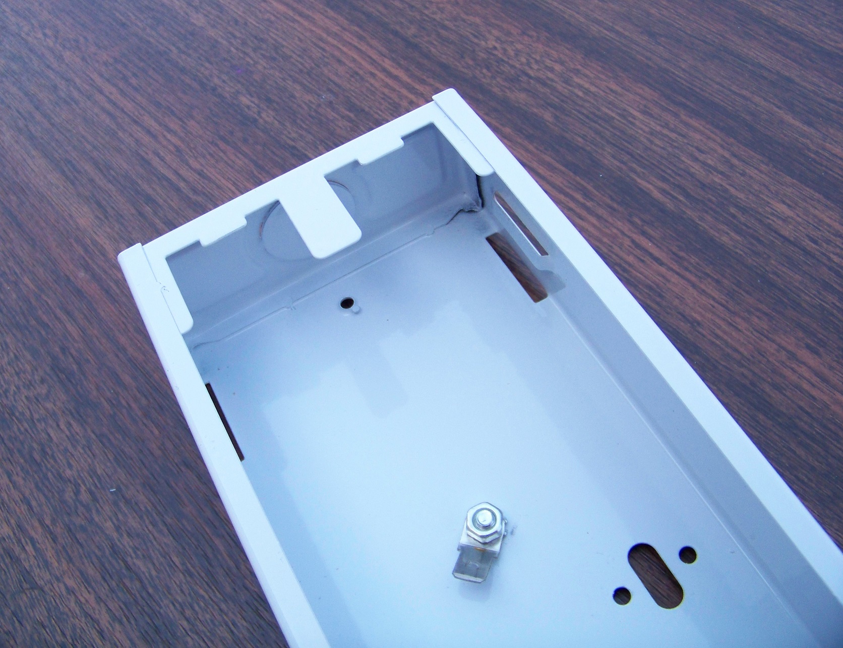

Straits Lighting SL913TK 4' 2-Lamp Continued

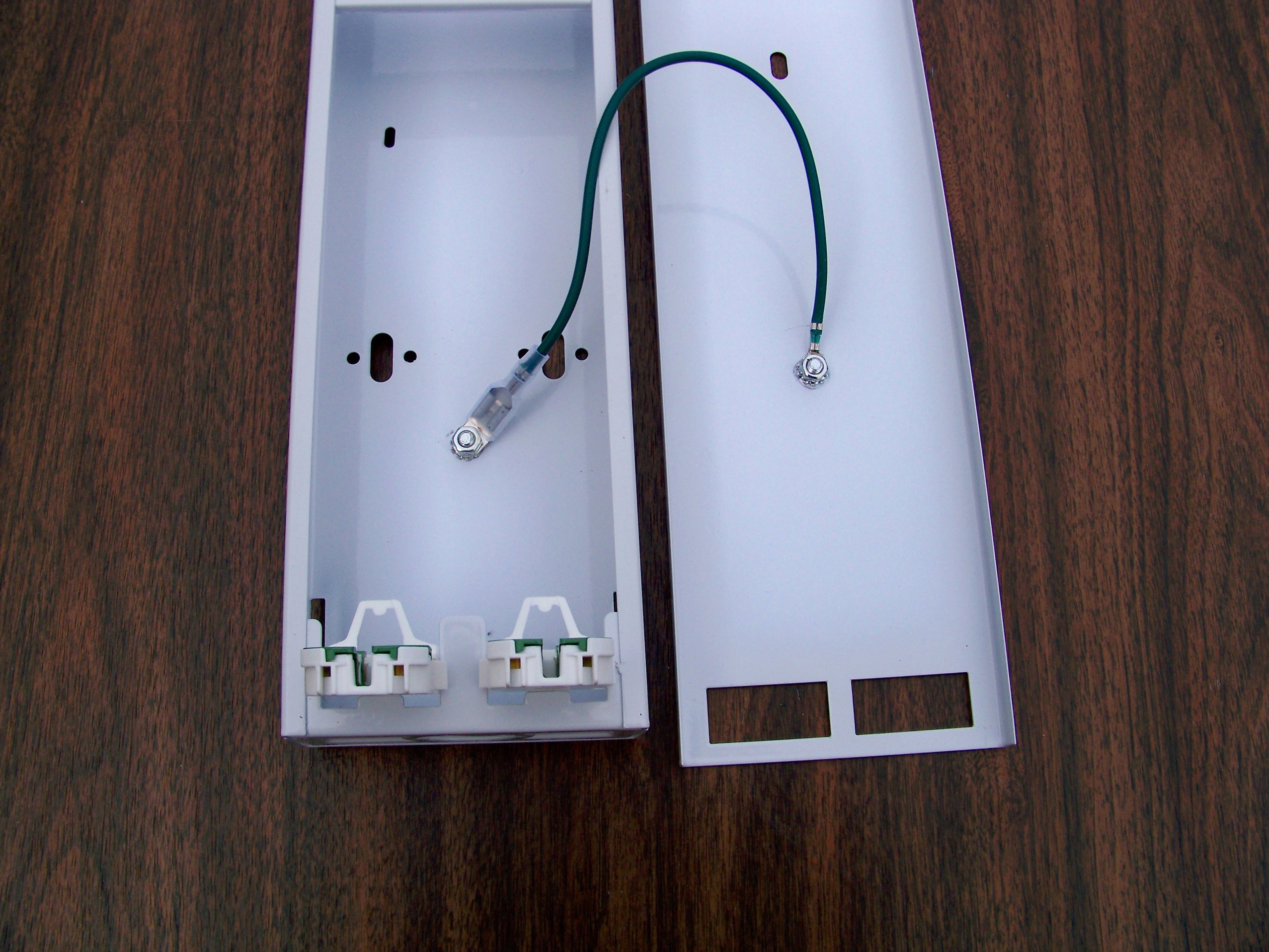

Stamped end housings are spot welded to housing.
Housing cover is grounded via screws, nuts and convenient spade connector. This fixture may not be UL Listed, but the grounded cover makes it an electrically safer enclosure than the Maxlite which does not have a grounded cover.
Housing comes with 3 preinstalled plastic wire management clips.

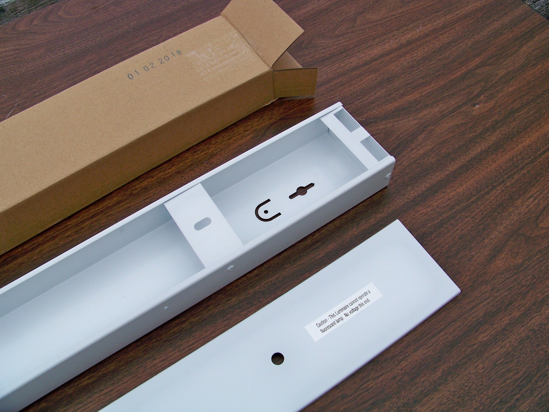

Mounting:
Straits Lighting Installation Instructions (link)
The literature makes no mention of any hanging options and there are no side slots for “V” hangers. The rear mounting holes (0.54” x 0.22” obround) might be big enough to accommodate Y-Toggle cable hangers. I’m sure ProLighting can confirm fit as they sell Y-Toggle cable hangers (link) also.
It comes with 4 plastic drywall anchors, washers and screws for surface mounting.
The slots on the ends of the housing are for the 8ft variant’s locking bracket (see PROLighting 8ft link in post 1). I believe the 4 plastic snap-in spacer feet are only required when using the 8ft variant’s locking bracket.
Cover is attached with 2 thumb screws. Hardware package came with 3. Not sure if that is just an error or to make up for the increased loss potential of non-captive hardware.
Conclusion:
The Straits Lighting SL913TK housing is quite thin, but it gets the job done. The name brand lamp holders fit securely and I’d expect them to provide reliable long term service. The missing UL Listing and caution labels are issues that need to be corrected. Since the Wago connector isn’t required, the incorrect wiring of it doesn’t add or subtract anything from its functionality.

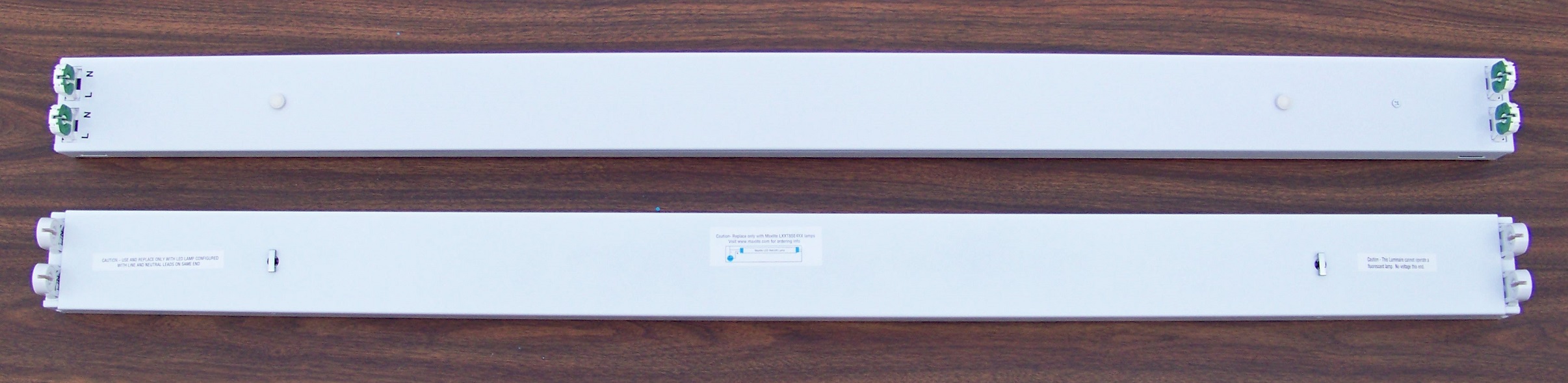

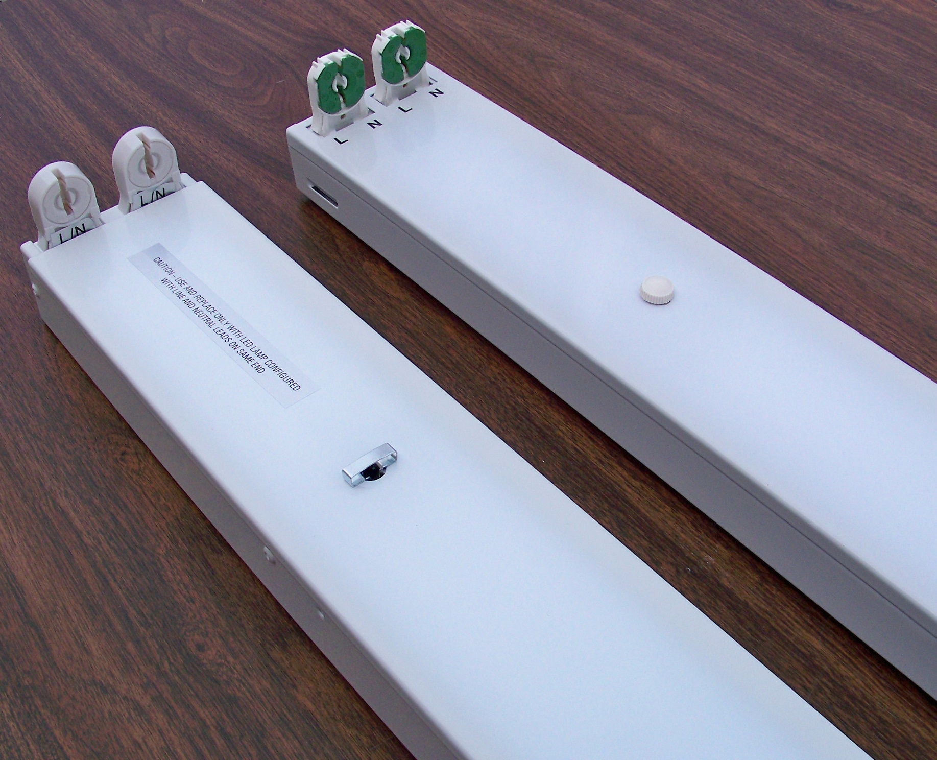

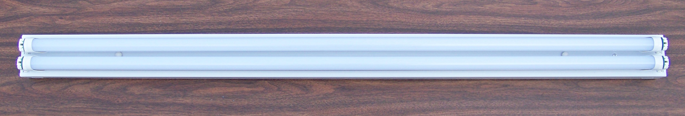

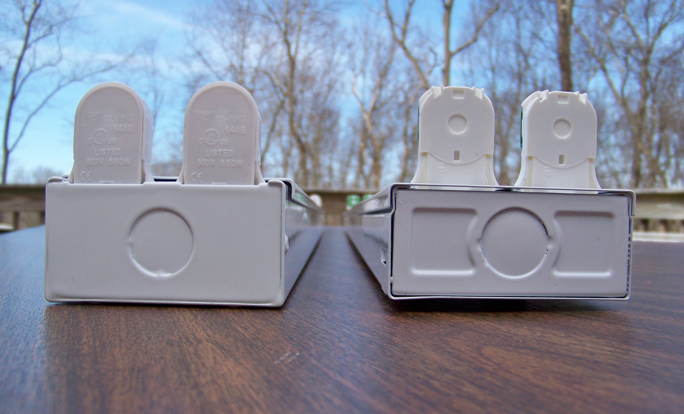

Maxlite / Straits Lighting Review

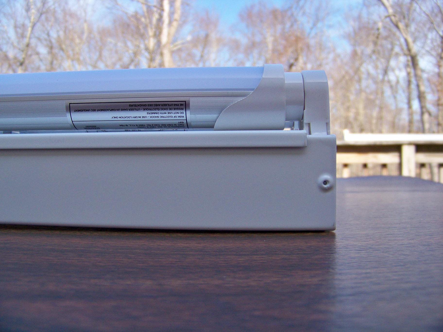

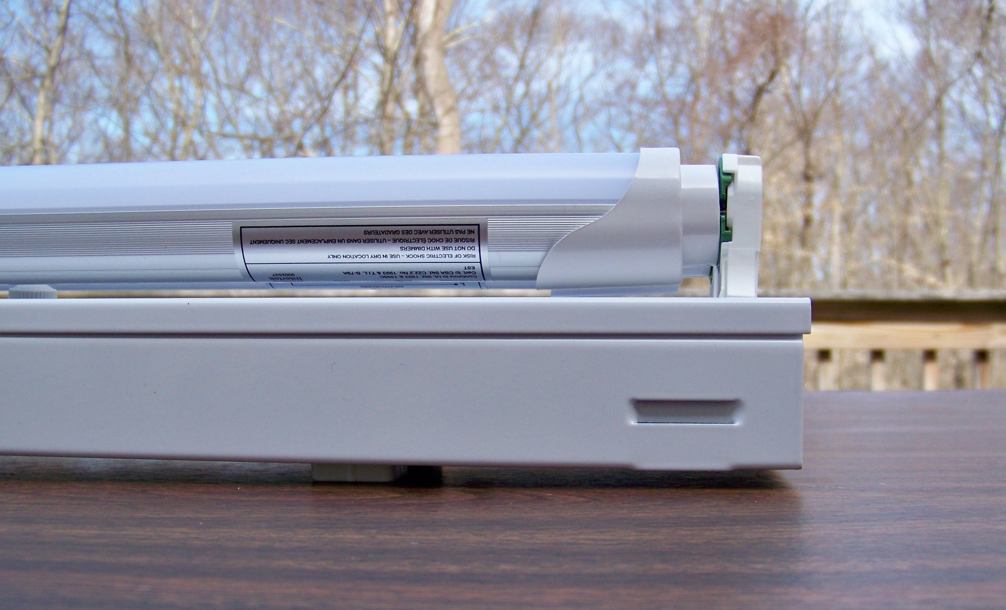

Here are a couple head to head Straits Lighting / Maxlite comparison pictures:
Straits Lighting on top
Maxlite on left
This image really shows the metal thickness difference. Maxlite left, Straits Lighting right.​

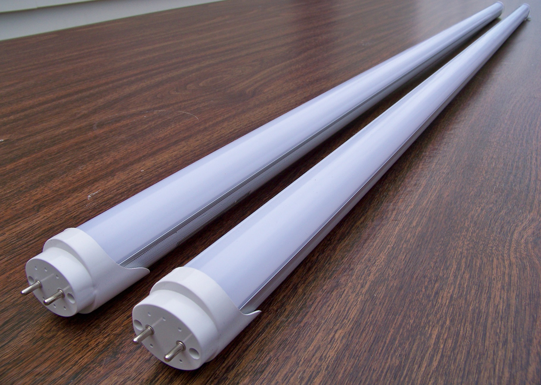

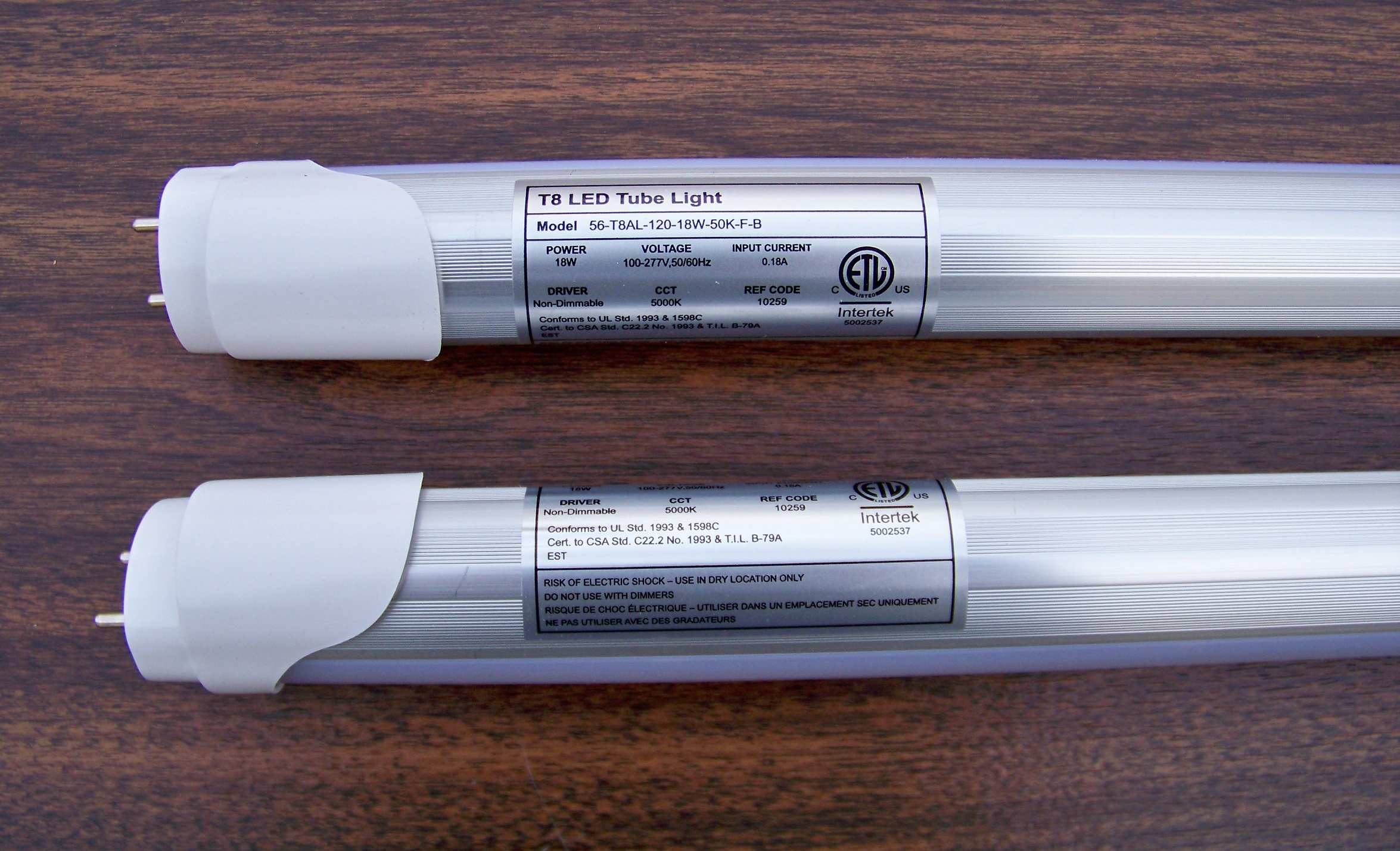

GLLUSA 4' 5000K GL07103-3M Lamp Review

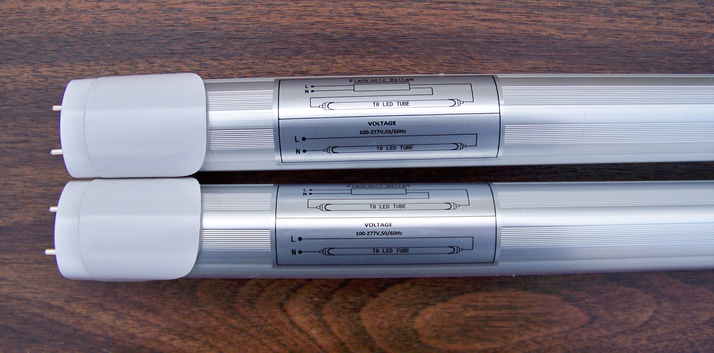

Lamps were packaged in basic nondescript white boxes with no markings or labels. Not much point posting a picture of a white box. Lamps came package with typical plastic pin protectors.
Wiring diagram on lamp label shows option to use with fluorescent ballast or as ballast bypass with opposing end wiring. Label does not show a single end wiring option which is how the enclosures are prewired. Both GLLUSA website and PROLighting both state "Direct Wire Single End or Opposing End". The lamps function just fine installed in the single end wired housings.

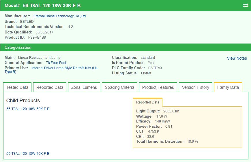

Lamp SKU on ProLighting website: GLL GL07103-3M which = GLLUSA Lamp Code: ST-TL-003-18W-B(5000K) per spec sheet (link). The Lamp Code corresponds to below DLC listing which shows the manufacturer as SHENZHEN GCL ELECTRONICS.
Part No. on label of supplied lamp = 56-T8QL-120-18W-50K-F-B. Below DLC listing shows the manufacturer as ETERNAL SHINE TECHNOLOGY. (Caution - I got a Norton Virus Warning when I attempted to go to the ETERNAL SHINE TECHNOLOGY website - so I chose to stay safe and leave it alone).
Edit: Checked again and now I see "Builders Pack" on GLLUSA website:
Rating specs are identical for both DLC listings and both companies have active ETL files referencing their respective correct part numbers. I'll chalk this up to the near impossible task of determining who really made any product.
I'll post more on this lamp later - like actual power consumption and measured color temperature. I can't measure lumen output so we'll just have to accept the DLC listings.

Sorry maybe my question was unclear. Is it required to use a clamp like this in the knockout: https://www.lowes.com/pd/Sigma-Elec...ce-Entrance-Connector-Conduit-Fitting/3152587
Or can you just run your romex through the knockout without any strain relief?
I am fairly sure you are to use some sort of strain relief. You can use the type you posted or there are plastic variations that you can use such as this
https://www.homedepot.com/p/Halex-3-8-in-1-2-in-Knockout-Non-Metallic-Push-In-Connector-100-Pack-75105B/100150300?MERCH=REC-_-PIPHorizontal3_rr-_-203803782-_-100150300-_-N
There are also plastic parts available that just cover the hole edge and have a large hole so don't grip the cable at all. These seem like a poor idea to me and doubt they meet code.
If I was doing a bunch of lights I would go for the plastic grips.
