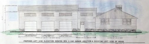

Hi again!
As I had mentioned, here are a few images of what it's going to be. Definitely open for suggestions for construction or interior layout and so on - changed a few things already, like 10' x 12' garage doors instead of the 9' x 10' in the plans...

Pretty good looking design. I like how the house will hide most of the size.
Yea, that was one of the goals. Actually, in the first rendition with a total height of about 18', it was pretty much all hidden from the street view, but I wanted the extra headroom especially for the mezzanine above the 14x14 area for storage with enough headroom. it's still pretty "stealth" considering it is in a purely residential neighbourhood in this town. I mean, it worked, and I got a permit in pretty short order, kudo's to the architect!
