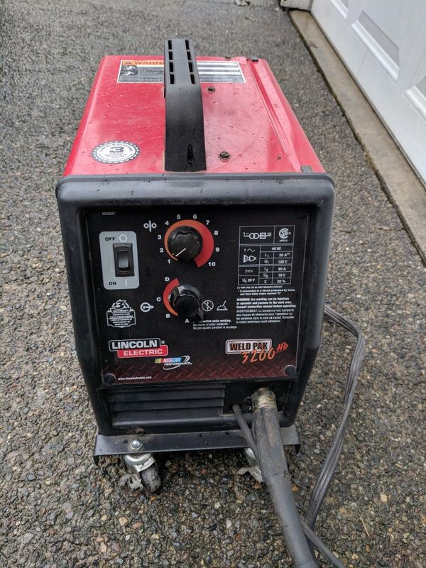

Watch Craigslist.
I picked up a Lincoln 3200HD for $175 fairly well used but very usable. Needed consumables, a tank and gauge. 135A 120V. Got me started until I can go 240V and bigger amps.
https://www.lincolnelectric.com/assets/servicenavigator-public/lincoln3/im759.pdf
