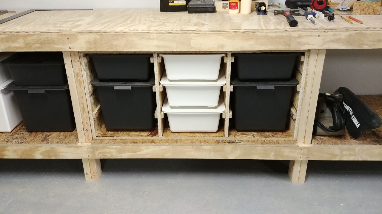

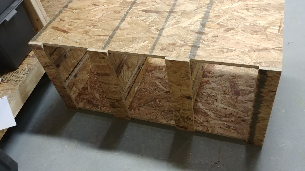

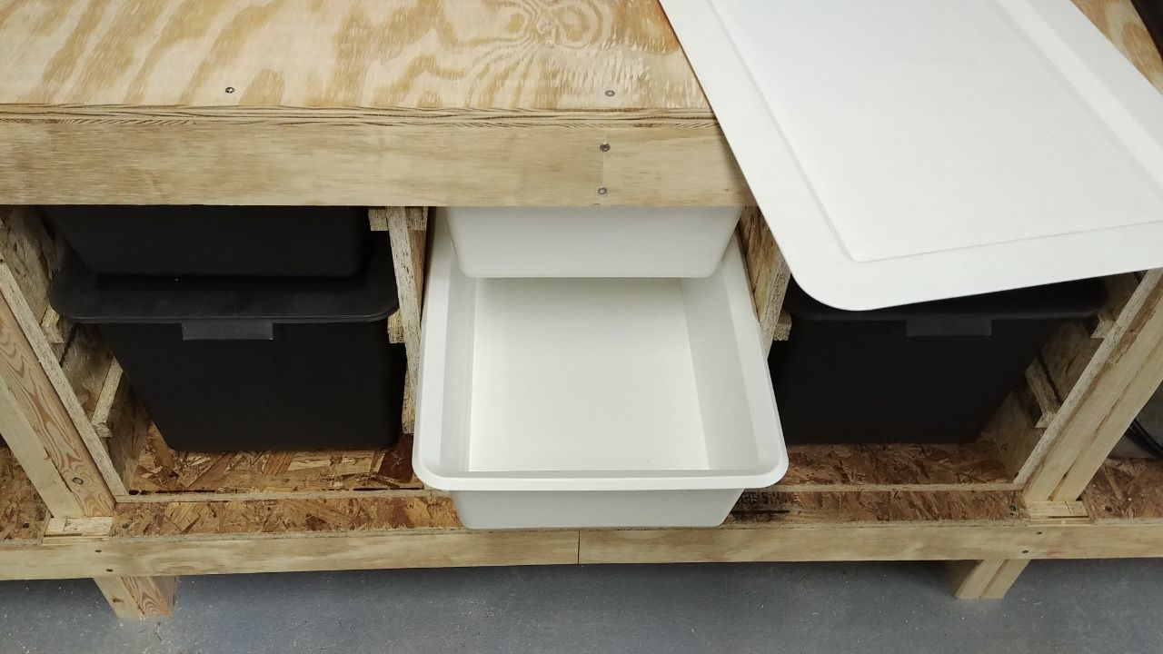

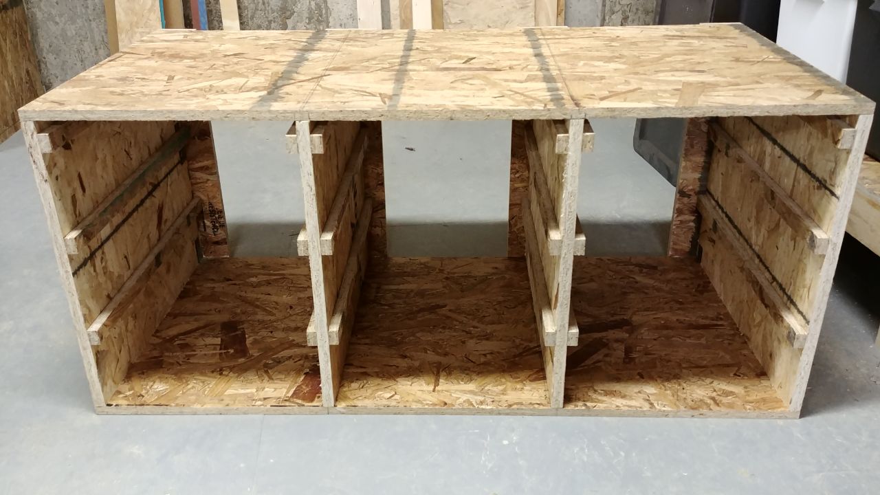

This is nowhere near as polished as yours, but I did something similar for underbench storage.
I have a bunch of stacking storage bins from IKEA with loose lids. I know from experience that I will not consistently unstack anything for storage. Maybe it's just a Swedish thing to do that, I don't know, but anything I use frequently that's stored in a bottom bin won't get put away when I take it out. It'll wind up cluttering some other area, and the lower bins turn into wasted space full of junk I never use.
So I built sliding racks for them:
My racks are completely unlike your labor of love Milwaukee rack. They're just OSB assembled with glue and a finish nailer. But the concept is kind of the same: convenient sliding access for retail-bought storage boxes that weren't designed with racking in mind.
