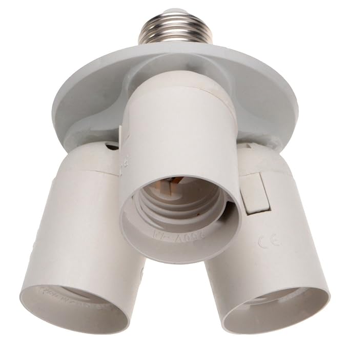

techieman33
Jun 18, 2018
1,096
Kansas
I would buy one of the 1 to 7 adapters. Then you can just throw whatever cheap LEDs you can pick up at the store in them, and you can do a little to direct the light where you want it. It will help you get the light out to the edges of the shop without being nearly as hard to look at as the corn cob bulbs. And then if you move out of the shop you have plenty of bulbs to put in at your next shop or house or wherever.

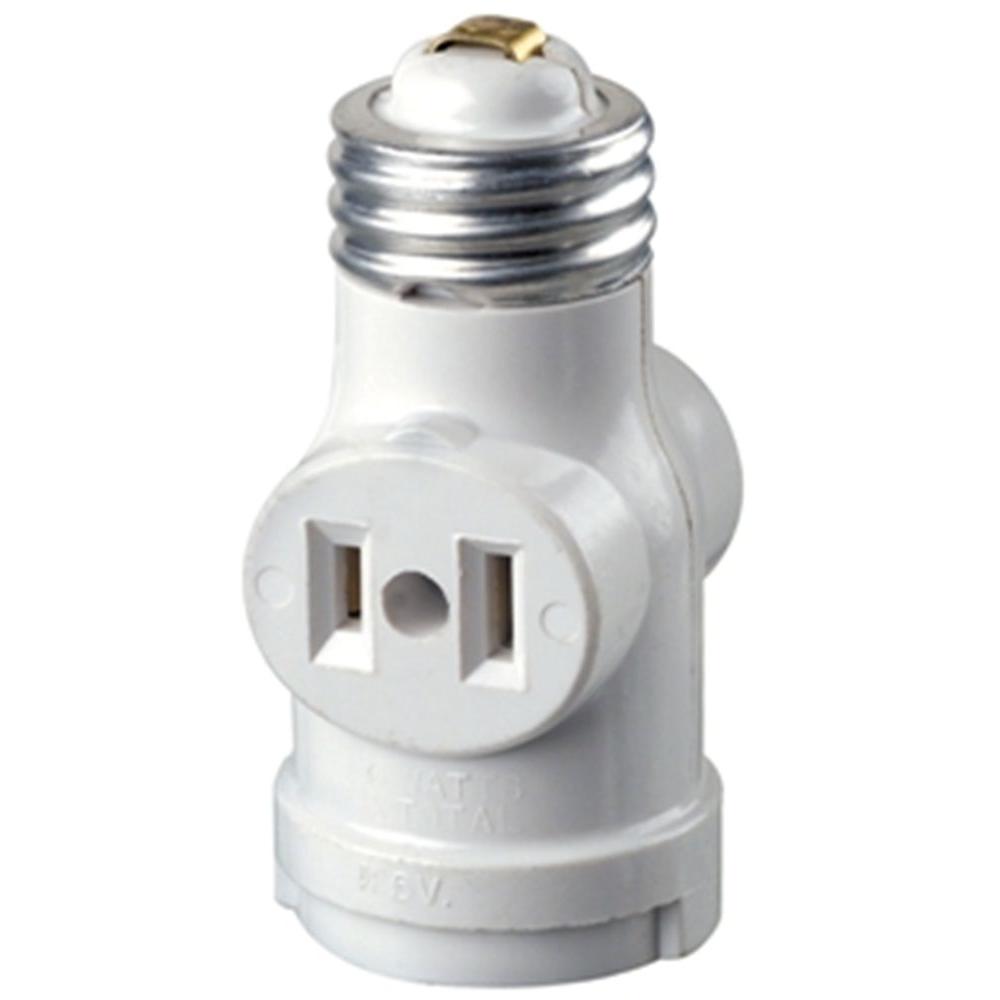

Platonic, I see that the lights you linked can be Daisy chained. Is there a downside to this? Would they not work as well of one was plugged into the light socket and another we're plugged into the first, or is it going to depend on the length of the supplied cord?
Edit to add: The adapter you linked, does that have two power plugs and one socket for the light? So I could plug in two power cables and still use the light that's there? It's kind of hard to tell from the picture.
Sent from my Pixel using Tapatalk
Platonic Solid
Nov 29, 2014
3,587
CT-USA
Lights: Yes, you can daisy chain the lights, no downside. This gives you more flexibility in fixture placement.
Socket with Outlets adapter: Yes, you can plug in both power cables and still use the existing lamps. Just make sure you don't exceed 1800 Watts for the entire circuit (which is not likely) - Total wattage of 8 strip lights = 320W + whatever the wattage of the 4 existing bulbs is.

alfredeneuman
Mar 3, 2011
4,596
Fullerton, CA
All 15A receptacles in garages (even ones that adapt edison base lampholders to receps) are required to have GFI protection, so you'd need a GFI breaker on the light circuit.
Platonic Solid
Nov 29, 2014
3,587
CT-USA
That's so not going to happen. As long as the outlets are only being used for lighting this is a non-issue.
alfredeneuman
Mar 3, 2011
4,596
Fullerton, CA
I know it's not gonna happen ...... but nevertheless it's in the Code and worthy of mention.
There is no exception for just lighting.
Platonic Solid
Nov 29, 2014
3,587
CT-USA
Yeah, I know you're right, just don't want to unnecessarily scare the OP back to the screw-in bulb solution.
In theory, if we crazy-glue the light fixture plugs to the outlets, then it's no longer an outlet and there is no code issue.

Another super low cost fix for this situation..........3 or 4 bulbs adapter with LED bulbs.

I decided to order some of the lights and adaptors mentioned by Platonic.
It seems like I'm getting mixed responses, do the gurus here think I'll have a garage-burning-down problem? I didn't even consider it until it was brought up.
Platonic Solid
Nov 29, 2014
3,587
CT-USA
According to HD site the adapter is rated for 660W so that would be a max of 16 fixtures on one adapter. Standard medium base lamp holders are also rated for 660W, so we're good to go. The fixture spec on Amazon says 10 fixtures linked max. I think someone smoking a **** in your garage presents a higher risk of fire than putting a couple of these fixtures on an adapter.
