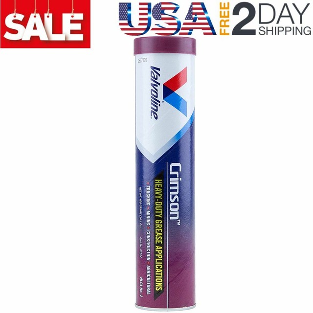

I use Valvoline Crimson "Red" Full Synthetic EP in my ratchets. It lightens up over time, don't use a-lot.. just enough to coat the inside. Stays where it belongs, in the ratchet and keeps everything slick.
