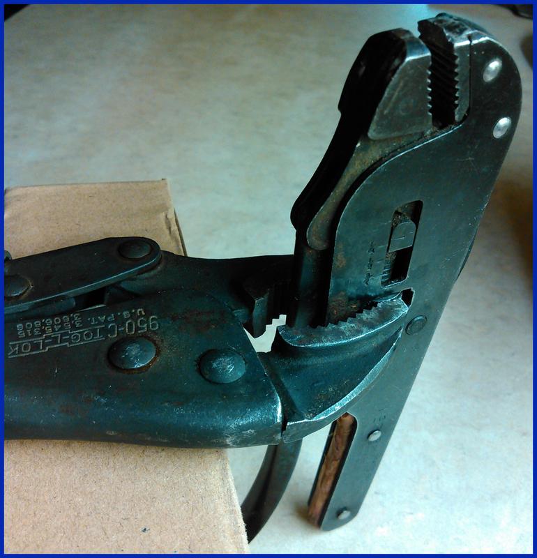

We had a thread on those pliers awhile ago. Forget what they are called or who made them but they are not like Vise Grips even tho they seem to be.

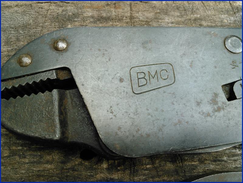

Nice. Yeah they pivot outward, not inward.
30,983
The tool in Pics 2, 3, 4, and 5 are Botnick Motor Corporation (BMC) Model No. 7 "Precision-Locking Pliers". As disston alluded to, if you search on BMC or Botnick you will find several threads here on GJ. They have an incredible and incredibly GJ-ish history. Saul Botnick, the inventor, owned a prominent Chevy car dealership in Binghamton, NY in the 1920's. (Last time I checked, it was still in operation.) He started a little parts fab/tooling shop in the dealership, to support vehicle maintenance. Unsatisfied with the capability of commercial tools (including the lack of precision in Petersen Vise-Grips), he invented his own locking pliers and then decided to produce them for sale. They are not rare, but they're not too common, either. That's a nice find.

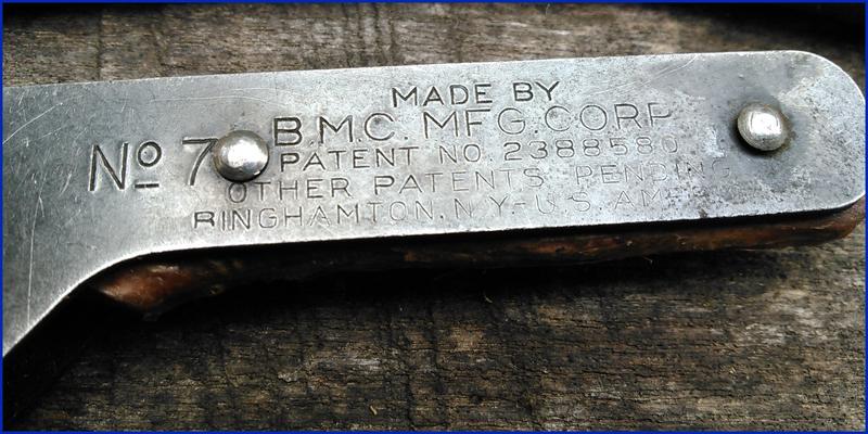

The locking pliers are Botnick Motor Corporation (BMC) Model No. 7. If you search on BMC or Botnick you will find several threads here on GJ. They have an incredible and incredibly GJ-ish history. Saul Botnick, the inventor, owned a prominent Chevy car dealership in Binghamton, NY in the 1920's. (Last time I checked, it was still in operation.) He started a little parts fab/tooling shop in the dealership, to support vehicle maintenance. Unsatisfied with the capability of commercial tools (including the lack of precision in Petersen Vise-Grips), he invented his own locking pliers and then decided to produce them for sale. They are not rare, but they're not too common, either. That's a nice find.
That's awesome. I appreciate you taking the time to let me know those details. And that is interesting because I am from Syracuse, NY, an hour north of Binghamton. They definitely have "No.7" stamped on them. About the only marking I can make out. I purchase a tool chest yesterday and there was a couple buckets of hand tools with it. This was one of the pieces. Thanks again!

You might notice that one of the great features of the BMC is that the jaws remain parallel when you close them around something. It's an unusual feature, and one that I've needed a few times.
I'm not sure how to word this right, but another feature is that they don't have to be adjusted so precisely to grip an object correctly. There's a wide range of travel when the handles are pulled together.
My understanding is that they were made for only a few years (1944-47 ?), but the number that still survive indicate they sold a ton of them. The company then moved to making....pedal cars.

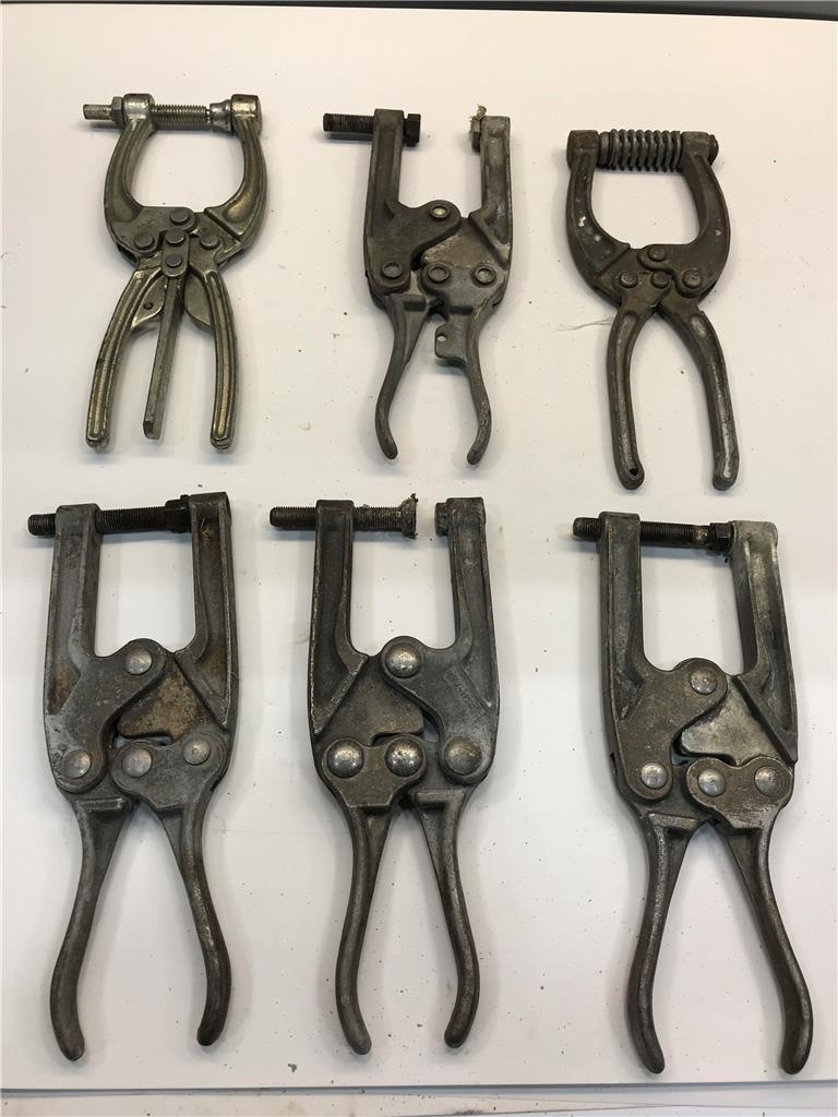

Detroit Stamping Co (De-Sta-Co) made a lot of the style of welding/fabrication clamp shown in OP's first pic
https://www.ebay.com/itm/Vtg-Lot-3-DE-STA-CO-Welding-Aviation-Toggle-Hand-Squeeze-Pliers-Clamps-441-424-/153013157839?oid=223014742573

They seem pretty handy. First set I ever have had. Actually got another pair of them today, a larger set. I'm a welder and from what I understand they are a welder's tool.

I have used them for hose clamps in the past. They work good for that because you can tighten them just enough to close off the tube, and they have smooth faces so they dont sig into the surface.

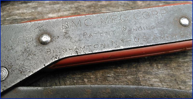

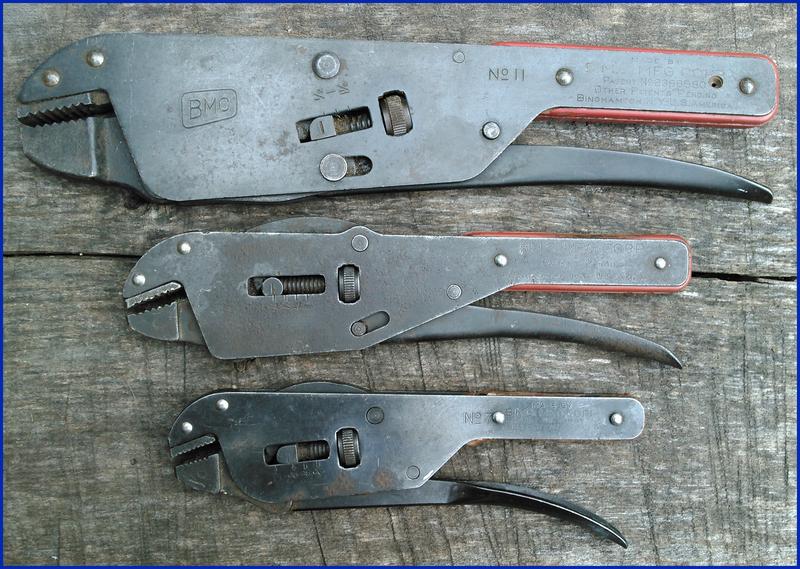

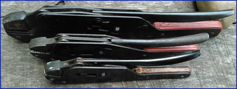

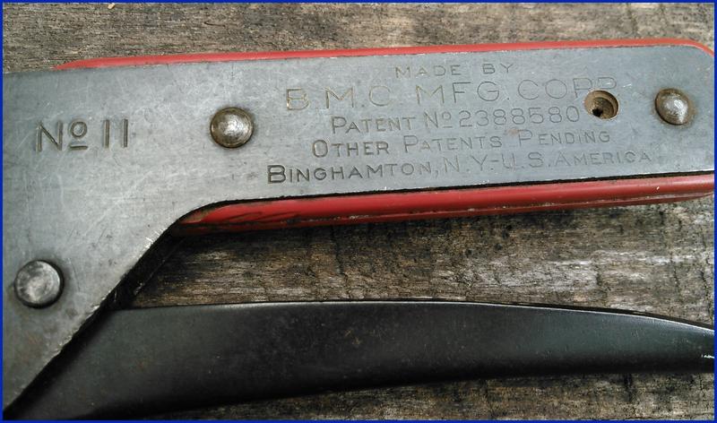

I had a set of these in the 70's that I kept in my motorcycle tool kit. I liked them because of the square jaws. I lost those somewhere over the years but have picked up a few others of late. I was surprised to see these big 11" No. 11's. I've also run across different colors of them. I think it was a turquoise color but don't remember now for sure. Anyone seen different colored BMC grips?

I have three BMC grips. No.5, No.9 and No.11.
Interesting to notice that each tool is a slightly different design. My guess it is due to age differences.

I have three BMC grips. No.7, No.9 and No.11.
Fixed it for you ;)
I guess I need to keep looking, I hadn't realized they made other sizes. I've only ever seen the #7 and #11.
