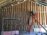

Roof decking and gables

I then started pulling wire! I installed my outlets 48” off the floor. I really put way to many outlets. They are spaced someware between 8 to 10 feet apart. I wired 2 circuits per wall and alternated the the outlet on the wall to the circuits
(If I had 8 outlets on a wall the first, third, fifth and seventh were on one breaker and the second, forth, sixth,and eighth were on the other breaker)
I installed a few outlets to be operated by switches for fans and speakers. I also tried to install outlets where I didn’t think I would need them just Incase I needed them.
I ran lots of 220 drops as well. I have two 50 amp drops in the main shop for my welder, that way I can be almost anywhere and weld. I put in a 220 for a dryer, and 4 220 30 amp drops for for compressor or other high voltage items.
Lights, lots and lots of lights. I wired in 14 can lights in the boat port and 9 high bay lights for the main shop. I also wired for led lights in the mezzanine.
