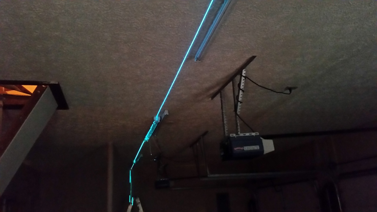

Here's what it looks like in real life (keep in mind that this is relatively clean - it gets worse from here throughout the year with house projects and kid toys piling up):
Shot of the current ceiling fixtures:

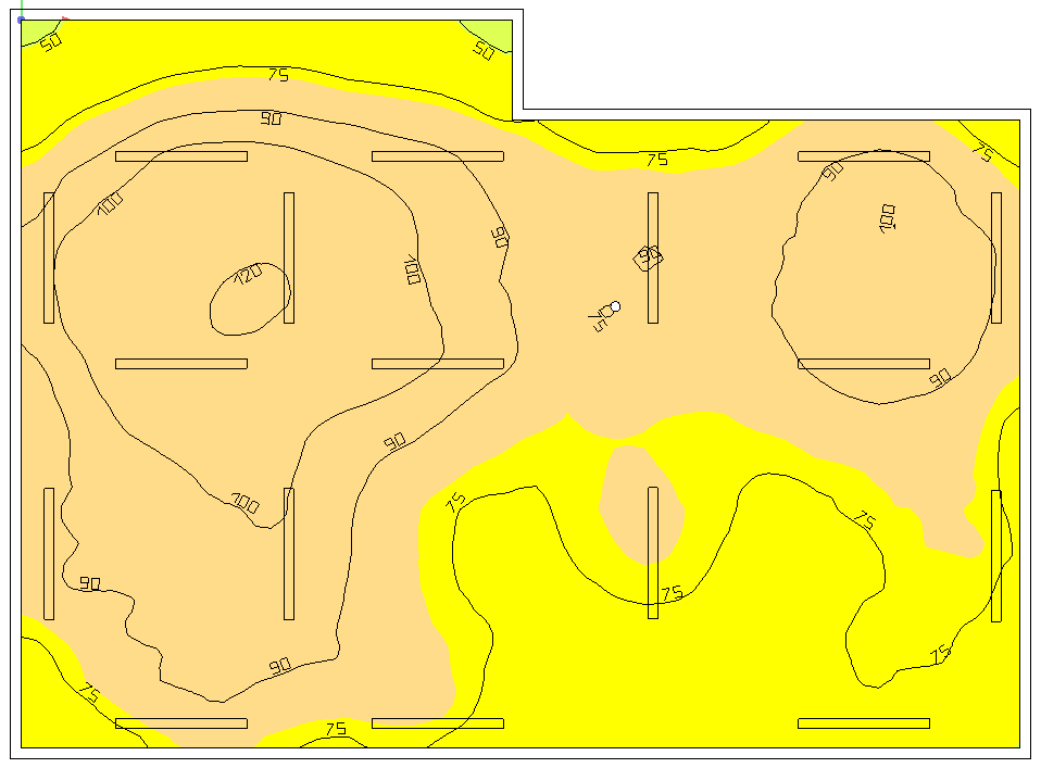

Small update on my little adventure.

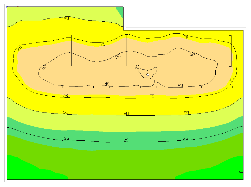

I downloaded and muddled my way through learning the DIALux software to do my basic garage layout. I know I'm not using it totally correctly, but I held pretty much all variables the same minus the layout just to see the differences. Since I decided on the MaxLite LSS2XT8USE4803 along with the 4ft, 4,000K GLL LED tubes, I could at least represent the light source pretty accurately.
My original thought was to use 17 fixtures and kind of halo each of my 3 vehicles. I realized this wouldn't be ideal when I started looking at where each of the 3 current fixtures I had was located (pretty much centered over each vehicle, but biased toward the front to avoid the garage doors when up), but I'm glad I laid it out just to see what it would actually look like:
Hmmm...not quite what I was going after for even lighting. I did many, many different layouts just adding an additional fixture to bring the total count to 18. That seemed to be a little better:
And what it would look like with the garage doors all open (I just simply removed the rear lights since they would not be on under these circumstances):

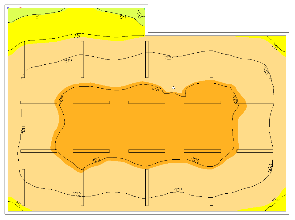

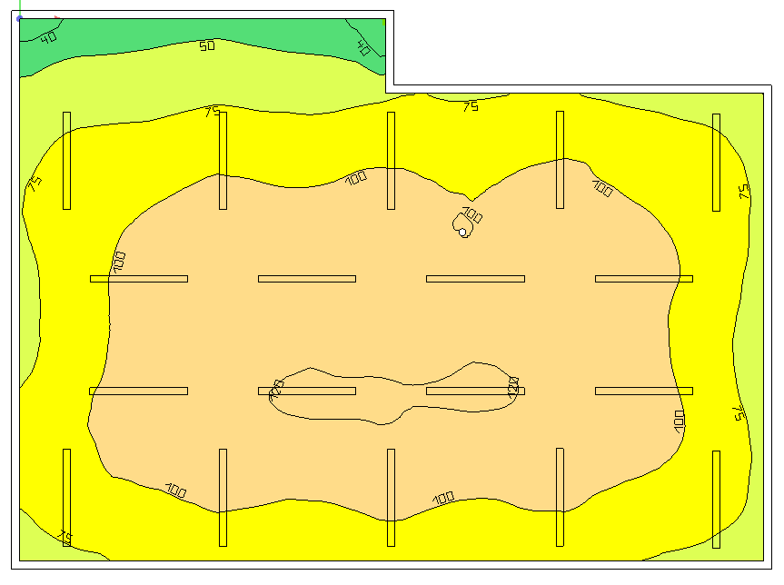

That was getting a little closer. I decided to add two additional fixtures to bring the total count up to 20. The layout seems a bit odd, but this actually works quite well when considering my attic access issues, as well as trying to throw some light under the hoods of my vehicles when they are up. Here's fully lit up:
That's pretty bright...maybe too bright. But what really intrigued me was when you started messing with different iterations:

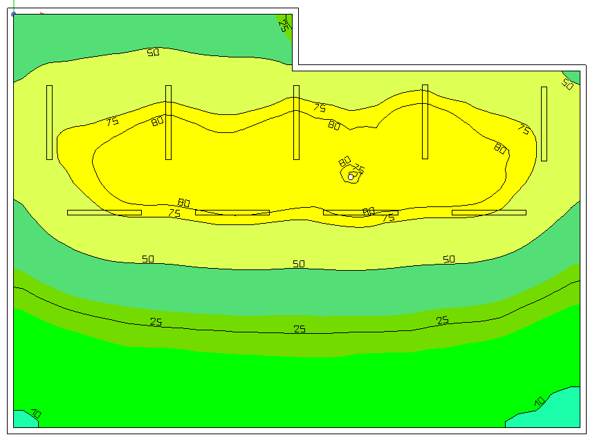

4th row off:
3rd row off:
3rd and 4th rows off (garage doors open):

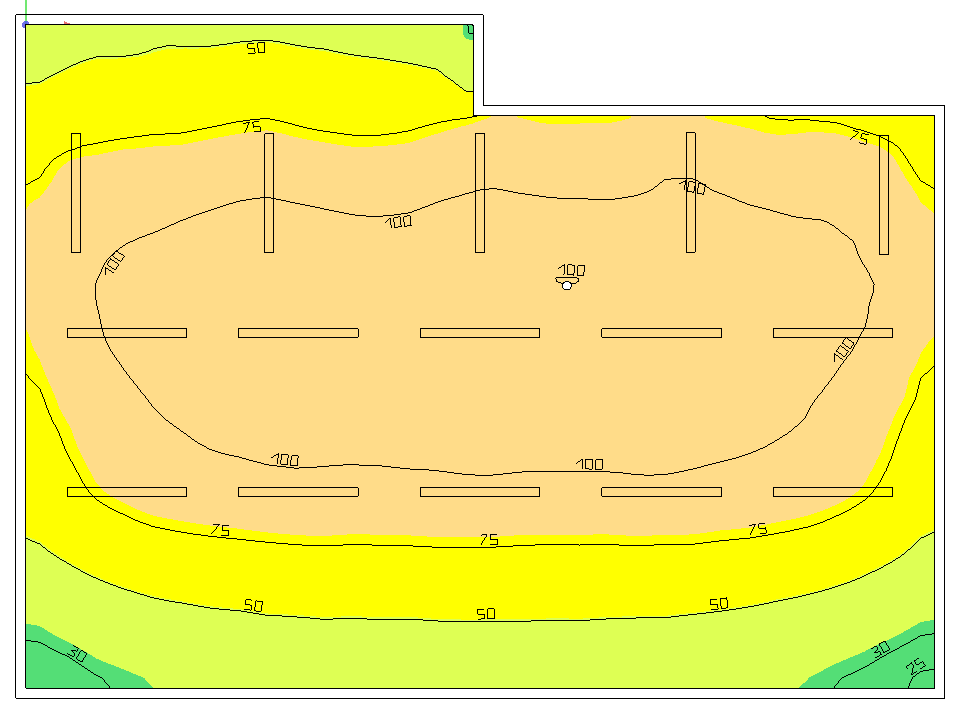

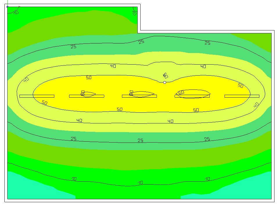

These seemed to be pretty useful, and would only require adding an additional switch. I was originally going to use 2 switches, and instead will be using 3 to control the extra lights. The last issue to tackle was figuring out how many I want on for my every day lighting. I was currently using 3 for general day-to-day lighting, so here's what that would look like:
Five seems a little better:

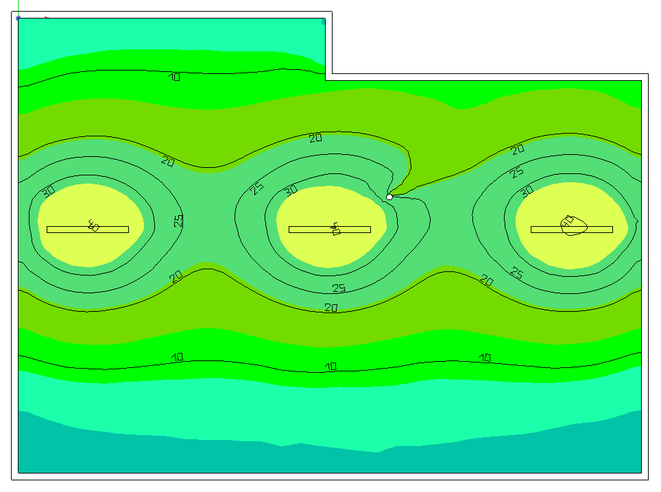

Since I already had 3 of the MaxLite fixtures on hand to try as a basic demo (which shipped very fast from ProLighting.com), I went ahead and installed them where they were laid out above with only 3 fixtures on. After many, many iterations, taking into account attic access and truss placement, I decided on placing them no closer than 12" from any wall. I bought a couple of tripod mountable laser levels to make my life a bit easier as well:
I ditched the plastic anchors that came with the lights and installed 3/16" x 2" toggles instead. They require 1/2" holes to put them through the ceiling drywall, which ends up giving you some nice wiggle room once installed to get everything exactly where you want/need it. As you can see from the pics, I left the T5 strips in place for the time being until I get around to taking them down.
I don't have any pictures of them lit up, but the results in the 3 lights on configuration above is pretty darn accurate for how the lighting looks. It's a decent amount of light, but I definitely have some shadows. It isn't hateful, and works for just general lighting, but I think I will go ahead and wire in the additional two lights in that row on the same switch so all 5 will come on for general lighting. That will be a pretty nice setup IMO...1 switch just inside the house for turning that 2nd row on for general lighting, and then 3 additional switches over by my work bench that will control the 1st, 3rd and 4th rows independently. That should give me good flexibility, and be fairly easy to install and wire.

Final Layout
I finally finished this project up last night...it took quite a bit longer than I originally anticipated, but that's par for the course with any project I do. Time will tell if it was worth it or not...I wanted a lot of light, and I got a lot of light, so it will be interesting to see how often I use these extra lights. This also ended up being a good exercise showing the difference between theory and reality. In theory, I would have spaced these lights perfectly evenly to get nice even light output all around my garage, but the reality of the situation forced me to make compromises due to how my house/garage was built.
I ended up with a slightly different configuration than I originally anticipated. I was going to run the first and last rows perpendicular to the middle two rows (see configs above), but after diving in to this project, I ended up realizing that one of the two ceiling mounted garage door opener outlets was closer to the rear wall than the other, which ended up pushing the 3rd row of lights further back than I wanted. Due to that, I decided to run the 4th row of 5 lights parallel, and only run the 1st row perpendicular to the rest. The only reason I had to do this was to be able to clear the garage attic pull down ladder...otherwise, I would have run them all parallel to each other.
I ran the final calculations in DIALux Evo, the results of which you can see below:
